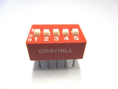

I also soldered in the dip switch instead of bridging across the pads with solder as they recommended. This allows me to change the duration once I get all that figured out. Then maybe I’ll de-solder the dip switch and solder across at a latter time. Also, I did NOT solder across S6. See last pic in the item.

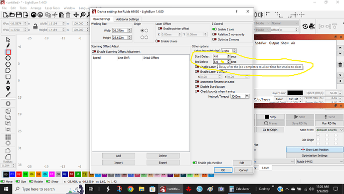

So I’m back to using the Status terminal but it sounds like I need to toss the delay solenoid and go with an SSR. I see there are settings in LightBurn for some delays. May have to utilize these instead.

I’m currently putting in the Solid State Relay and hoping that LightBurn’s Delay protocol will handle as desired.

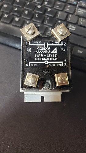

I’ll be using this SSR.
Thanks for both… probably didn’t see it because it’s not an option with the Ruida…

Well as luck would have it, the SSR I have in hand has failed “closed”!
Doesn’t matter if there’s a signal wire connected or not, the fan runs.
The only other one I have is a DC-DC which of course won’t suit the needs.

Found the same SSR staring at me, yelling in fact, just wanted to be put in service.
Connected it as per the instructions below and it works wonderfully! Cheers!
