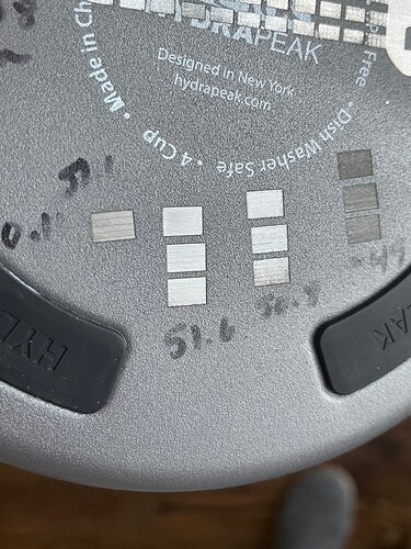

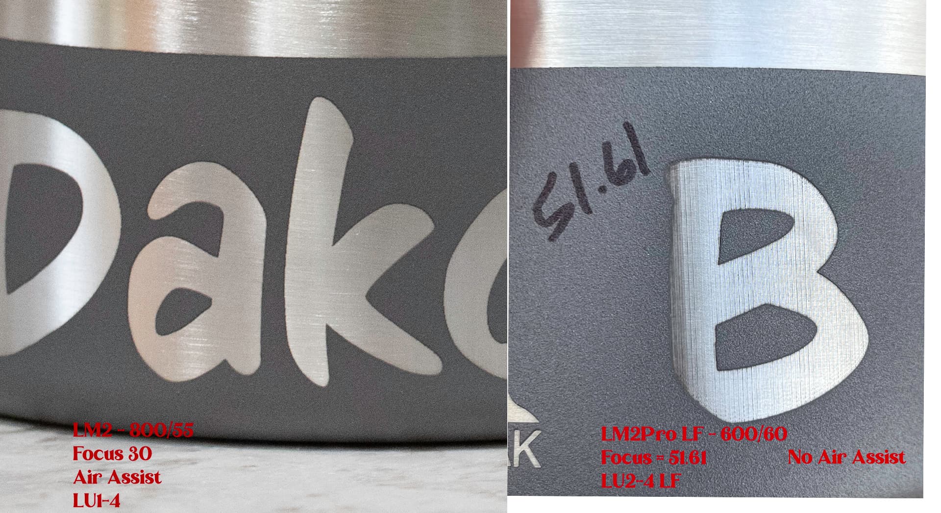

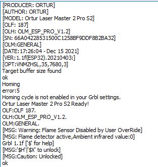

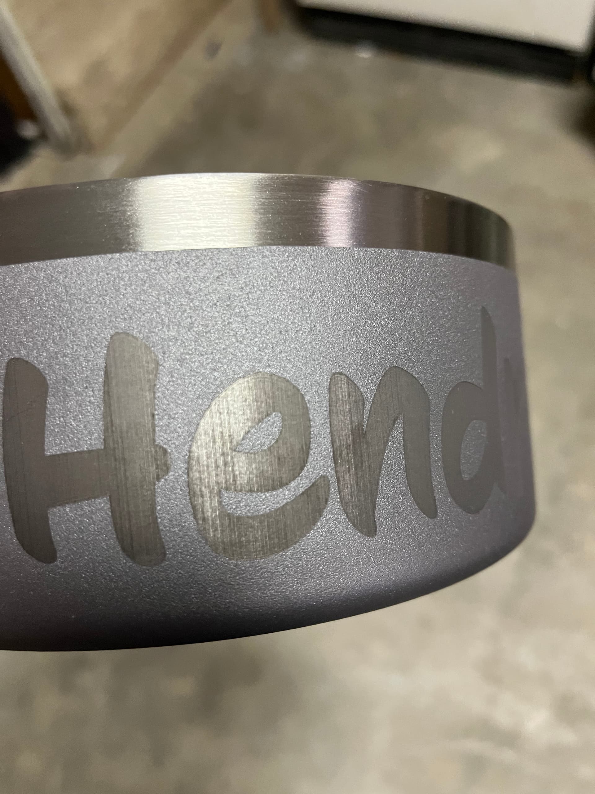

I’ve transition from the LM2 to the LM2Pro LF and I cannot get the Pro to cleanly burn a powder-coated tumbler. Support originally thought it was a focus issue. I have adjusted my focus by 1.6mm (51.6) and it is better. But as you can tell by the attached picture, there is still an issue. The latest discussion was a question as to whether or not I had changed the firmware’s $33 setting (frequency). He said it should be set to 1000. I have not (nor do I know how) changed any settings. In fact, I updated the firmware of the device after I received it in January and recently reinstalled Lightburn as I was afraid there could be settings in it associated with my LM2. I have changed the homing machine settings since I am using a rotary. I have also removed the air assist as there was a concern that it was not allowing me to focus properly.
Very open to advice. My LM2 burned these tumblers beautifully. I would expect the same with the Pro.

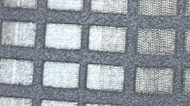

The issue is the it’s not a clean burn due to the lines and dots. In one of my attached pictures, you can see it doesn’t even burn consistently to the edges of the letter.

1 Comparison between LM2 and LM2Pro with the burn settings listed

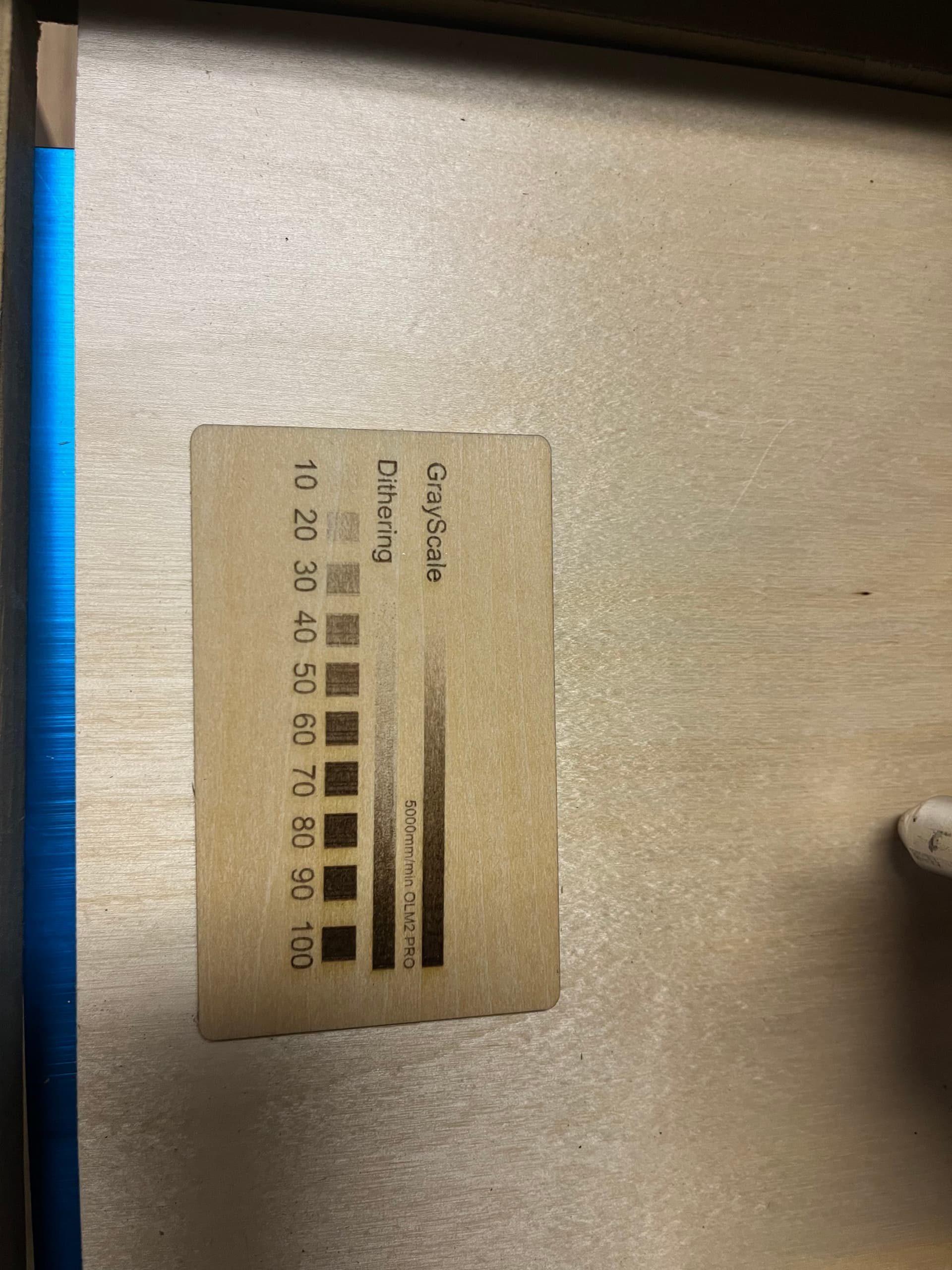

4 Burn test that Ortur had me run on wood which indicated to them the laser was firing correctly.

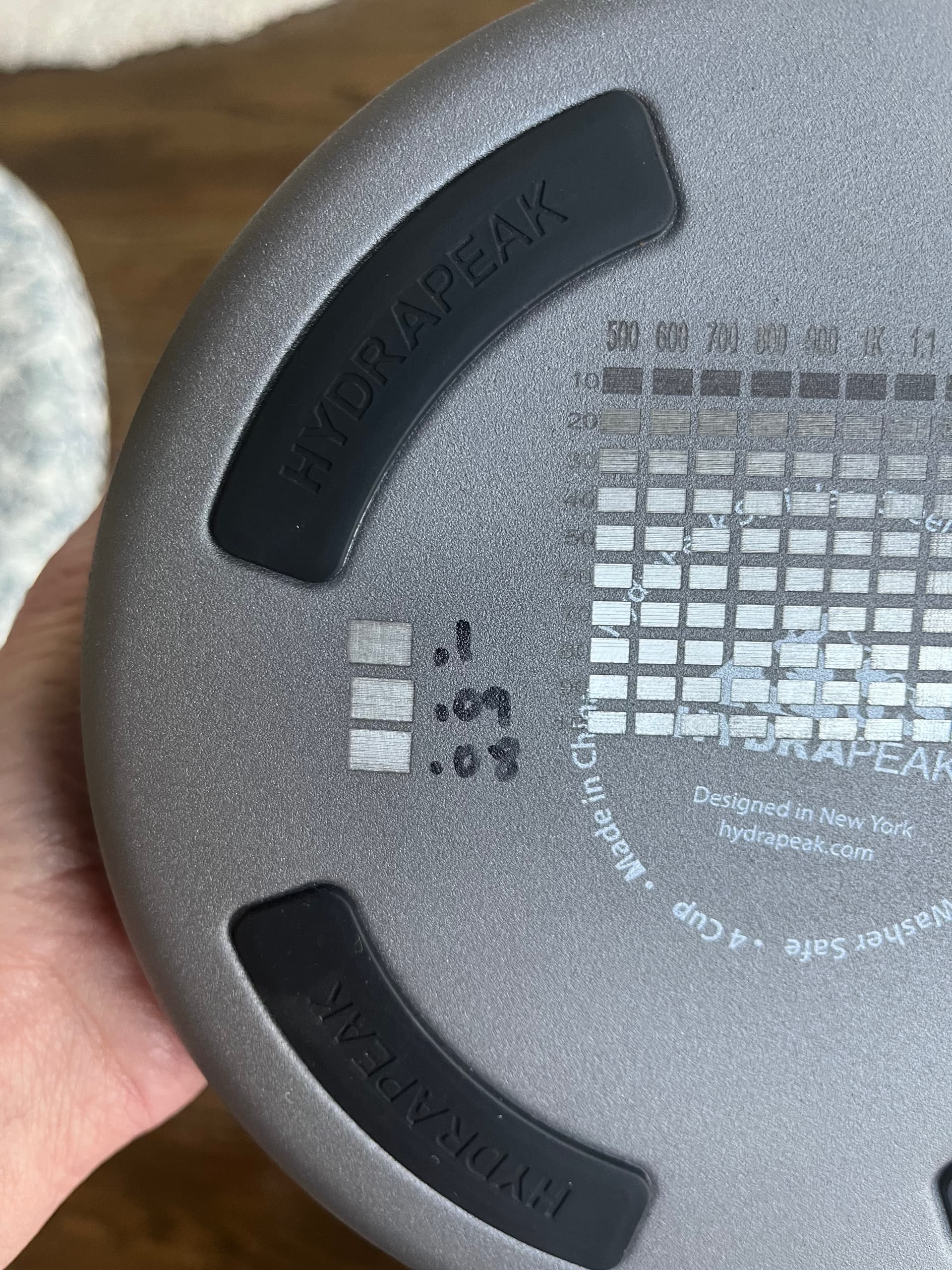

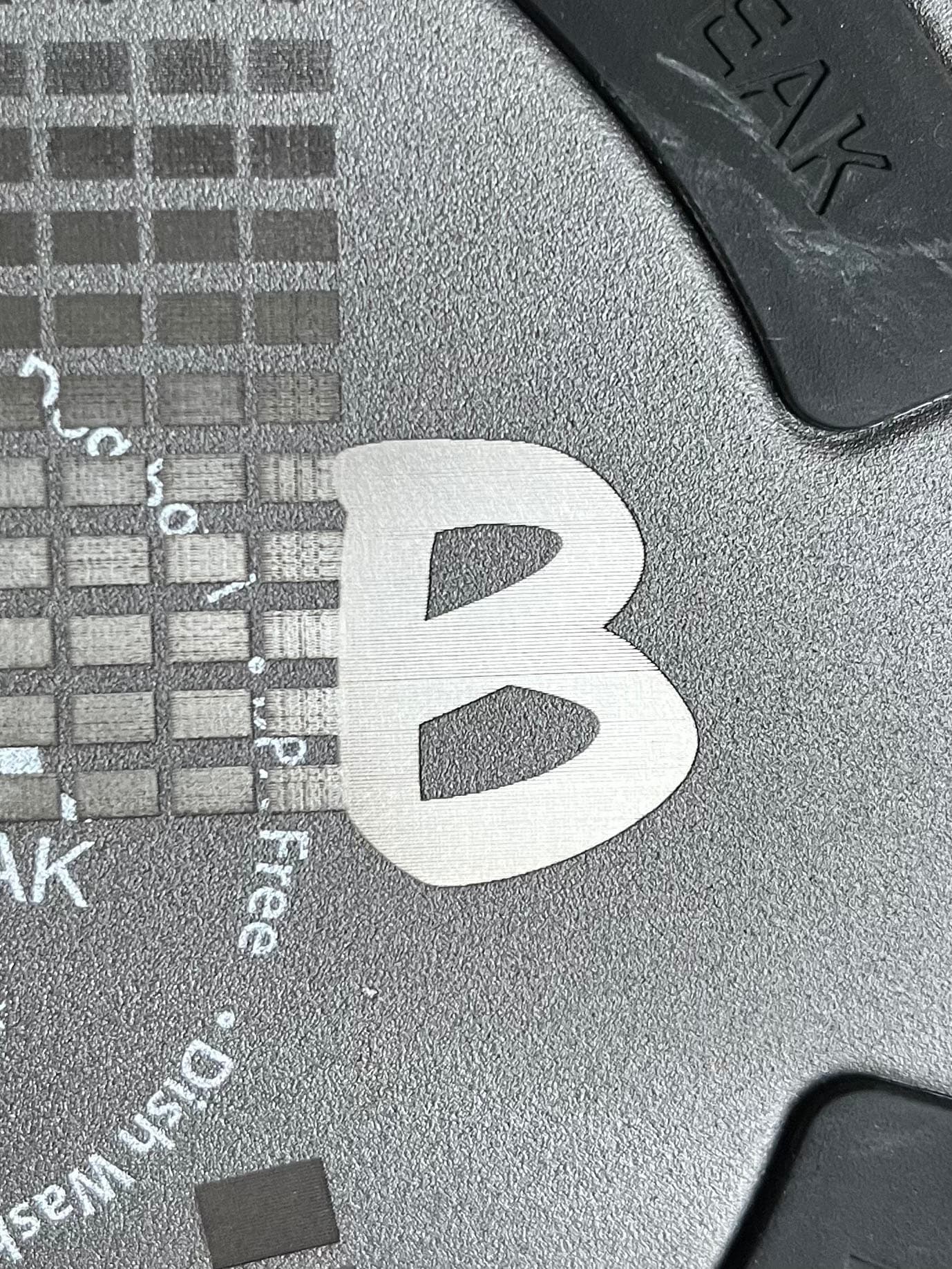

I have seen improvement in defocusing - greater focus rather than small focus. Best to date is 51.6mm rather than the 50mm default. The image with the “B” is with the 51.6.
Haven’t tried changing DPI - I will! Curious as to why it have different results between the two.
3 Wood cuts well, engraves OK. I see the same lines, but it’s not near as noticeable as it is in the powder coated materials.
LM2 - default 30mm focus measured from bottom of lens to the material surface
LM2Pro - default 50mm (although I have been adjusting this) from the bottom of the module
Don’t see how that would make sense but maybe they’re referring to the modules being sufficiently different.
I assume the biggest difference is going to be in the focus dot shape+size and realized power based on that. It’s possible that the LU2 is being driven harder as well but not certain about that. It’s possible that you would have better luck with the SF lens but I feel like you should be able to get similar results defocusing + DPI changes. You might want to try getting closer than the focal length as well.
I agree. I can’t wrap my mind around that unless it requires different voltage settings from the motherboard to drive the power levels.
I’m about done with this laser. Last tests.
Removed the rotary to eliminate one variable - everything done on a flat surface. Tests run with different line intervals/dpi settings and focal settings. Best results are focus of 51.6mm with 254dpi/0.1 line interval. Still not to the quality I’m use to or provide to a customer. (The picture with the letter B is with that setting).
