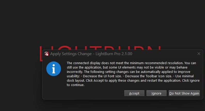

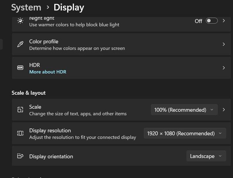

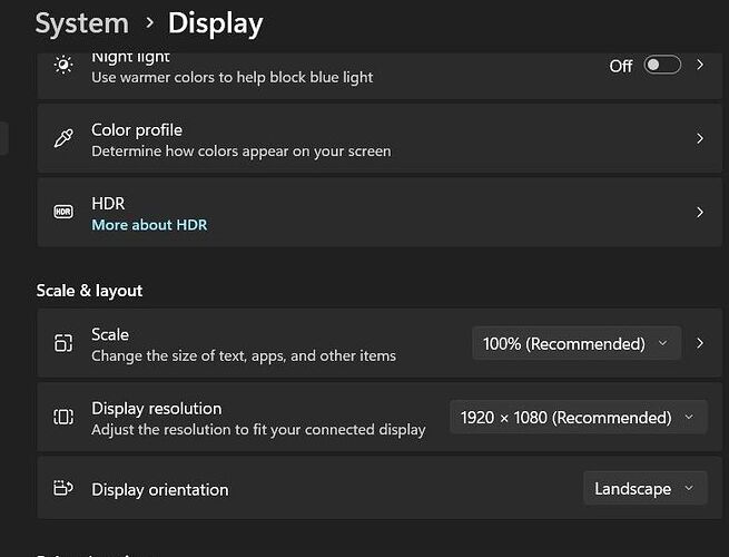

I had no issues with the RC but this release does have issues. All my cut settings are changed and the display resolution is wonky. It can be changed of course in the program but this message still pops up each time. If you click accept the resulting UI fonts are super tiny! Click accept and the changes I made to adjust are displayed.
