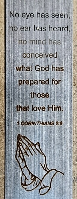

Here is a pic of the issue I was having.
(Sorry for the lousy pic. It was the best I could come up with.)
As you can see, the upper letters etched in less than the lower ones.

How do you focus this? It has the typical look of on it’s edge focusing. Top is light, but as it goes down it’s actually like the beam is getting larger (unfocused)?

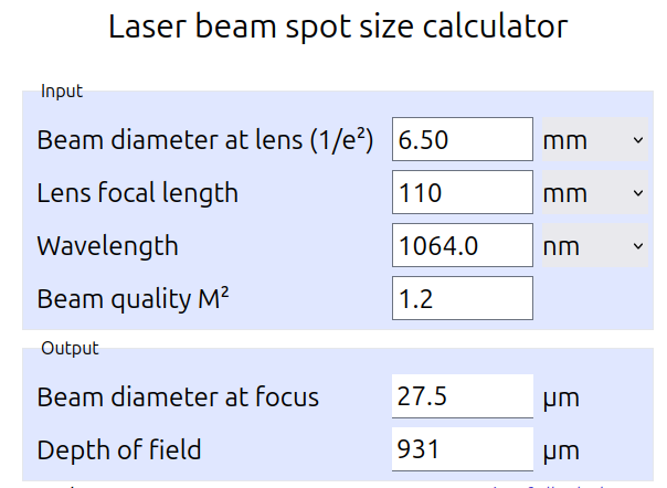

Using this on-line calculator for spot size, the size will vary, but I got these values from memory from my manual, so they aren’t double checked against it.
Dof is 931 microns or less than 1mm to stay in focus. A mm is 1/25th of an inch, you have less than that range in focus.
I’d start by ensuring ensuring the head is perpendicular to the table.
Does this make sense?
