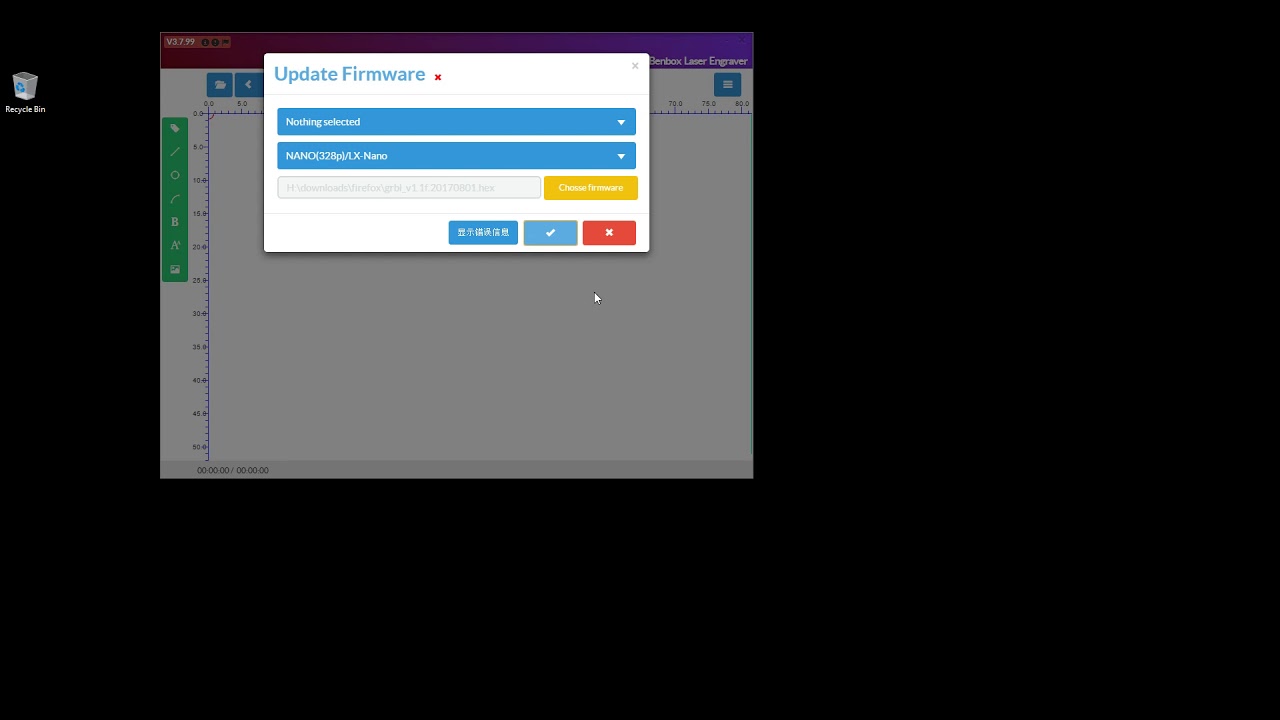

I know this probably sounds like a very dumb question, but how do I “re-flash” it with grbl 1.1?

I have reflashed as the video showed me how to do. Now when I come back to lightburn… NOTHING happens. It wont move or anything. I am at my wits end here.
At least before it would move to the corner and then I would have to pull it back out by hand but now it wont move at all. I have re installed the lightburn software and same issue.
