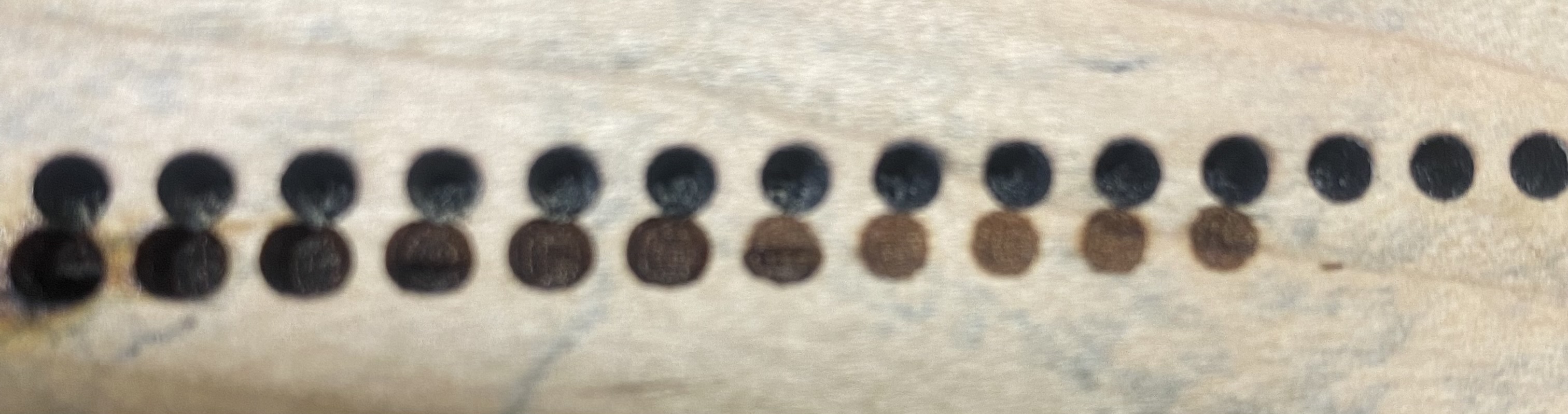

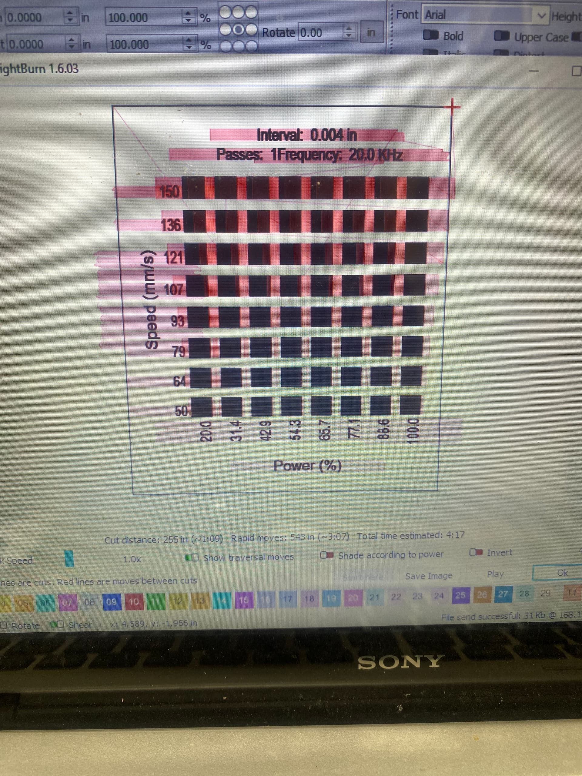

Upgraded Laser tube and Power supply. Material test did not go well. Do I need to update any settings in light burn?
I upgraded my Blue/Grey 50W Chinese laser (Ruida) to 70w tube and 80w power supply. Its more powerful for sure, but I am having trouble with clean fill cuts, I did a material test and it burned out the sides of test holes. I use the machine to cut 3mm holes often, so the squares I set to 3mm. As you can see in the picture it burned outside the sides of the fill area. Any suggestions on what I need to change? Thanks.
Also, where it was supposed to cut text it just did garbles lines.

Thank you everyone for the replies. @ednisley and @jkwilborn I use the term fill cut as I am cutting holes with the fill setting to cut (drill) holes for cribbage boards. With my old 50w (if it was even that) I could get nice clean holes. with my new setup it cuts deep, but the holes are oblong, unless super low power, as in the picture.
I know its a bit blurry, but the top row was with the old setup nice round holes, the bottom playing with different power settings, higher power larger oval, low power circle.

I am wondering if its something to do with acceleration or overscan.
Also here is what was supposed to be cut in the first picture.

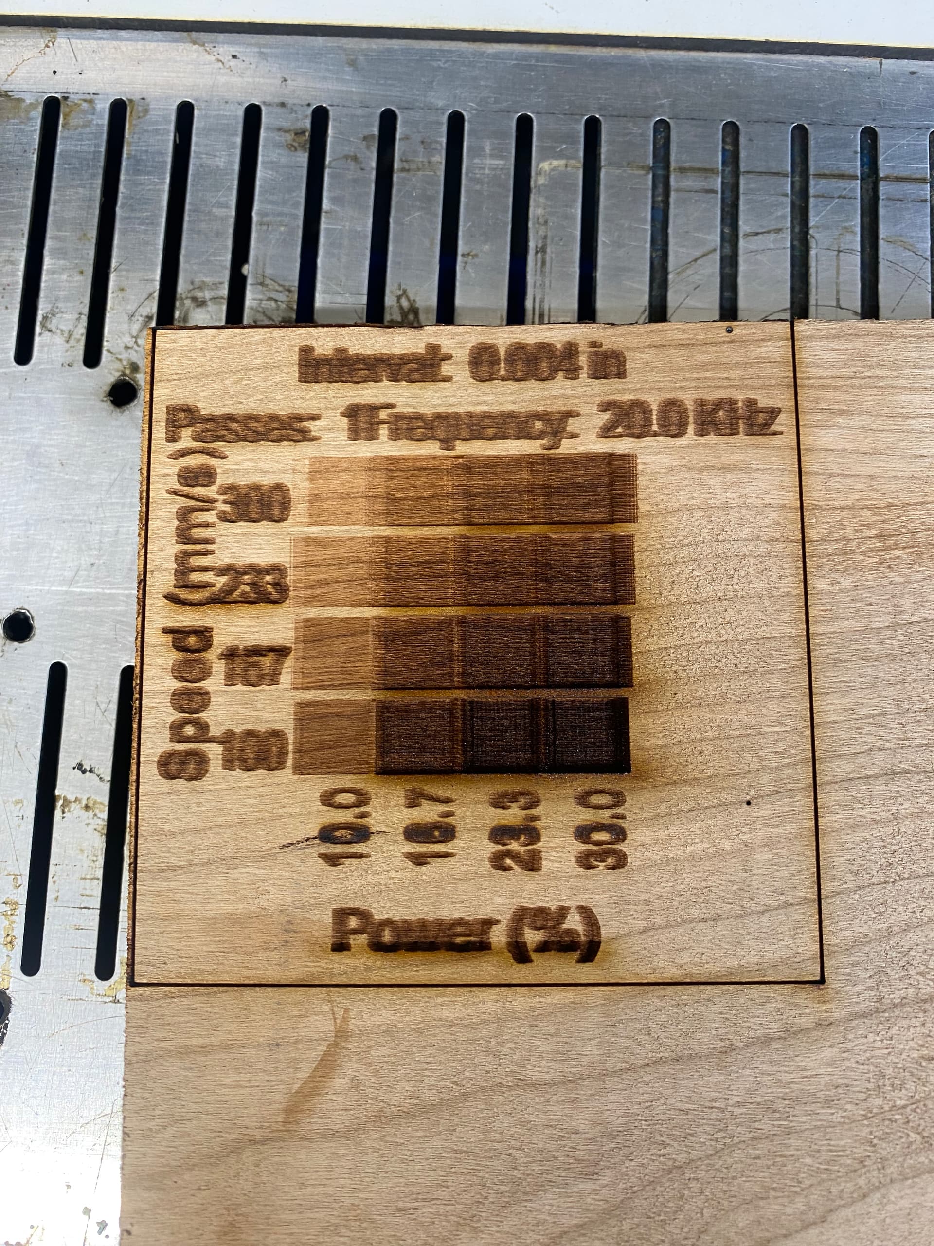

Given that you have a much higher power tube, the speeds seem very low and the power very high for any type of engraving.
Run that again with powers from 10% to 30% and speeds from 100 to 400 mm/s. If those results look better, then you can fine-tune for digging holes.

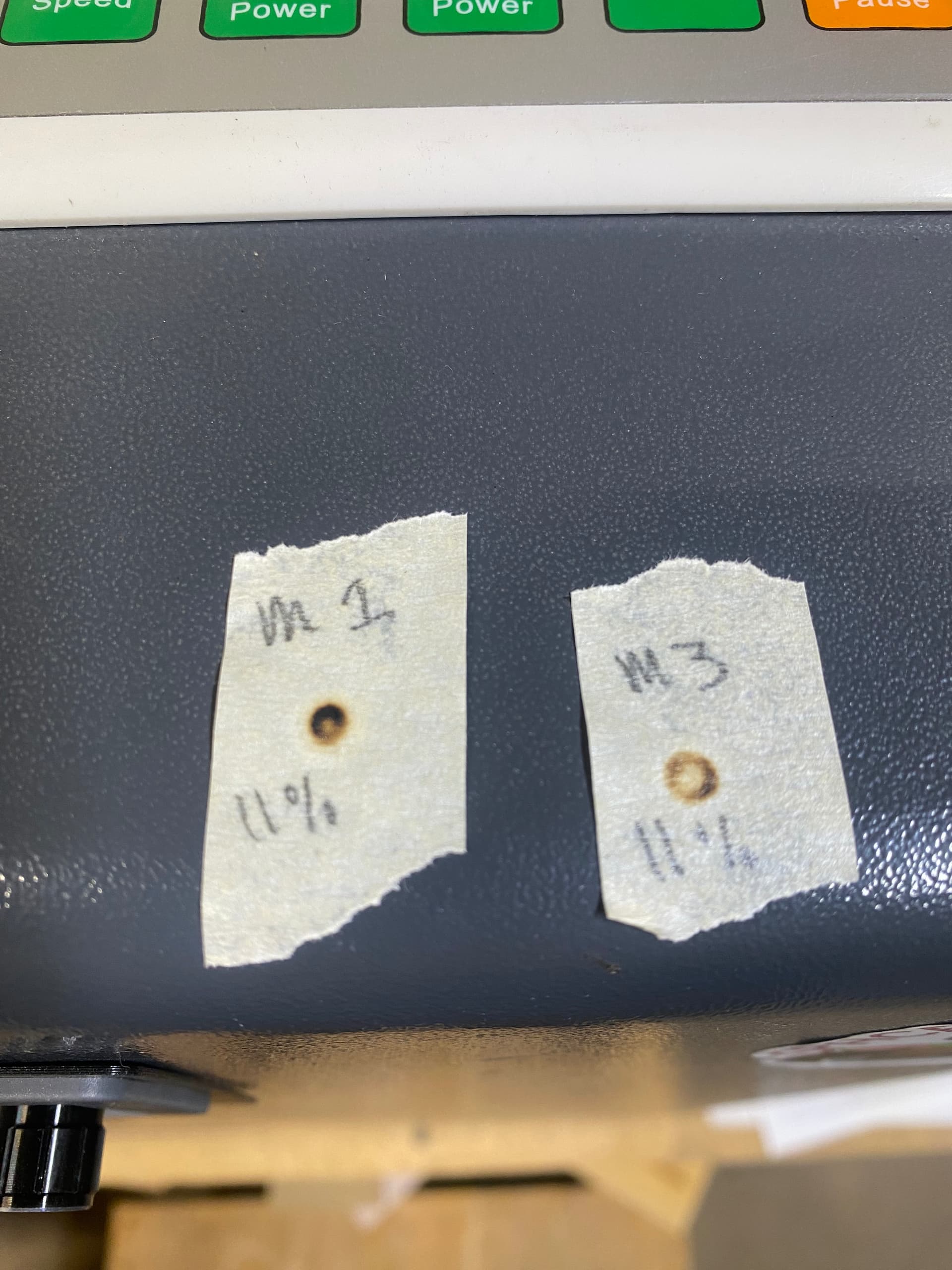

Nightmare scenario: what does the scorch look like at the entrance to Mirror 1? If it’s not a nice round / even / pleasant spot, then you may have gotten a bad tube.
Thanks, I will try lower speed higher settings. I will double check mirror 1, at mirror 2 its a nice doughnut.
If this is the case, your tube is shot and needs to be replaced … sorry.
Left test is at mirror 1 - 11% power for 2 second pulse. Right is mirror 3 - 11% power 2 second pulse.

As @jkwilborn points out, that tube is defective.

The whole point of a laser is to produce a coherent beam of light with a good energy profile across its diameter, so the focus lens can concentrate that energy into a very small spot.
The rings scorched into the tape targets show the energy does not have the right profile, so the lens can’t turn it into a spot. What, exactly, the lens can do with a beam shaped like a ring could be calculated / simulated / whatever, but the energy definitely won’t become the very small spot required to work properly.

The mfg had me pulse the laser for 5 soconds at the end of the tube with some clear acrylic, it burned a conical shape with the center being deeper cut. So they said the tube is good.

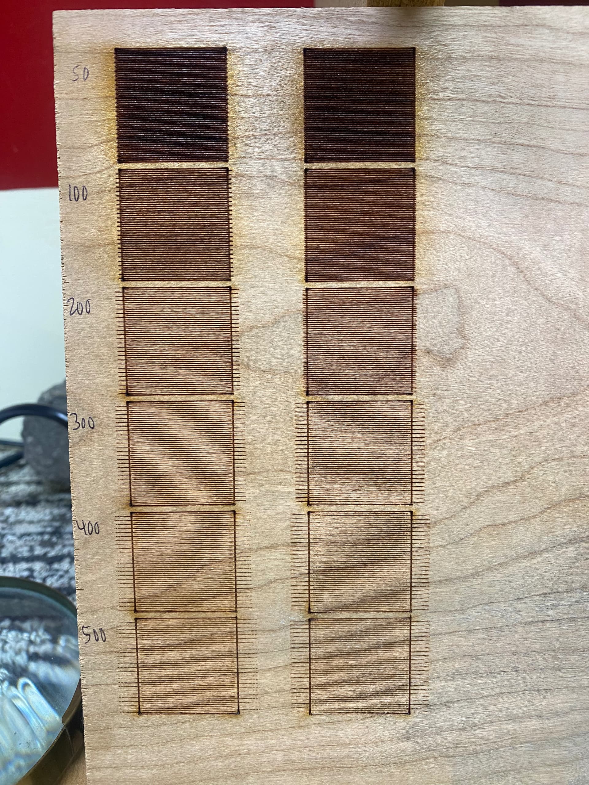

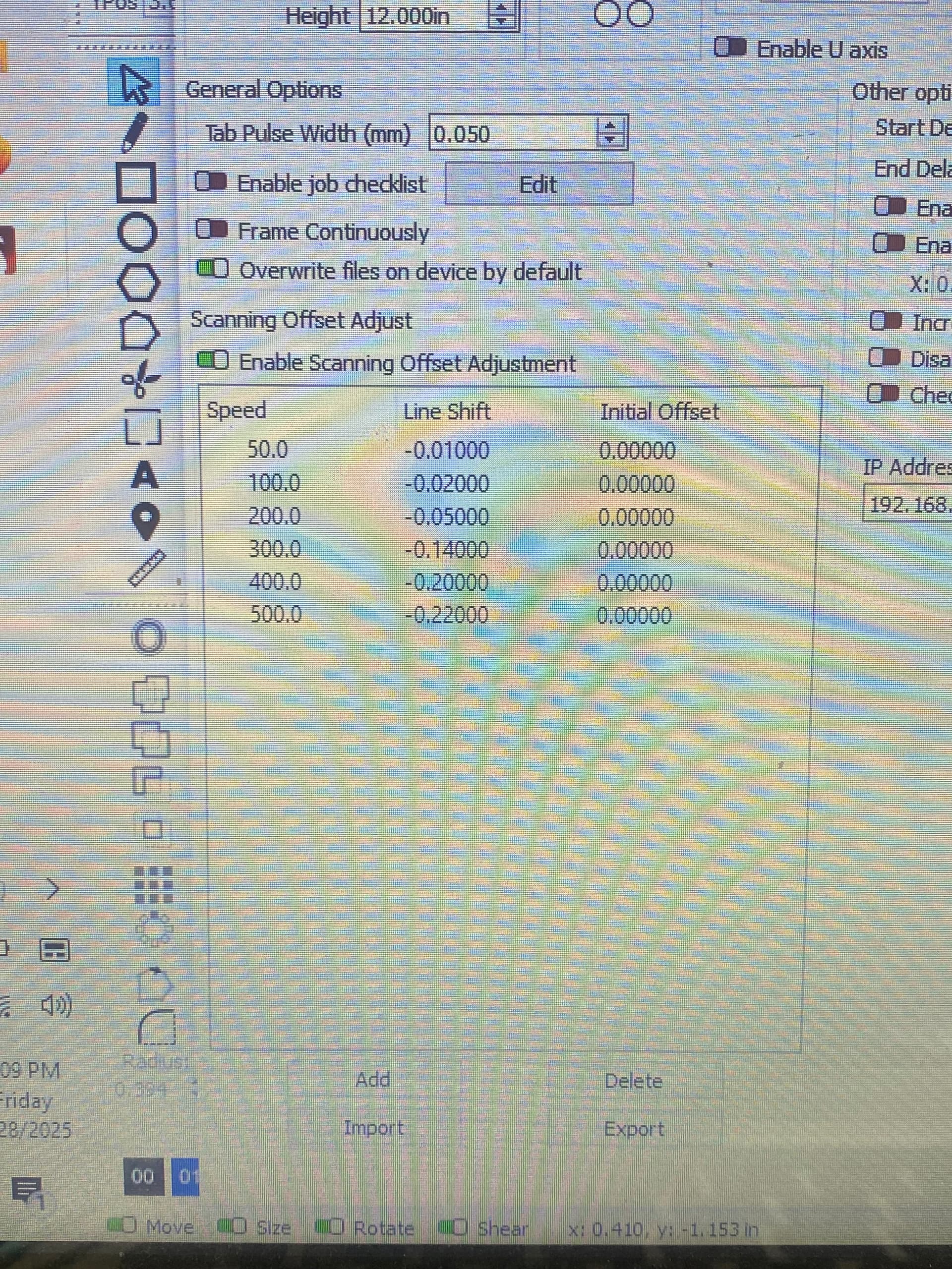

That’s what the Scanning Offset Adjustment is for. The value you enter into the offset table is half the distance between the line ends; a measuring magnifier makes those measurements trivially easy.

Your test scorches show the tube is not resonating correctly, but convincing them of that may be impossible.

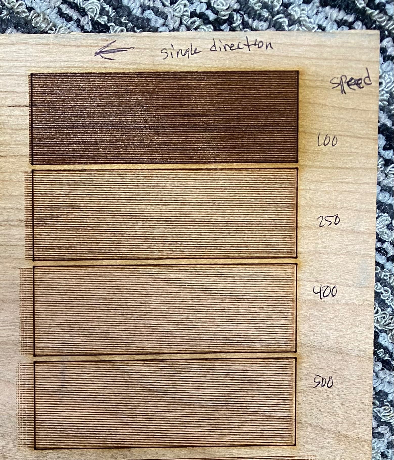

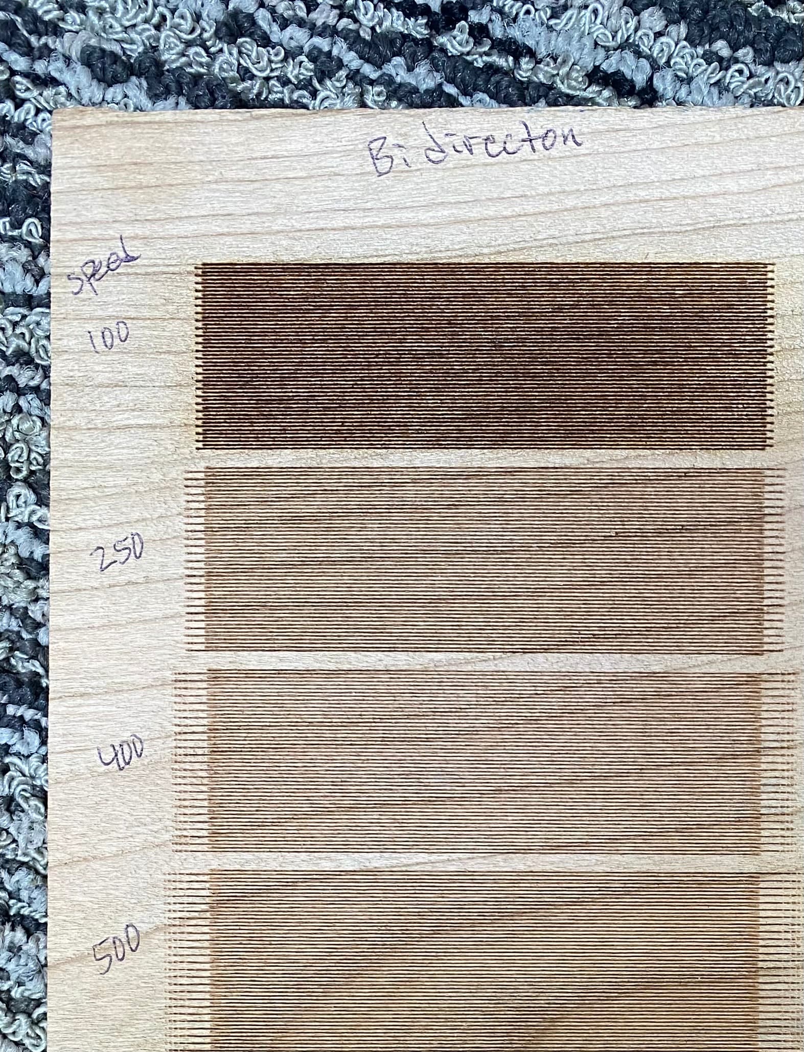

I changed the scanning offset values, with no change to the primary problem. For fun I reversed the values and saw a change (made it much worse).

Measure the raw offsets with the adjustment disabled at 50, 100, 200, 300, 400, and 500 mm/s, put half the measured values into the table, enable the adjustment, and run the same tests again. Upload pix of the results along with a screenshot of the table so we can look over your shoulder.

I’d be surprised if any tube failed their test, because the shape of that pit depends more on the dynamics of vaporizing acrylic than fine details of the beam shape. But my surprise absolutely does not matter if that’s the result they want … :frowning:
Here is the offset test. Left row offset disabled, right row enabled with the settings in the second picture.
