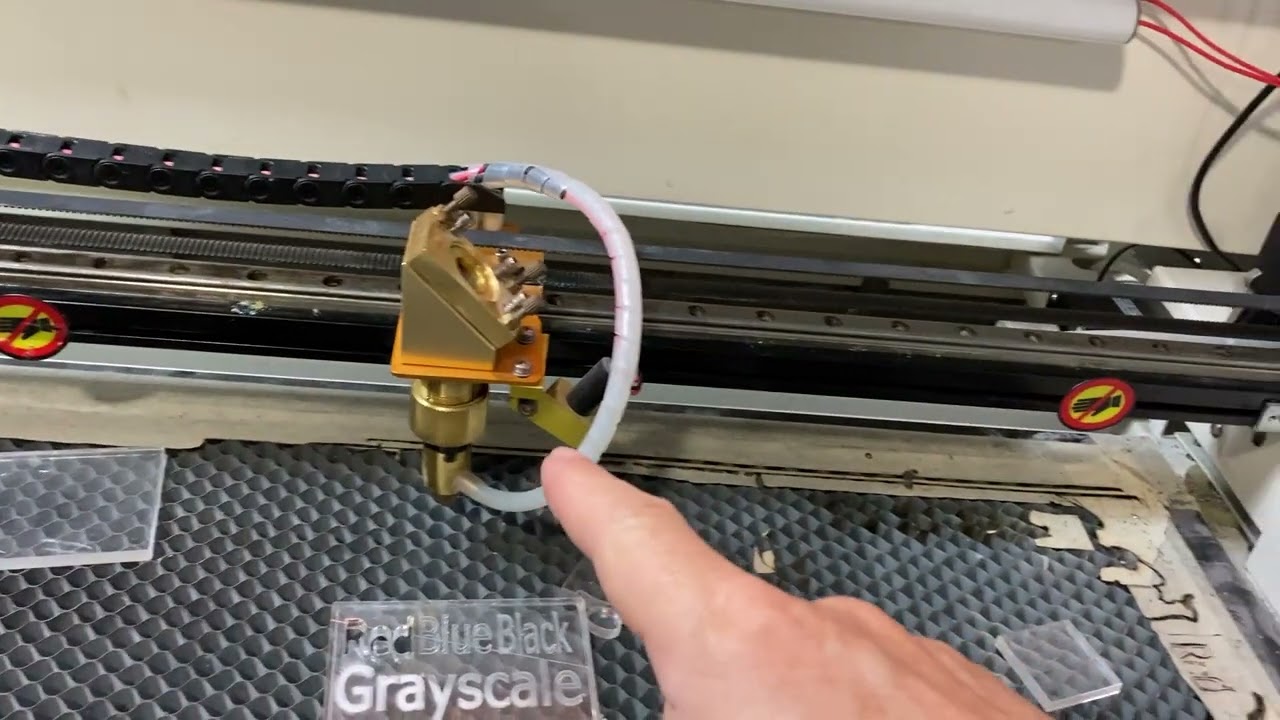

Hi there again. I’ve gotten the new motors installed but they’re behaving identically to the old ones. :frowning:
I guess that means it’s settings related. I’ve not used your file yet. Wanted to try it as is first.
I made a quick video of the issues I’m having.
  1. It jumps immediately after homing. Like it wants to slam into the limits. Any idea why it would do this?
  2. It doesn’t set x and y to zero after homing. Isn’t it supposed to?
  3. x0 and y0 are out towards the middle. How do I set home to be x0 and y0? e.g. zero all?
  4. It seems to move really fast and not in the 10mm increments I thought it is supposed to be moving. Any idea how to adjust this?
Thanks for any advice you can give.
