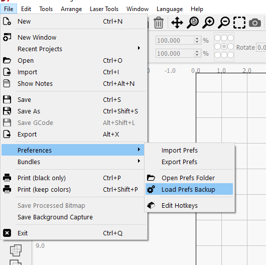

Hi everyone, Ok just like to say i have use the ortour master pro 3 10 wt for about 18 months , a few problems now and again. Everytime i use the Rotary, problems arise. I have desided that i will not use it again .
The problem this time is i followed the set up and use on utube. As again a nightmare so . Now the settings with not return to normal settings, Will not home or frame. Will laser but the image is upside down .Also i upgraded a while back . it keeps asking me to upgrade to what im already useing.Now i can’t use the machine until this is solved.
Will be greatfull of any advise… thankyou
Maybe try Load Prefs Backup, go to a date where things worked.
Hope this helps, and works for you.

When not using rotary, confirm that it’s not enabled from the rotary setup window. Are you receiving any errors in your console window when attempting to home or frame?
If you want LightBurn to stop asking about updates, go to settings>file settings and disable ‘automatically check for updates’.
