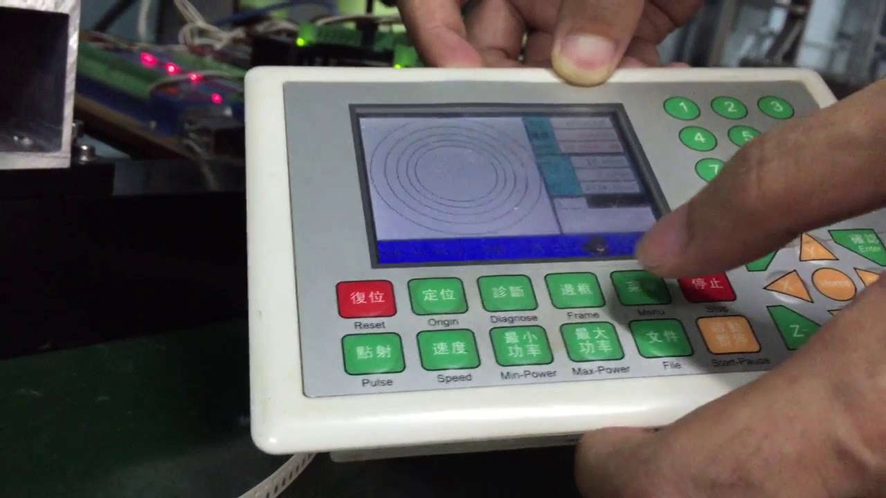

If I understand, you are asking about support for “live-focus” controllers like this:
LightBurn does not currently provide any “live-focus” specific features, no. Which controller do you have?
Thanks Rick. That’s pretty cool, but not what I had in mind. I can I think, in fusion 360, use the “project” tool to project a line drawing from a .svg file onto a 3D surface (.stl file) to then create a 3D tool path that traces the line drawing. Basically, I want to do the same thing, but with a laser instead of a router bit. For instance, if I wanted to engrave a line (with a router bit) at a fixed depth across a topographic map using a CNC router I could do so with this feature. Lightburn would have to be able to read a 3D path to make this work.
