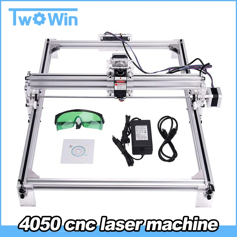

I’ve got a laser cutter here :

I have a laser nearly identical. I changed to the Keyestudio CNC Grbl .9 board and installed Grbl 1.1 on it. I had a few settings to change. If you do go the Grbl 1.1 route, I may be able to help configure it.
Also, you will benefit from the use of limit switches for homing.
