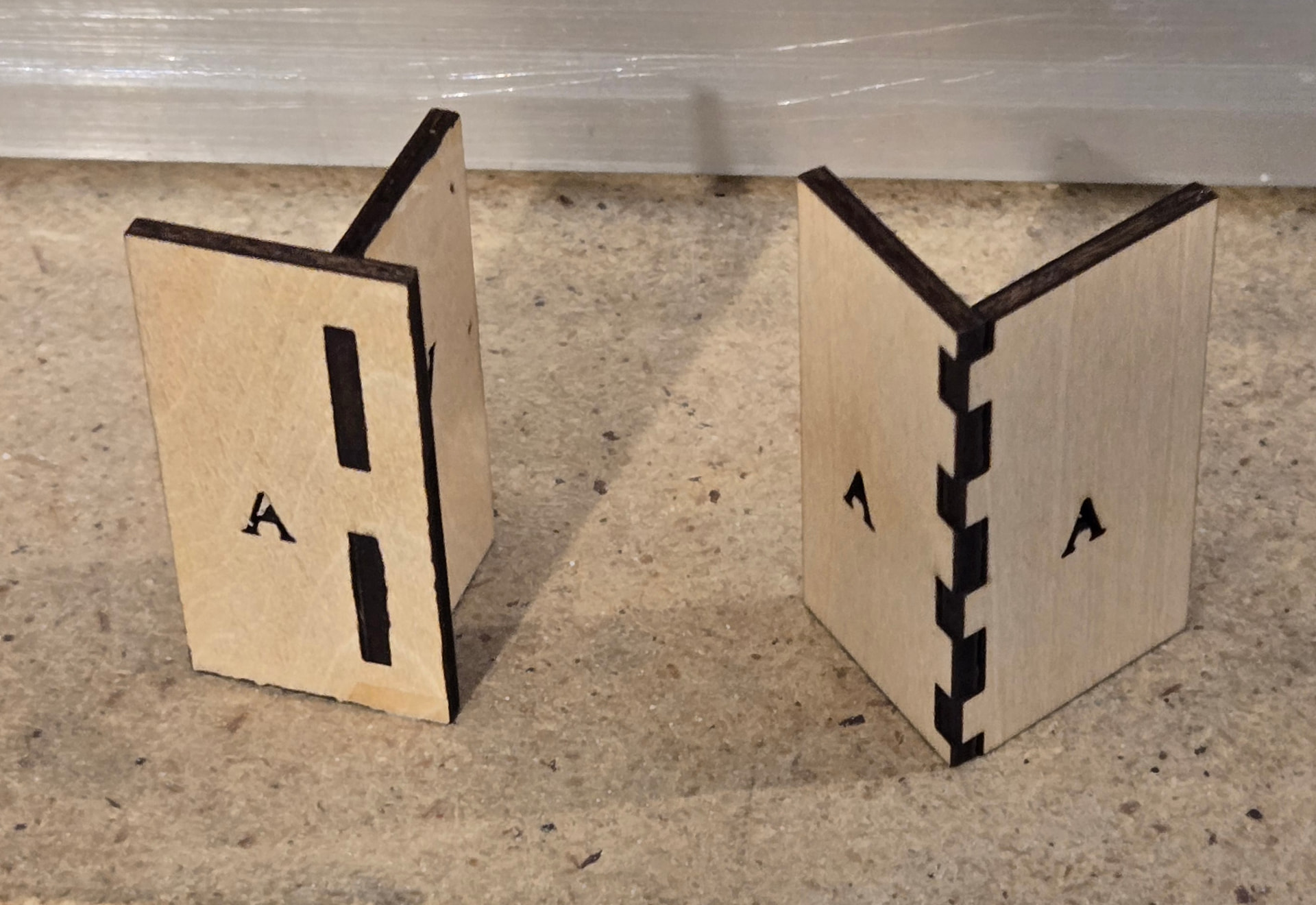

My kerf tallies out to be 0.063. This is good for a nice fit for 3mm plywood.
I also understand for other material this could vary and further testing is advised.

All I know is the 0.063 as the offset works for a snug fit for Slots and Tabs.
That is the spec for my 10w diode. I am betting the 5w (4.5w) is even better.
Very pleased with the outcome of my Kerf Offset adventure.

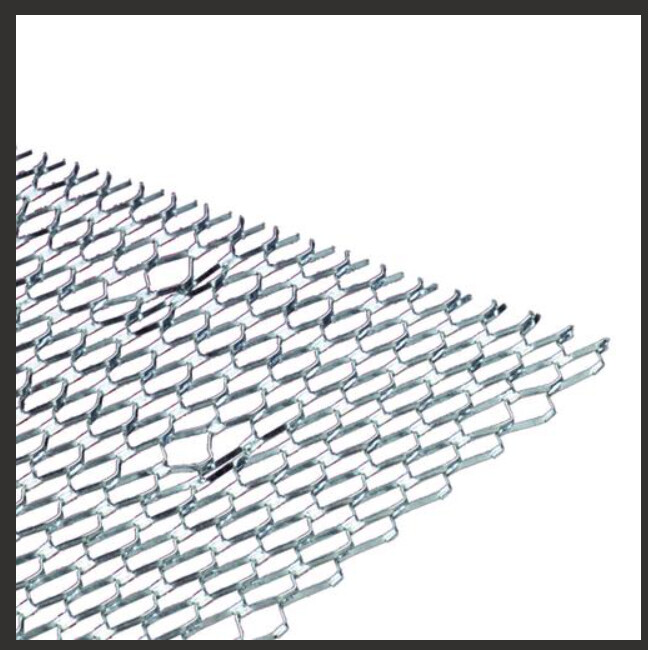

What I use is 27" x 96"-97" Dimpled Self-Furring Galvanized Steel Lath from Menards
full sheet $16.97. I still have small pieces fall through but can usually pick them out.
Used metal shears to cut to size.
And then, do you slip something really thin to collect the cut-out pieces? Or do you do the vernier measurements directly on the machine? (The honeycomb came with my machine, but I use that kind of metal grid on my airbrush booth.)
I use my fingers. Sometimes I have lifted the Furring and brush pieces out. Sometimes tweezers.
