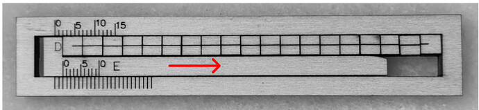

I am going to be the Sacrificial Lamb here. What are you talking about? Maybe an image will help…
The kerf tool in the documentation.
Per the instructions, that’s 2 with 5 as the first decimal place, then divide by 40:
0.063 = 2.5/40

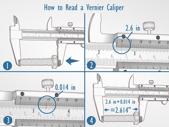

Got it. You do not do any rounding. You read it sort of like a slide rule (before calculators).

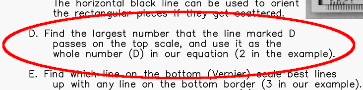

From Lightburn Docs…
  1. Find the largest number that the line marked D passes on the top scale, and use it as the whole number (D) in our equation (2 in the example).
  2. Find which line on the bottom (Vernier) scale best lines up with any line on the bottom border (3 in our example). This will give us the decimal place (E) in our equation.

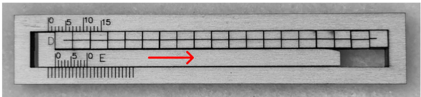

In your image, it is reading 2.0. Say you slid it over 2/3 of the way past the 2.0 position. Then it would still be 2.0 plus the reading on the bottom scale, which would be 1 mark past the “5”. The final reading would be in this case 2.6 indicated, but the KERF is 1\2 of that, or 1.3mm.
That said, I have no idea why the 2.6 would be divided by “40” like it shows in the Docs. The file provided in the Docs may be different than the one that was circulating in some postings.

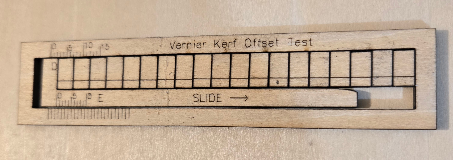

Here is a photo of my actual test tool reading.
Top reading between 2 and 3. (Angle shows closer to 2 but is in between the two.)
Bottom reading is dead on 5.

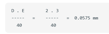

In the Lightburn documentation it shows the following equation.
This is where 40 comes from.

No, that is where it is used. I am asking why 40 instead of 20 or Pi?
The line of little rectangles has 20 abutting cuts, so it’s short by 20 kerfs: 1 kerf = 20 missing kerfs divided by 20.
The kerf offset is half the kerf width: divide 1 kerf by two.
So the overall divisor is 40 = 2 Ă— 20.

Here is the copy direct from the doc.
Instructions¶
  1. Set up the Cut (red) and Score (black) layers with your usual settings, and ensure the Kerf Offset is set to 0 mm (off) in the Cut Settings Editor. Position and run the Vernier Kerf Offset Test on your machine as normal.
  2. Remove all pieces from the machine (a piece of painter’s tape can assist), and remove the piece marked DISCARD.
  3. Slide all loose bits to the right →. The horizontal black line can be used to orient the rectangular pieces if they get scattered. Annotaed image of the L-Shaped piece slding right
  4. Find the largest number that the line marked D passes on the top scale, and use it as the whole number (D) in our equation (2 in the example).
  5. Find which line on the bottom (Vernier) scale best lines up with any line on the bottom border (3 in our example). This will give us the decimal place (E) in our equation. Annotated image demonstrating how to find D and E
  6. Fill in the equation, calculate it, and use the result as your Kerf Offset in the Cut Settings Editor.
    D . E        2 . 3
    -----   =    -----   =  0.0575 mm
      40           40
    Entering the value into the Cuts and Layers Window
  7. Optional: You may then use the box joints included to test your new Kerf Offset.
Once you have found your Kerf Offset, it’s a good idea to save the settings to your Material Library, and the test itself to the Art Library, for future use.
No 20 mentioned?
You want to know how much material a cut removes, this is the kerf.
This makes 20 cuts, to get the average cut (kerf), you divide the total of 20 to get the average kerf. If this made 10 cuts, you would divide by 10, not 20…
Then divide the kerf you get by two. 1/2 of the kerf is on one side the other 1/2 kerf is on the other.
That should get you close to what is actually needed. I always cut a notch/slot that’s only one or two. Then I can see if it will fit like I want.
Basic math… multiplication/division rule it doesn’t matter where it is… 2 x 20 = 40, so using 40, you don’t have to divide by two. I think @ednisley was pretty clear on that…
2 . 3
__
2 x 20
Is the same as
2 . 3
__
40

OK, first I want to thank everyone trying to help in this area of my personal confusion.
on the tool created for my laser, the top number is not on 2 or 3, it is in the middle between the two.
do I use the 2 or the 3 for my calculation or does it not matter?
Per the instructions:
As you slid the scale to the right, the largest number passed by Line D on your scale was 2, which is why we’ve all been using 2 in our explanations.
It works like a caliper.
Looks like you’re reading it correctly, but something is wrong with the results. If your spot size is 0.20mm, then your kerf will likely be larger.
Can’t say I’ve ever seen one with the same value, or lower, as the tool diameter. They usually take out at more, as there needs to be enough for clearance.
