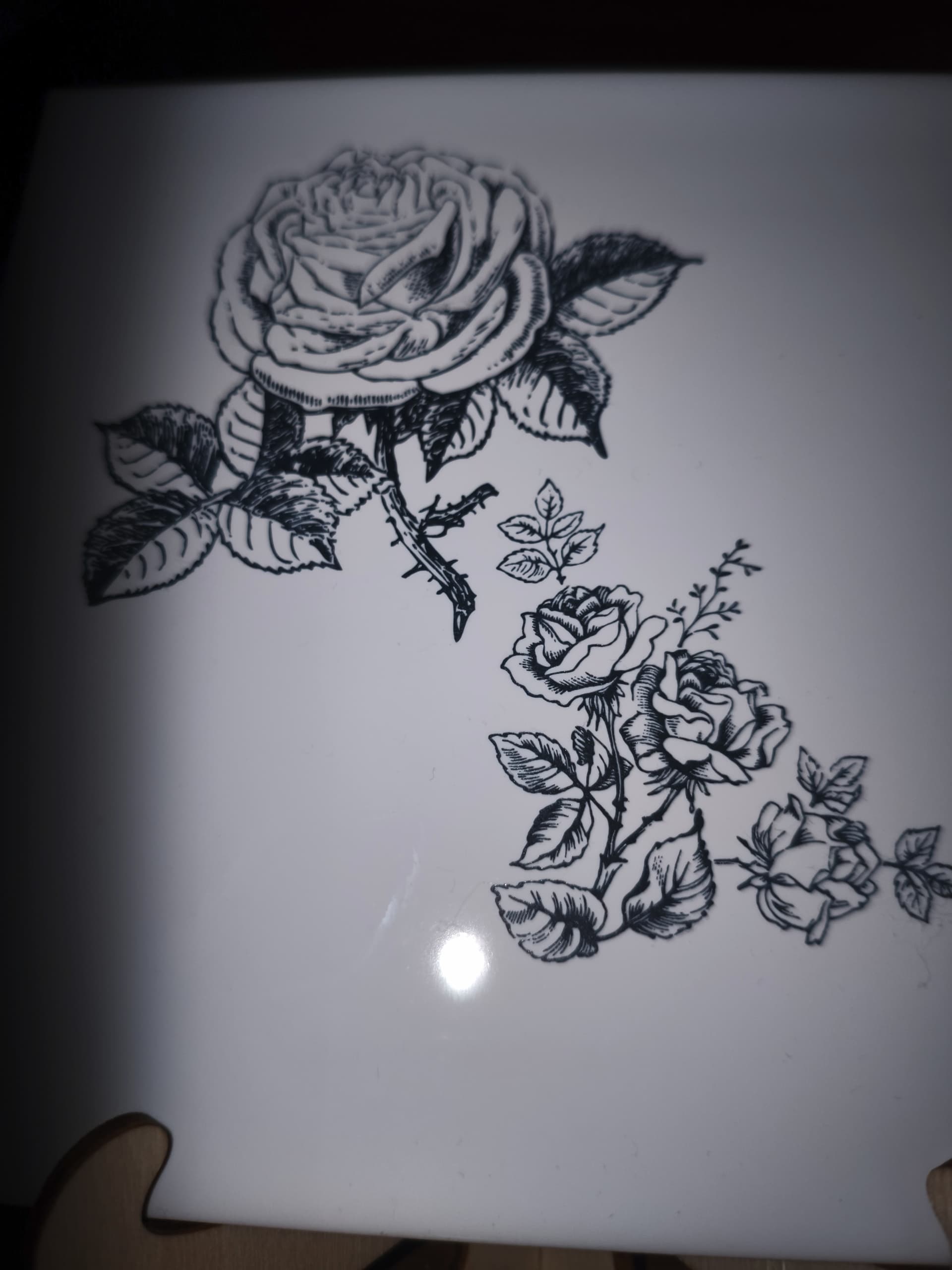

20W fiberlaser G2
Titandioxid Alkohol gemisch aufgesprüht
Settings 1000mm/min 12% 30kHz 1045 DPI Javis
Mit diesen Einstellungen auf Keramikfliese

uv 5w yes you have to go slowly but do tests for the power! Be careful titanium dioxide is toxic lots of nanoparticles so mask required, laser marking paper is a good option.

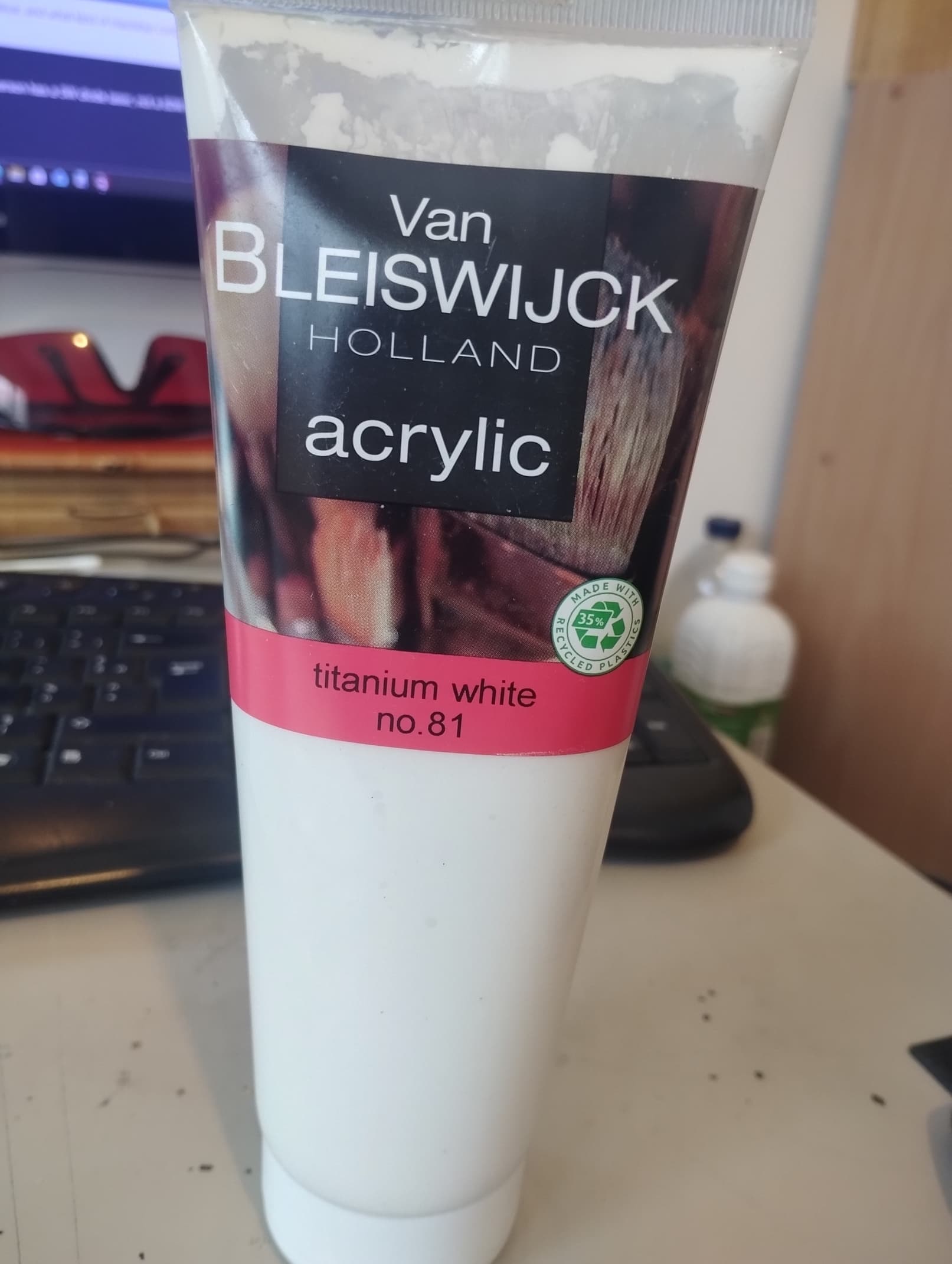

I use white paint which is easier to apply than tio2 mix…. Anyway… still keen to see a result!

Maybe so, but the removal part is much more of a pita compared to water soluble TiO2.

You can easily scrap the paint with a x-acto blade at an acute angle.
Anyway, back to topic… I feel like the UV just remove the glaze and expose the ceramic color, so grey ish.
