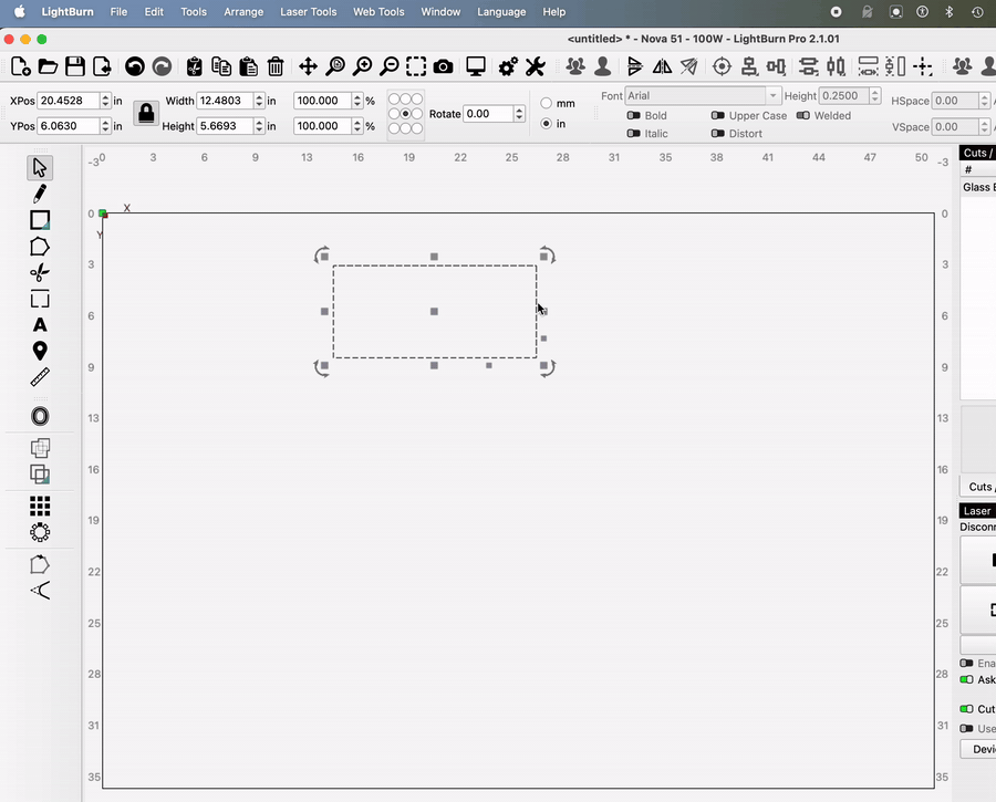

Updated to version 2.1.01 on my Mac running Sonoma 14.7.6. Lot’s of changes to get used to, but oddly the software is stuck in Imperial units “in” and can not be changed to Metric units “mm”. When clicking in the toolbar on “mm” it shows the toggle button as selected momentarily, but immediately goes back to “in” mode.
When going to Edit>Settings>Units and Grids>Design Units, I can select “Millimeters”, but as soon as I hit OK, it instantly reverts back to inches in the design window toolbar.

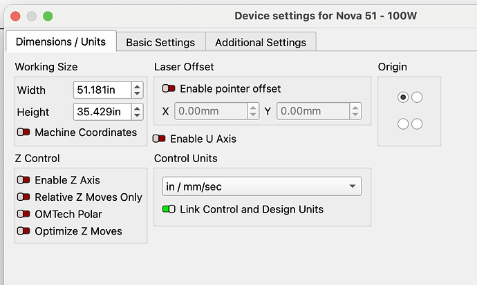

Can you check what your Device units are set to? Edit > Device Settings. Check there for what units you’re set to and whether it’s set to linked. Like Bernd, I have been unable to reproduce this at all so far, and I’ve tried about every combination of all the units changes I can think of.
Under Laser Tools>Device Settings>Dimensions/Units, I have the same settings I’ve always had when I first set up my ThunderLaser Nova 100W CO2 laser 5 years ago. I never change these settings:

If you go to Edit > Device Settings and turn off “Link Control and Design Units” it should stop forcing you back to inches.
