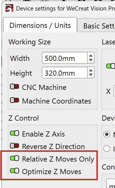

Updated to the new lightburn 2.1.03 now after the job is done the laser is very slow returning to home but if i hit stop it homes at normal speed. if i uncheck the relative z moves only it returns at the normal speed but my cutting settings from 2.0.05 dont work. I tried to cut 3mm mdf in 2.1.03 with the settings i always use and it wont cut through. It isnt even close i have no sign on the back side of the woof that the laser beam even go close to going all the way through. Any advise would be helpful. i am using the new file for the vision from lightburn.

it was already off. it works fine if relative z moves are off but it wont cut with the settings from 2.0.05. But if realtive z moves only is on it cuts fine just after the laser raises back up the head is very slow moving back to home. if i click stop then the head moves back to home at normal speed.

I’d advise to disable the Z-Axis in the device Settings, until we know the exact settings to control the Z-Steps per pass, as mentioned in the post I linked above.

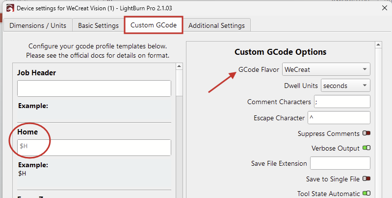

Please check the Device settings. In the Custom GCode tab, you should have “WeCreat” as the GCOde Flavor. That’s the main difference we added in version 2.1.03.
Both settings files send the machine the $H command for homing, so the sequence should be exactly the same.

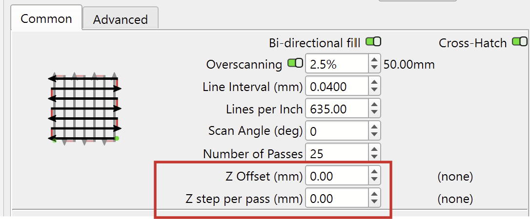

I ran a few more tests on our Vision, and couldn’t get Z-Steps per pass working.
The machine has a mind of its own and decides to randomly lift the Z-axis during the last pass without turning off the laser.
It then returns to the home position but Z remains at the current height.
The Z-Axis in Device Settings should be disabled until someone can find a workaround for this.
The Focus-Z function will still work when this is disabled. We only send the machine their custom command M130 and the firmware of the laser starts its focus sequence. That is: Move the head down until the material is detected, then move X & Y to the homing position. (The only way to prevent it from moving X Y after homing, is by using our “Focus Center” macro M130X200Y150.
The same goes for the Homing sequence. We send the machine $H, and the controller does its thing. The homing speed is defined in the firmware, so I’m not sure what you mean by “slow home of the laser head”.
