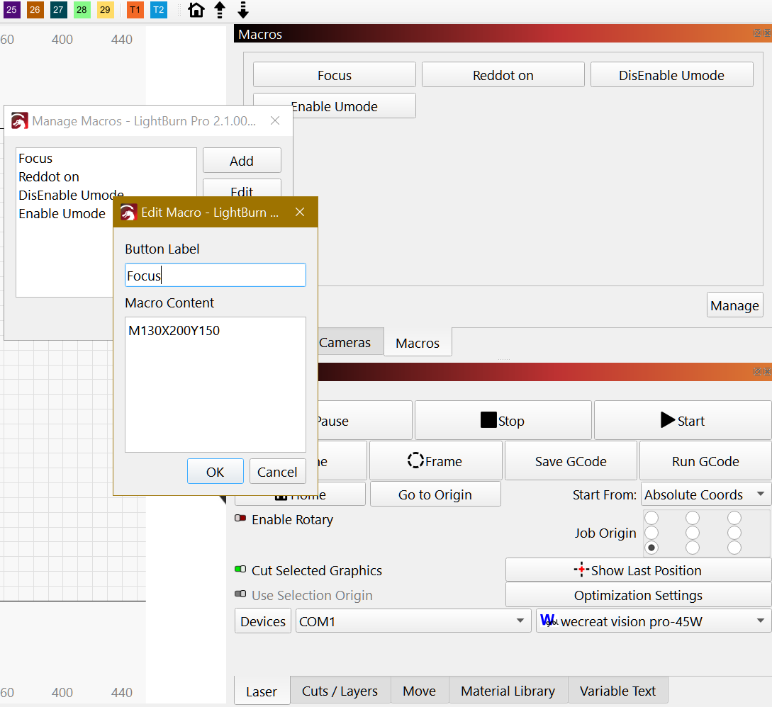

Are you willing to try 2.1.00-RC2 With the following device:
WeCreat-Vision_Pro-V1.0.lbzip (6.8 KB)
and check if it works? Installing 2.1.00 keeps 2.0.05
If you go to the Macros Window and click Manage then Focus > Edit you can change the Macro point coordinates.
EDIT: updated device with image from Wecreat.

You can change the values of X and Y to values within the laser’s work area. Ideally were you place your materials to manually focus.
A Macro is simply a series of commands, typically GCode, that is sent to the controller when the macro button is clicked. It is basically a text file, but you do everything in Lightburn. Very simple to do and manage. Fear not!
