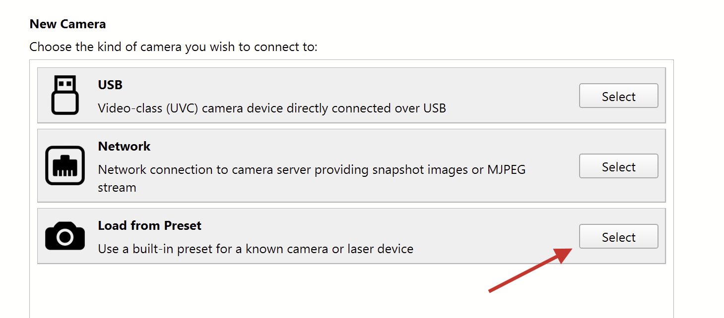

The camera in the Vision is using a “Network over USB” / RNDIS protocol.
Select “Load from Preset” in the New Camera wizard
And choose WeCreat

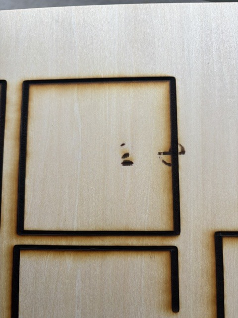

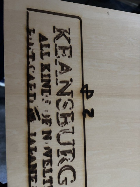

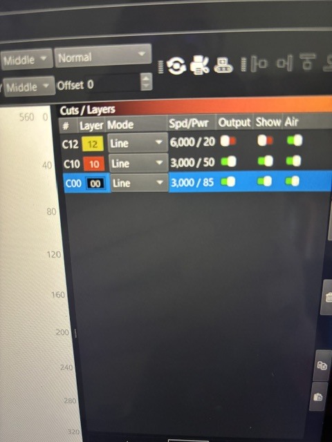

Sorry for my slow reply. My MAC could not handle the memory demands of my new machine, so I have had to transfer over to a Windows machine. I have set up as advised, yet the laser focus is still off. I have recalibrated at least four times. Pictures attached. This first shows my settings, the next shows what is to be a cut line…You can see some of the calibration standard to the right. The beam does not appear to be focused. Anything at less than 45$ power does not make a mark on the wood. I am using Birch plywood. Any suggestions would be helpful.
Absolutely. The cut line would be way finer.

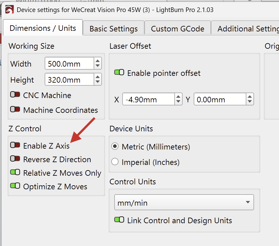

Did you disable the Z-axis in the Device Settings, as suggested previously?
If it’s still enabled and you have a Z-Offset in the Cut Settings that would explain why it’s moving out of focus.

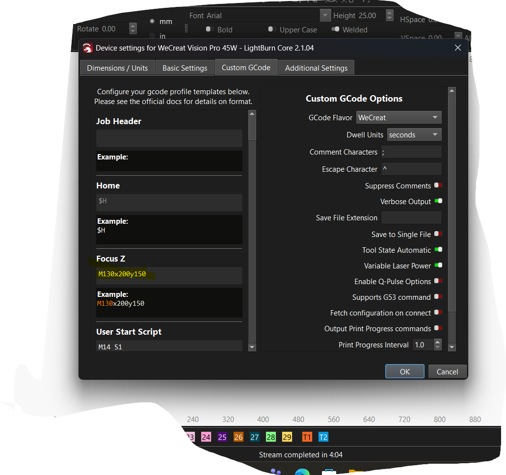

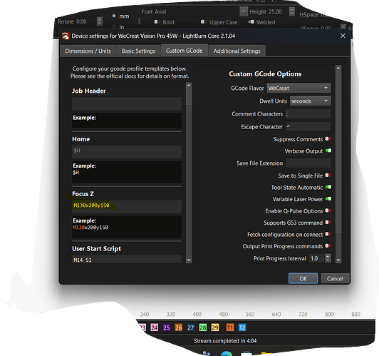

I see you’ve changed the “Focus-Z” GCode in the device settings to have it always probe in the middle. That should work, but it might require all capital letters for X and Y, like so:
M130X200Y150
Still:

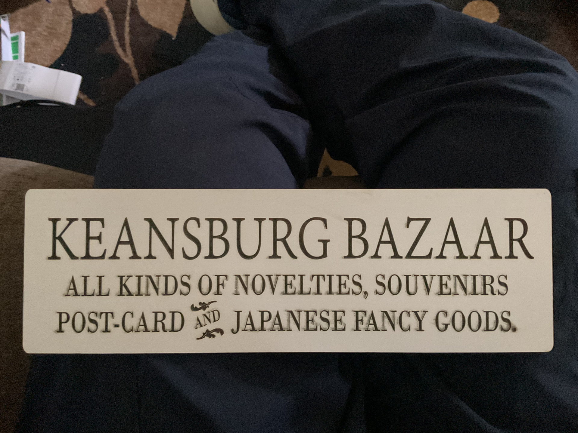

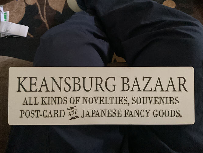

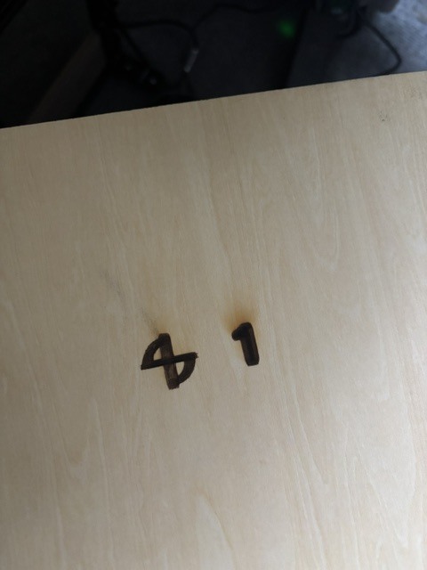

*I verified the z-axis controls were set as discussed. I tried a simple design…that result is provided along with a picture of how it should look
I also corrected the g-code!
So, you disabled the Z-Axis in the Device Settings here?
Does your customised Focus-Z GCode actually work, or do you see an error in the console when you initiate it?
It’s worth a try to lift your sheet of wood up a couple centimeters and performing another Focus-Z sequence. From the top of my head, the focus (material surface to nozzle) should be about 2cm.
Does the Z axis move up or down after you told it to focus?
Because: homing the machine moves the Z-Axis all the way up towards the limit switch.
Running a test now. Z-focus does move the head…
Much better…I need to play with the speed and power. Is there a g-code to send the laser head to its origin… mine literally stops where it is at when complete
