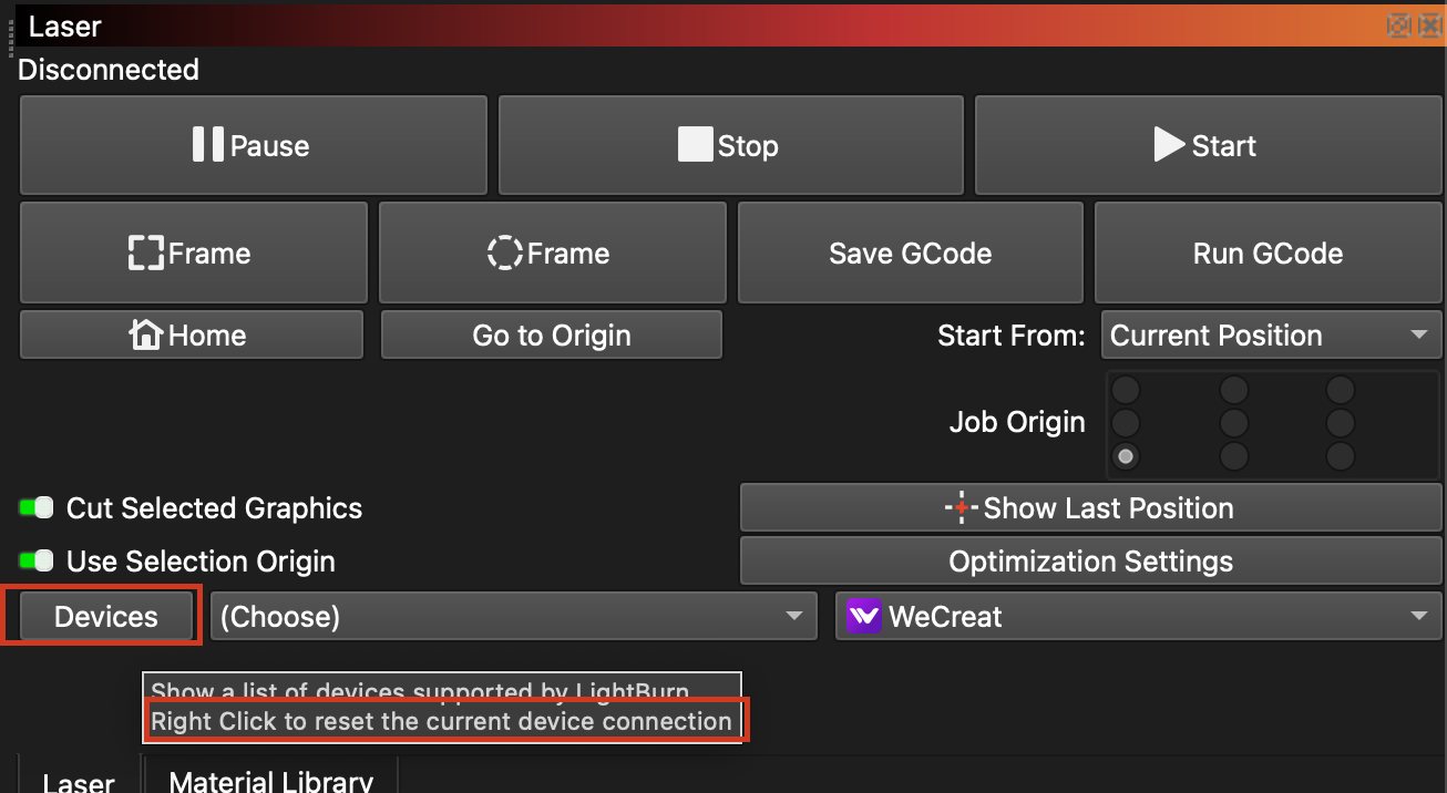

Can you send us your device profile, so we can see your current settings in LightBurn?
Click on the “Devices” button in the Laser window, select the device and hit “Export”. Attach the .lbzip file here.
Can you confirm, that everything is working with your current setup, except for the safety switch?
