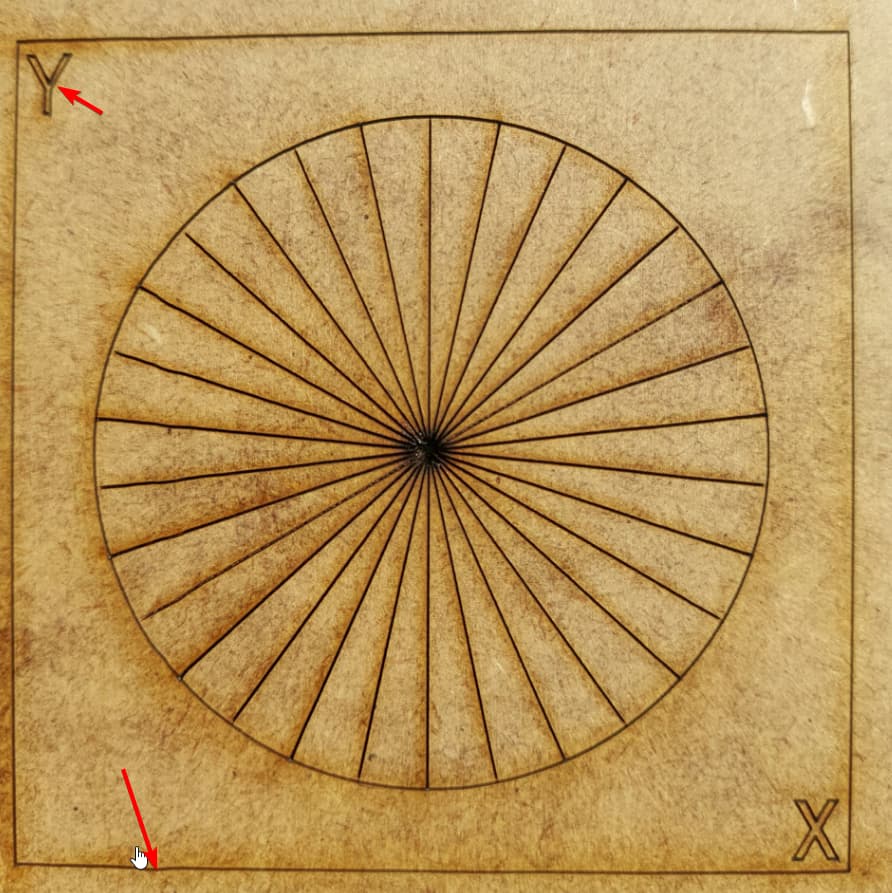

Run this for me and take a picture with measurements
Dot Test with Angle.lbrn (46.3 KB)
Here you go…
Note the body of the Y
Also - by eye - notice how the circle isnt a circle (you would have to measure)
so therefore your X still needs work
Make sure as well your Steps per mm are in fact both set to 80

So when you say my X still needs work, what are you referring too?
Belt tensions, make sure your movement is smooth, make sure the cables are not tugging on the module and creating tension
Overall give a once over and pluke the belts make sure they sound tight. all the same sound

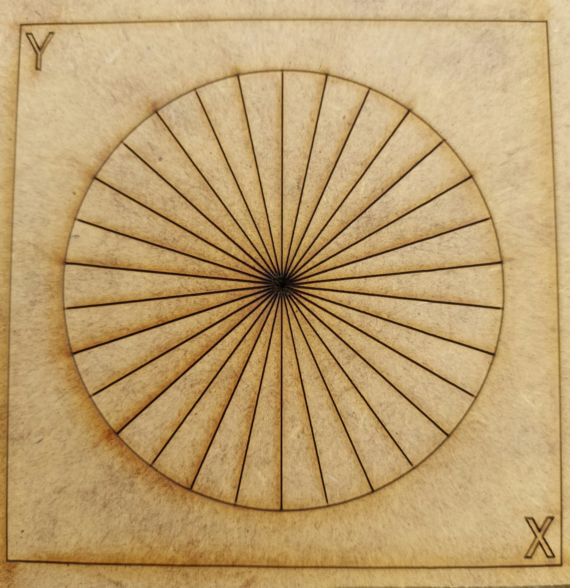

I have retightened as much as I am comfortable with and still the same. But I haven’t tightened the Y axis as they are ok. BTW I appreciate your help with this…
not the same a significant improvement, compare both Y letters

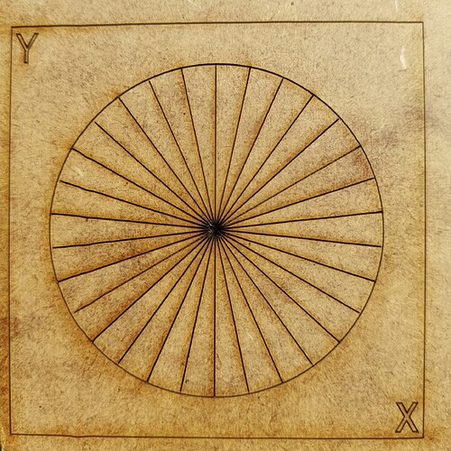

Whats the measurements of the box?
Still X 29.8 x Y 29.99… If I could get .15 on the X it would be pretty much spot on.
28.8mm x 29.99mm?
I actually asked the size of the box on my test
Should be 76mmx76mm

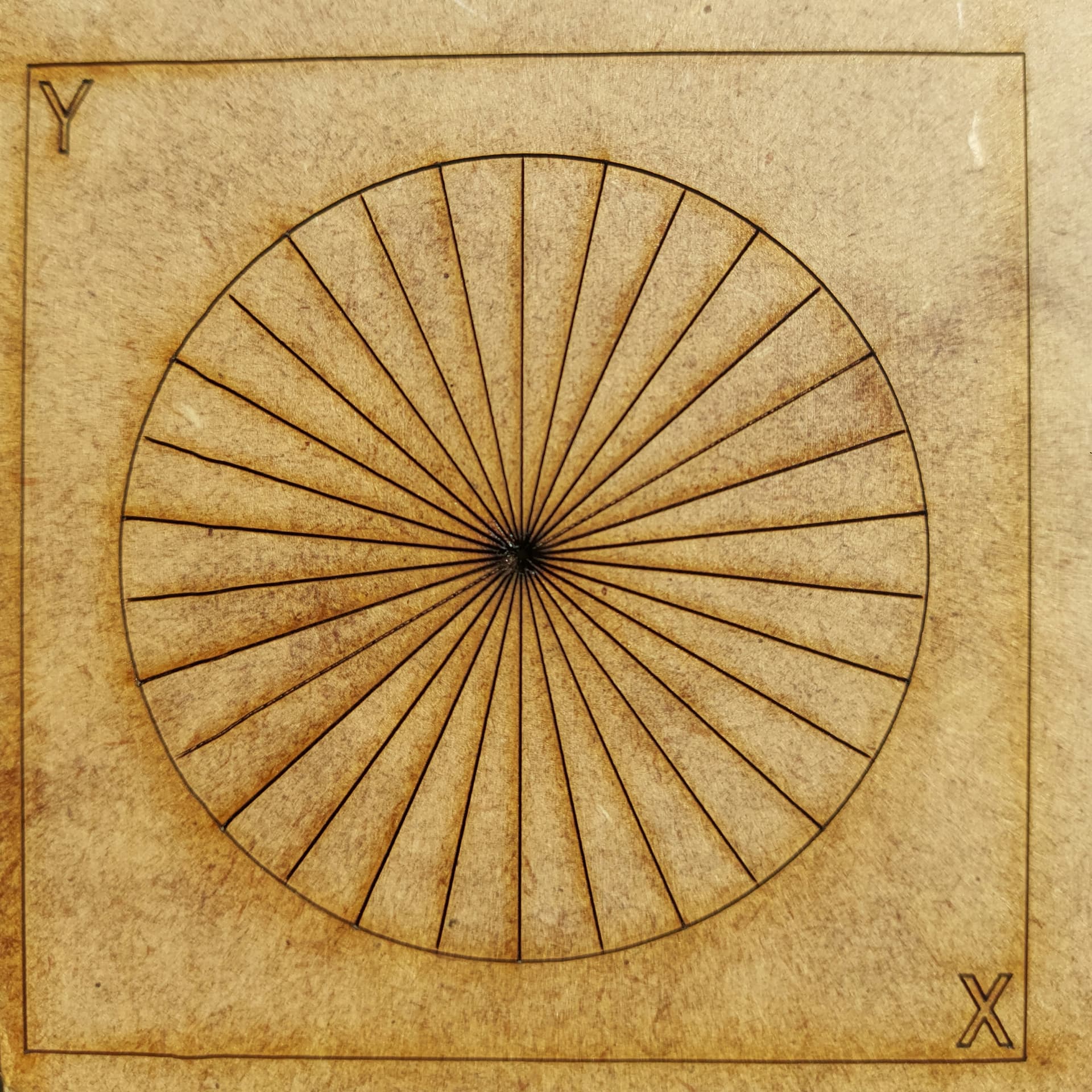

Sorry, ok I will run it again and cut the outer layer out so as to measure it.
Average on the X
X 75.70
Y 75.98
so slightly short on X
0.3% deviation on lenght

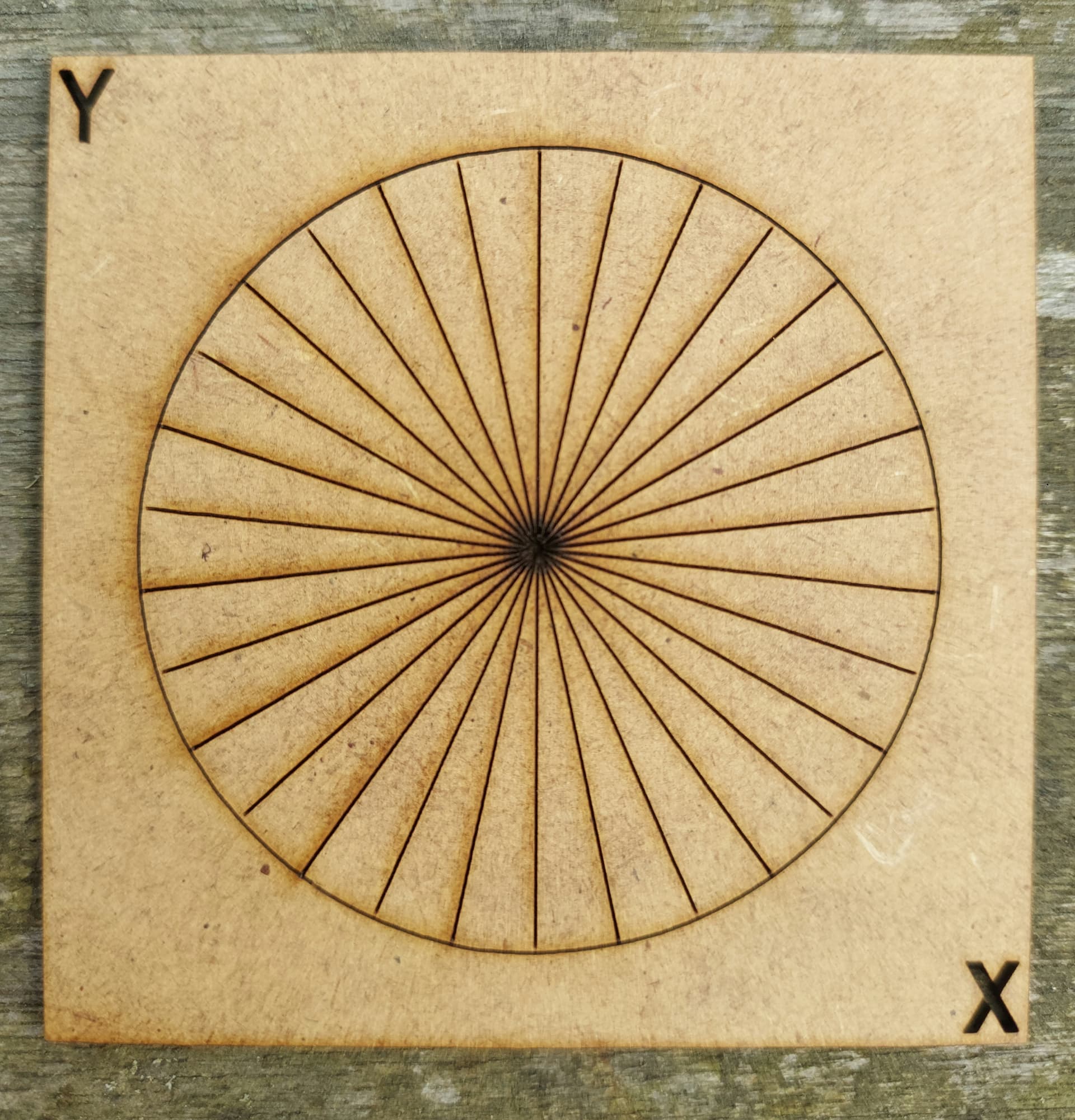

You need to contact Creality (@Creality_Rachel ) and get them to give you the exact procedure to stablish the correct belt tension

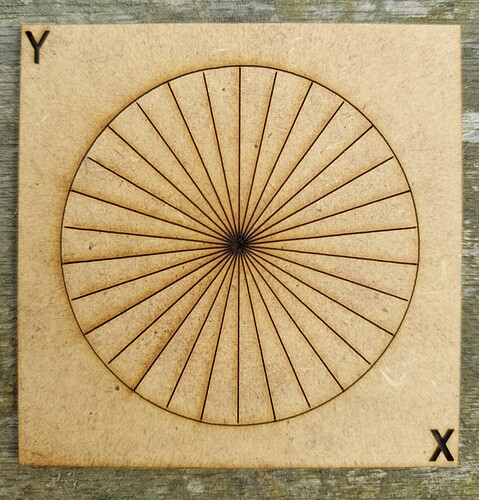

I have a 2 pro i will try to test check my acuracy a bit later.
But all in all 0.3% deviation can be eaten alone by the beam thickness
Consider your module dot size is probably 0.15x0.2mm
Yes I understand what you are saying. Being an engineer you do get a bit anal on accuracy, especially as my cnc’s are spot on. No doubt there is some deviation caused in the kerf on various materials. I will contact Creality and spin it by them though. I would appreciate to know your measurements when it is convenient…
