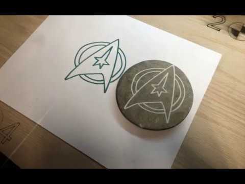

This video is self explanatory on the benefits
Here is link to a post to help you figure out which camera you need based on your bed size
Cheers
