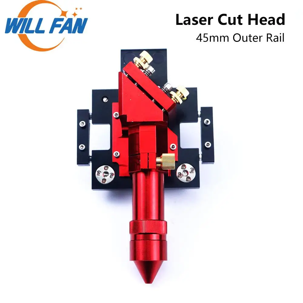

My problem is I have 12 mm lens. HARD to find but I did, at Cloudray Laser and ordered a 12 mm CVD ZnSe meniscus lens, until I can find a new laser head that I can use. My laser head attaches different than most, it’s a Samger 80 watt. LightObject was no help at all, here is a picture
anybody know of a replacement head I could use so I can get a larger lens?
Maybe just change the entire body that attaches to the gantry. Plenty of options if you can go that route.
Does this work?
US $23.50 6% Off | Will Feng Laser Cut Head Fit 45mm Outer Rail Mirror Dia 25mm Lens Dia 20mm FL 50.8/63.5mm For Co2 Laser Cutter Engraving Machine
That looks pretty good BUT it has no air assist and no red dot laser holder. THANKS for the info though!
It does have air assist (pictured) and the red dot pointer is easily attached to the head’s threaded end.
I removed my pointer. Those pointers are pretty useless and never accurate. I’ll mail you mine if you want it. :slightly_smiling_face:
That looks like it’s made to ride on some kind of V rail with those rollers on the back side. Wouldn’t mount to his linear rail block. ??
Have you taken the head off to see how your round tube is attached to the bottom of the block? Possible to maybe just replace the tube? What’s the bottom side look like?
