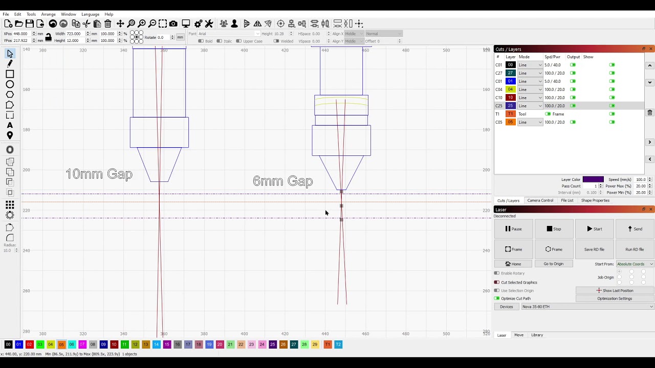

Still, I’m a bit curious. Usually we talk about how far the lens is from the work surface.
But this diagram and video also seem to illustrate that it matters how far the lens is from the final mirror.
Hence, different length tubes for the different lenses.
Obviously, I don’t have a perfect grasp of this yet, so thanks for the discussion, but I suppose it could be more critical if one had something like autofocus.
The only way I know how to focus is by burning on a ramp by trial and error…
