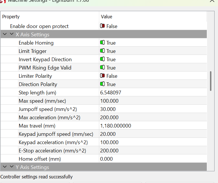

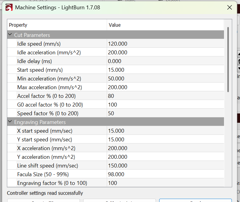

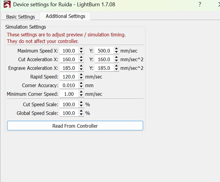

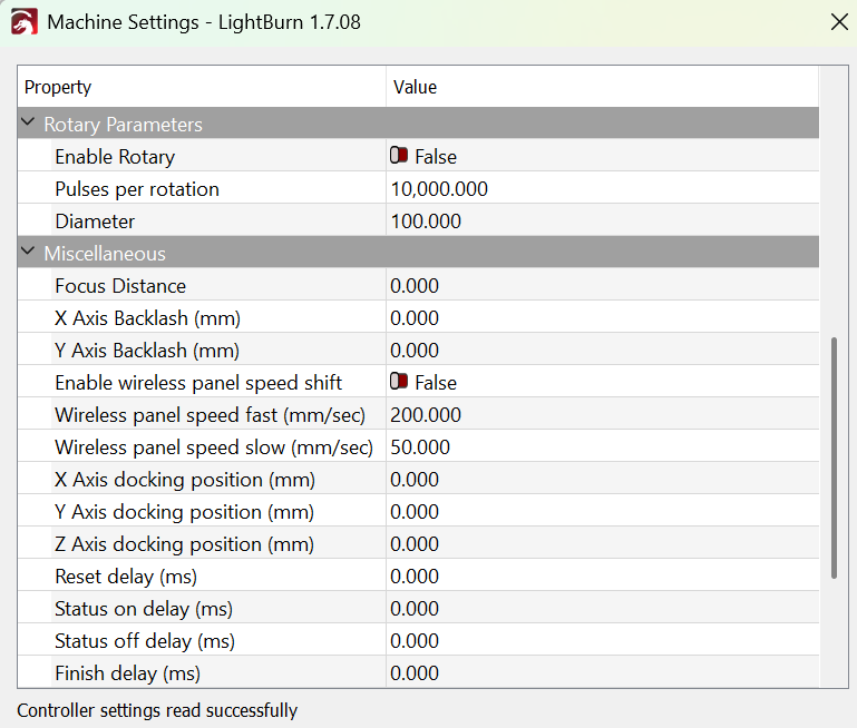

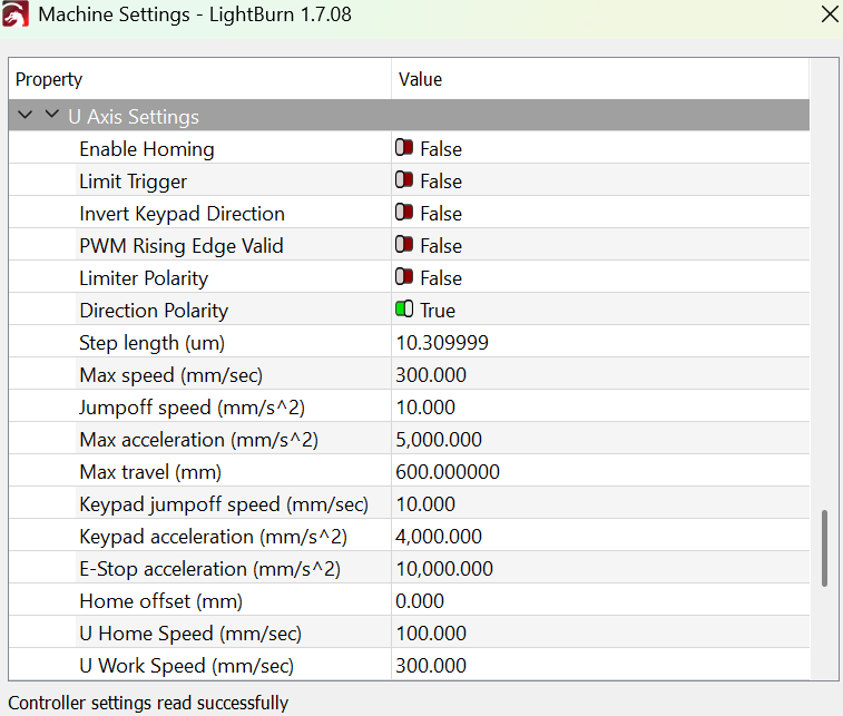

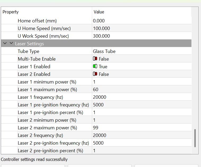

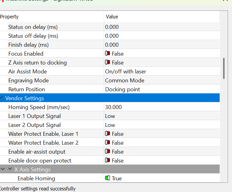

This may be a controller misconfiguration, because getting all those right on the first pass is impossible.
It’s tedious, but upload screenshots of all the Machine Settings so we can see what’s going on; screenshots seem to be the least awful way to present those settings.

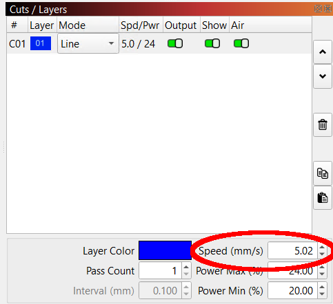

Having had a night to think it over:
It’s moving, but soooo slowly you didn’t give it enough time to get anywhere.
Set the layer speed to 200 mm/s and see what happens.
Perhaps you’re thinking in “inches per second” rather than “millimeters per second”?
