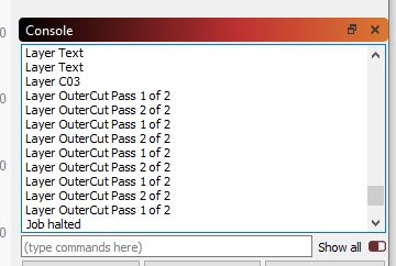

When I Cut out an object set for 2 passes the passes keep repeating until I hit the stop button.
Hopefully I’m not overlooking something simple
Any suggestions would be greatly appreciated!

Are the shapes duplicated? If you have more than one copy of a shape, it’ll run each copy twice.
If I have multiple it does not move to the Next Object If a single object it just keeps making passes on the single object
Likely something going on in the design. Can you upload your .lbrn file here for review?
So I created a new Cut Layer turned the old one off now it seems to be correct job finishes after the second pass, About to see what happens in a Array of 6 objects. The only Change to the lbrn file was added the new layer with the same settings as in the old layer
The array of 6 Worked as expected. Don’t know what happened to the initial cut layer. But will try using it again in another Project and see if it duplicates or if maybe it was just a one time bug. Thanks to all who commented.
