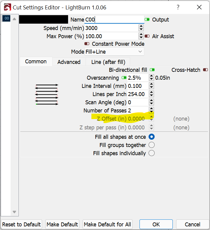

Hello, Starting to work with LB, but where can i enable the Z-axis ?
Its not in the “device settings”, but when i turn off “Continuous Jog” i can manual move Z-axis. also there should be a z-offset in the layer “cut settings editor”, nothing there, my machine has switches om all axis and homing on machine startup…
You may have missed it in device settings:
Also, the cut settings for Z offset:

The z-axis is enabled and i can use the controller buttons to lower or higher the table.
But there is no option in LB, only XY axis.

Hello, There is no option to turn on/off the Z-Axis, like the XY axis its always on.
Look in ‘Edit → Settings’ and see if ‘Beginner mode’ is enabled.
