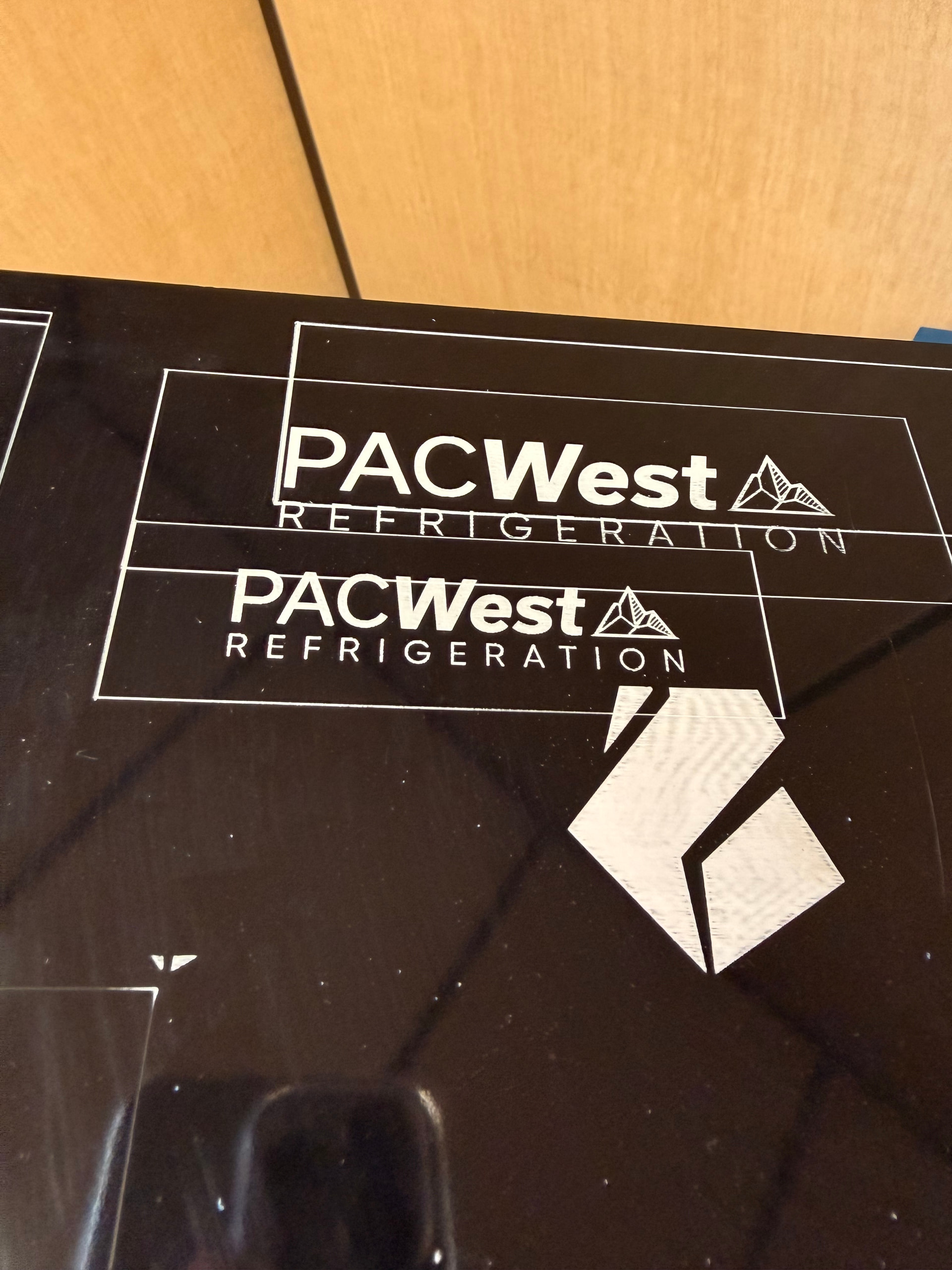

I’m completely new to laser engraving, or CO2 lasering all-together. My company purchased a LightObject Ranger 3 laser, because I did some research, and it seemed to be a good company, and a good laser. I was having some trouble at first and getting varied results, but eventually I thought I had a good setting on LB (results are black photo). I used 285 spd, 85 pwr, 0.100 interval.

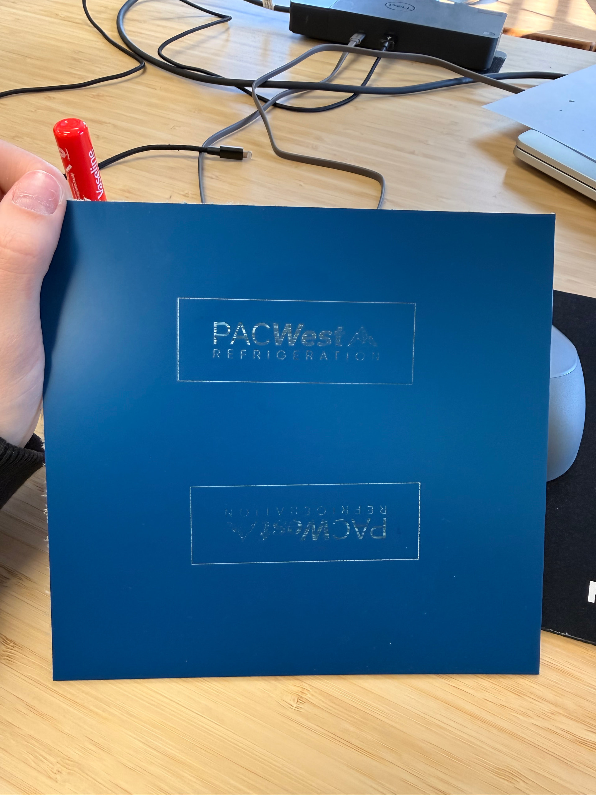

We were still continuing to play with the settings on LB to see, eventually our results went back to square one and stayed there (blue photo). I’ve done some research, and I cleaned all the mirrors and lenses with rubbing alcohol and q-tips (there was a lot of buildup on the lens) but it hasn’t changed my results at all. I’m wondering if it is an alignment issue. I’ve tried watching tutorials and I’m worried that I will mess it up even more so I want to be 100% sure it’s that.
There’s very minimal info/tutorials for the Ranger 3 laser and I’m just wondering if anyone has any advice or idea what the issue could be?

It looks like you are using two different materials, one shiny and one matte. Where did this material come from? Did the manufacturer provide laser settings?
Have you tried increasing the power and decreasing the speed? I would just laser a little filled mode box in the corner of the blue material until you find that perfect combo to get the results you’re after.

Everyone seems to tell me that, but even when I was getting better results than currently, anything below 80-82.5 power didn’t engrave very well and it ended up being similar to what I’m getting right now.
I’m not sure where the black material came from, but it’s almost identical to the matte just different finishes. The blue is Trolase plastic and it’s what we’re needing to use to make limacoids (the whole premise of buying the laser). I don’t think the manufacturer provided settings. I wasn’t familiar with the 3 start positions but I appreciate the link because it did help! I am engraving the material exactly 6mm away from the laser.

Tell us what material you’re lasing. A link to an item is better than us guessing. Do that if possible.
Each photo looks like a different material which usually means different settings on the machine.

https://shop.troteclaser.com/en-CA/product/l512-306-trolase-bluewhiteblue-24x48x116-in/01t8e000000AwFrAAK This is the blue material that I am using, I got the other material from a friend of mine but it’s essentially the same, just a different finish. I do have the mA meter, I haven’t paid attention to it before but I will take note of what it reads when I fire next!
Took an eyeball of your materials and it’s basically acrylic. The recommended engraving depth is 0.003” or about 0.076mm. Even 0.1mm isn’t very deep especially for the material using a 75W machine.

If that’s for something like Trolase, that’s too slow and overpowered.
These were plant tag test pieces done at 400 mm/s and 14% of a 60 W tube:

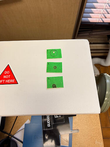

The fact that it’s not charring the material says there’s something wrong with the optics: either the tube isn’t generating the proper beam shape or the beam isn’t making it to the material.
Start by cutting some one-inch squares from a manila file folder or similar heavy paper. Tape a square on the entrance to Mirror 1, which is the one in the back of the machine just beyond the end of the laser tube. I made round targets, but there are few style points for this task:
The controller on the machine has a button labeled Pulse (or something similar) to fire the laser; as always, with the water chiller running and the lid down.
Press the Pulse button quickly, open the lid, and see what happened to the target paper. What we need is a brown scorch, not a crispy hole burned through:
If the briefest pulse you can manage blows through the paper, that may be good news. If it’s weak, repeat the pulse enough to make a visible mark.
You’ll do that at all three mirrors and all three spots should be dead-center in the middle of the aperture.

I did some very basic testing and it is obvious to me that my 3rd mirror is completely off. I’m not sure if the 1st mirror is, but it’s obvious that 2 is dead center. (Keep in mind I did do a few pulses on each).
This was quite reassuring since I’ve tried so many other possible solutions and nothing had changed.

Agreed… However I cut my own targets out of watercolor paper. I wonder about his TEM mode, doesn’t look right where I can see it.
Can’t tell anything from the first mirror, the second has an odd power distribution and there is no reason the spot shouldn’t be round on mirror 3, unless it’s getting clipped somewhere in the optical path.
Depending on the power setting, TEM mode can change. My last two tubes showed TEM01 at 10% power levels. Raise the power it does come back into TEM00 mode.

It is getting cut off. I’m assuming it has been this way since it was shipped to us. Should I be using these targets for alignment? The videos that I’ve been using he also just uses painters tape.
Not only that, but the beam is diverging much more than seems reasonable between M1 and M2.

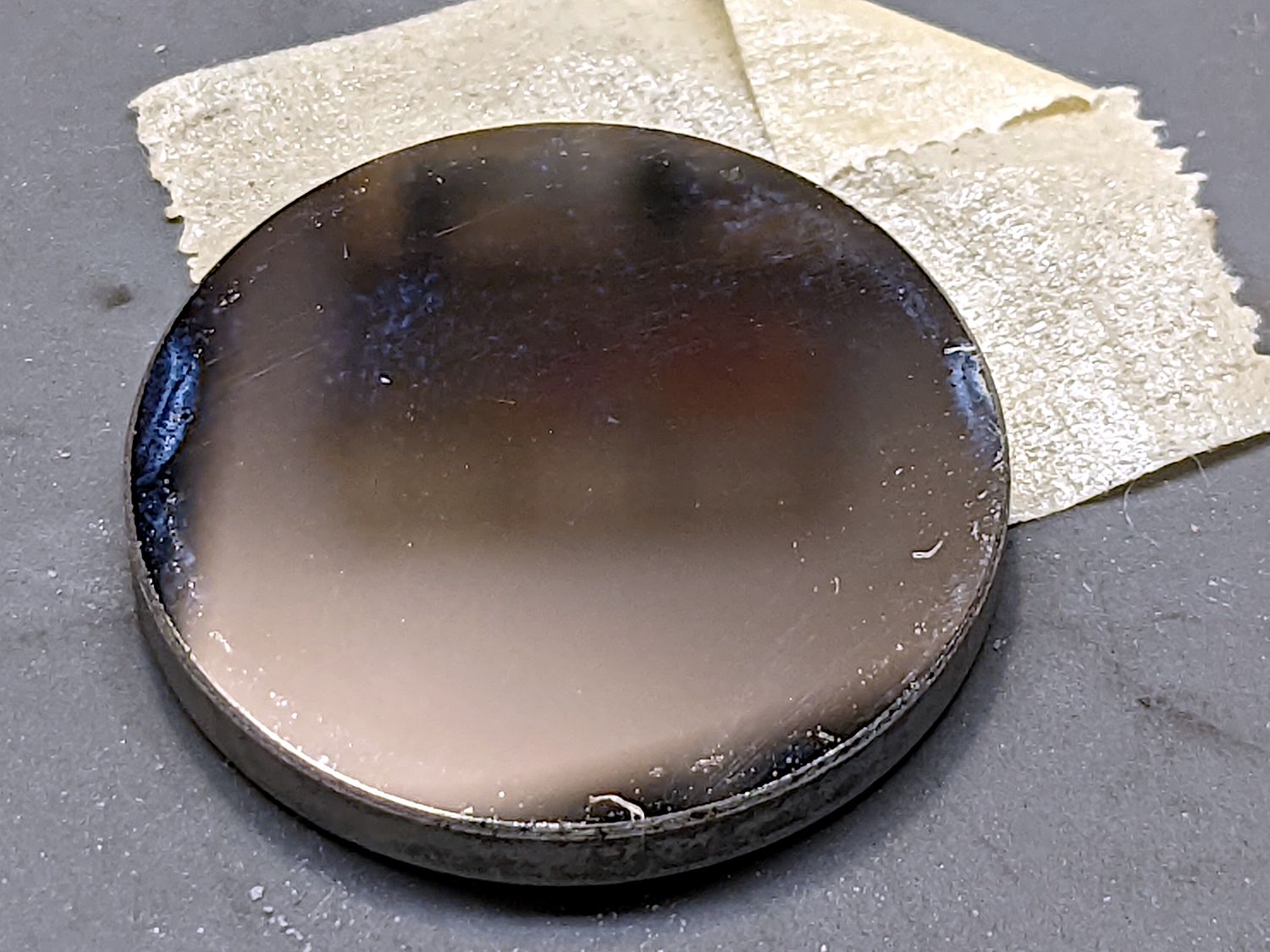

Are the mirrors clean and undamaged?
The molybdenum mirrors in my machine looked like this:
After cleaning:
Gold-on-silicon mirrors will look different and require more care in cleaning, but the idea is to have a clean, perfectly reflective surface.

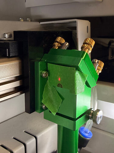

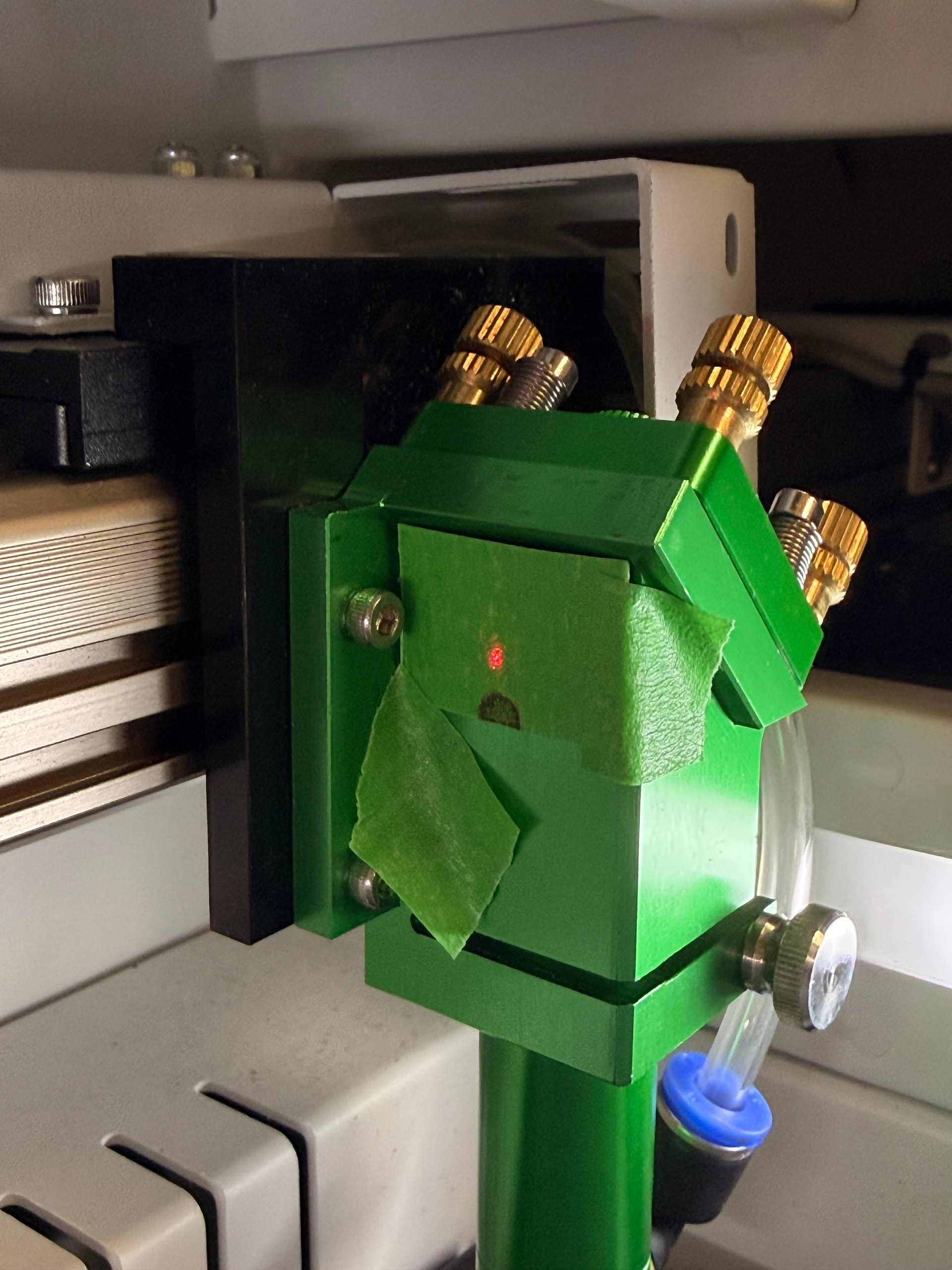

The machine has a red dot that is badly not collimated with the CO₂ beam:
The scorch from the CO₂ beam should be dead centered on the red dot.
It looks very much like whoever adjusted the mirrors believed the red dot was properly aligned with the CO₂ beam, got the dot nicely centered, and didn’t notice the CO₂ beam is burning the bushes.
The manuals appear entirely generic and, in particular, make no mention of the red dot collimator.
Get on the phone with whoever sold you that thing and get the doc relevant to the red dot collimator.
While you’re waiting, you can adjust the mirrors without reference to the red dot just like everybody else does. :grin:

Assuming the complete beam strikes m3, it doesn’t need to be centered there. M3 is aligned more like catching the beam.
If you move m3 (head) up or down (Z axes) the beam in the down tube to the lens will move left and right (X axes). If you move m2 in the Y axes direction it will move the striking point of the beam along the Y axes of the down tube. The beam needs to go down the center of the tube and strike the lens squarely in the center of the lens. If it’s off one side or the other, the beam, after the lens will have the same slope.
These mirrors are not always aligned to the center of the hole, at least for the head. This was the original head from my OMTech China Blue.. note the mirror is not centered within the hole.
Many of these you have to do best guess as most don’t allow all the adjustment options.
