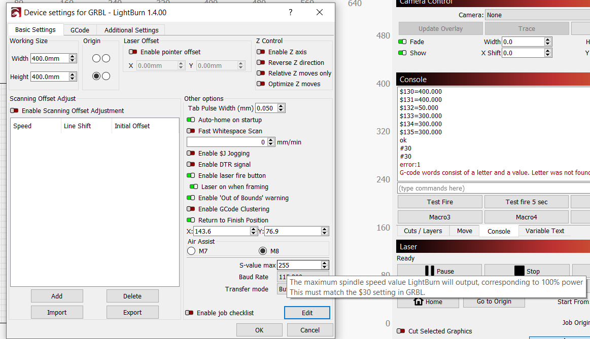

That’s true if the LightBurn S value max matches the GRBL $30 value, which are typically both 1000 these days. In that case, any increase of power beyond 100% does nothing, because it has no way to increase the output power beyond the $30 setting.
If the #30 value exceeds S value max, then 100% power isn’t actually producing the maximum possible laser power and the controller can increase the actual power using those adjustments.
Check those two values and, if they’re different, that’s what’s going on. If they’re the same, then something else is happening.

$30=1000.000 this is what is showing

#30 is a typo.

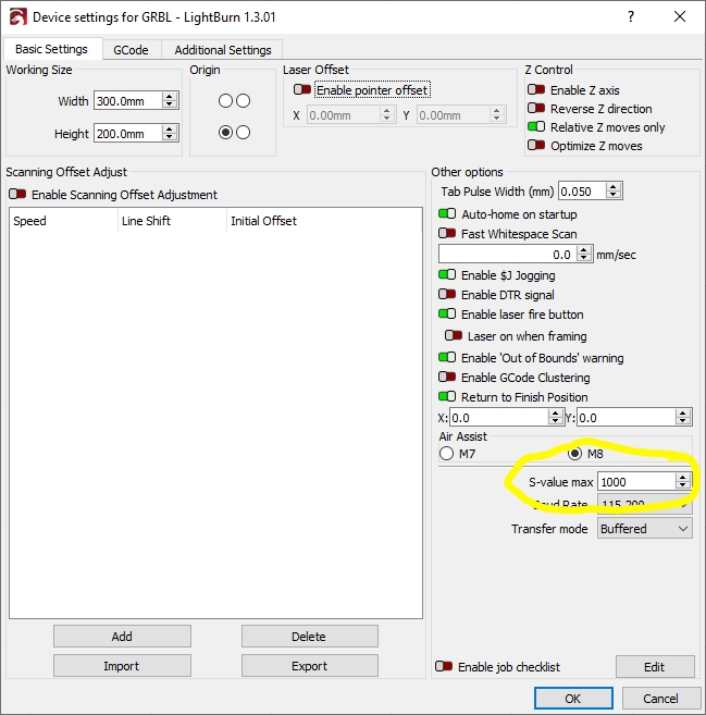

$30 is found in edit>machine settings (machine must be connected.)
S Value Max is found in edit>device settings. This value must match $30. Typically 1000.

So just to clarify where mine says
S-value max 255
This should be 1000 ?
I have typed this $30 in the console window and it does show 1000 in here
But also change
S-value max to 1000??
That’s correct. Both should be 1000.
