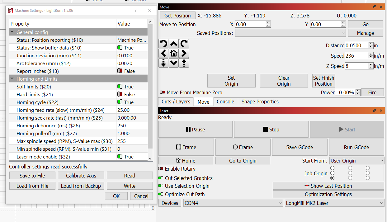

Ready for this??? I’ve had Lightburn for more than a year now and just opened it up after upgrading to 1.5.6. I know, Crazzzzzy right. Well, Since I also use Vectric V-carve, I finally decided that it’s time to figure out how to use Lightburn. I’m going through the tutorials however because my machine wants to home -15+ inches behind what Lightburn has decided to call X0-Y0, I need help. After several days of trying, I’m permanently stuck and need some expert advice. Can anyone help???

To help us help you, enter $$ in the Console window, then follow it with $#. From the Console window, copy the results and paste them in your Reply.

Here are the results of the $$ & $#
This morning I saw something strange happen. When I first access, Lightbourn, the coordinates were X=0 Y=0 and Z=0 at the homing point, However, as soon as I move the machine, the coordinates changed. I’ll include pictures. Maybe this means something?
I moved the Y axis back two clicks and got this.
Now the homing position is showing -7.9 as opposed to -15+? And a similar situation with the Y axis however, the axis hasn’t changed.
Curiouser and curiouser🤔
Okay, I see you are using work coordinate offsets G54-G59.
Do the ? in the console window and paste here. This will report machine and work position numbers.
It looks like you are G54, G10, and Current Position confused. With those settings, it would be hard to predict where it is going to end up. You are still in the CNC mode.
