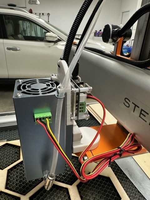

I replaced the 500mW head on my jl1 with a NEJE 40630 30W and ran new ground/power lines (actually all three) to the new module.
Of course it didn’t mount up, but the acrylic mount I cut out is working fine. The green board is the interface that came with the NEJE…

Thank you all for the advice. I await getting the actual xtool, but I think I found the connector on the web, showing pin assignements. The converter to attach it to my current laser driver board uses pins 1,3,6 which make perfect sense. I think that if I were to wire in a 3v crosshair laser, that it would be using pins 7 & 8, or am I reading this wrong? It looks like the board will supply 24 v so that will hopefully be sufficient…

Here is the picture of the adapter going from the 9-pin xtool wire to the 3-pin for the driver board for the Laser Tree laser (the picture from tech support shows it plugged in to the board output instead of the board input–so don’t worry about that part). But the wires used of the 9-pin cable are 1,3 and 6th wires. as compared to the xtool connector for the 9-pin cable. So I’m assuming that pins 7&8 of the connector have to be for the 3v crosshair laser.
Is this the animal you’re trying to hook up?
https://manuals.plus/laser-tree/lt-4lds-v2-high-power-20w-optical-power-laser-head-manual#laser_module_introduction
Is the black cable the output from the controller to the laser control module?
You are correct in both identifying my laser, as well as the black cable being the 9-pin cable coming from the xtool control board. Here it is currently connected to my CNC router.
Here is the million dollar question: would I even need to use the driver board if the input signal is TTL/PWM and output is the same? If I don’t have to use external power going to the Laser Tree driver board, it would be easier and far less bulky to simply convert the wire connector into the 5-pin input on my laser.
Interesting question since it appears the controller is a 3.3V system and the laser is ttl 0 to 5V…
It will probably work, but it is not a ttl level signal… just be aware of the difference…
Anything over 3V should be a logic high with ttl, but …
The only wires from the xtool connector that would be attached to the LT driver board would be 24V, the 3rd wire = ground, and the 6th wire = PWM. That appears to be the only input in to the LT driver board–from which the output wires go to TTL/PWM, ground, and VCC 22-24V.
I think the only connectors I can see (in pictures) going to the xtool is the 9-pin connector as noted on the board. At least what is needed to drive my laser is only the three wires. I was thinking that the 3.3V was the cross laser power? I obviously am showing my ignorence here-- Is the PWM wire from the xtool cable not going to be the same signal as the output from my laser board? The input connector on my laser itself is TTL/PWM. The listed output on the LT driver board is TTL/PWM. And if you had to guess as to which of the 9 wires on the control board above would control the crosshair laser, which would you guess to be the right ones? Here is a closeup and connections I use from my Stepcraft system, as well as the input that Laser Tree showed me to use in a tech support session.
The control board, with the 3.3v markings are sending a pwm signal to the interface board. This is a pwm signal, but not at ttl interface levels.
Standard TTL circuits operate with a 5-volt power supply. A TTL input signal is defined as “low” when between 0 V and 0.8 V with respect to the ground terminal, and “high” when between 2 V and VCC (5 V)
Most of these newer boards use a supply of 3.3V not 5V… It should work but it’s not really a ttl signal… Notice it states above 2V it should be logic high, so you should be OK…
The input and output designation is usually relative to that device.
Make sense?

Generally speaking the 3.3V pwm output will drive your laser…
I have no idea about the cross hairs or what generates them, so I can’t help you there… 3.3V is an odd voltage to put out for leds… but it might be since the board is a 3.3V board…
The interface board is there for you to merge the more powerful power supply to the laser without too much difficulty… I don’t know your system, but you could probably bypass the board. You’d have to wire things up manually.
I think you are worrying too much about this… lots of people do it successfully with a 3.3V pwm source.
Take it one step at a time… Did you ever see anything about how the crosshairs are generated and how to hook them up?
I’d suggest you figure out how to get the laser working in a basic mode… It could be the new head doesn’t have those cross hairs anyway… so you’d need to know what generates them…
