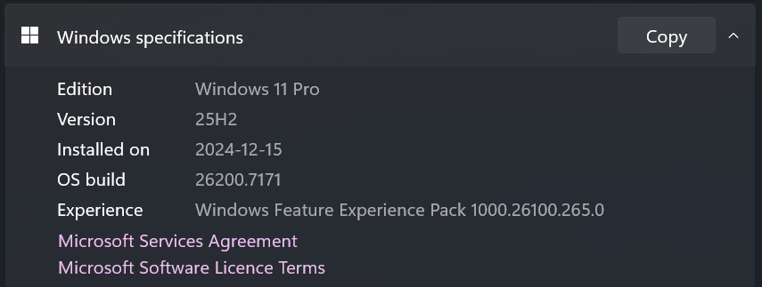

LightBurn requires 64-bit Windows 10 (build 1809) or later - so it should run on most Windows 10 installs. Have you upgraded your Windows 10 to the latest release?
You can press the Windows Key then type ‘About this PC’ then press enter, and see what release you are on. Scroll down to the Windows Specifications - here’s what mine looks like on Win 11:

Hello Colin
Its running Wndows 10 Home N
Version 22H2
Build 19045.6466
I am not being offered further updates.
