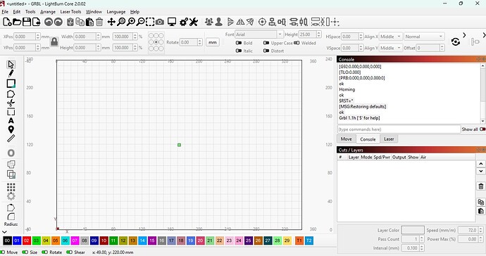

What do I do next please?

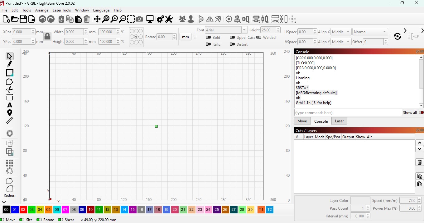

Sorry forgot to mention what happened after $RST=, so after entering $RST= my laser moved where I told it to but now that i go to frame, it goes to the center of the cutting board that im going to laser and then goes towards the front outside of cutting board all the way to front before its stopped by switches.
$RST=*
[MSG:Restoring defaults]
ok

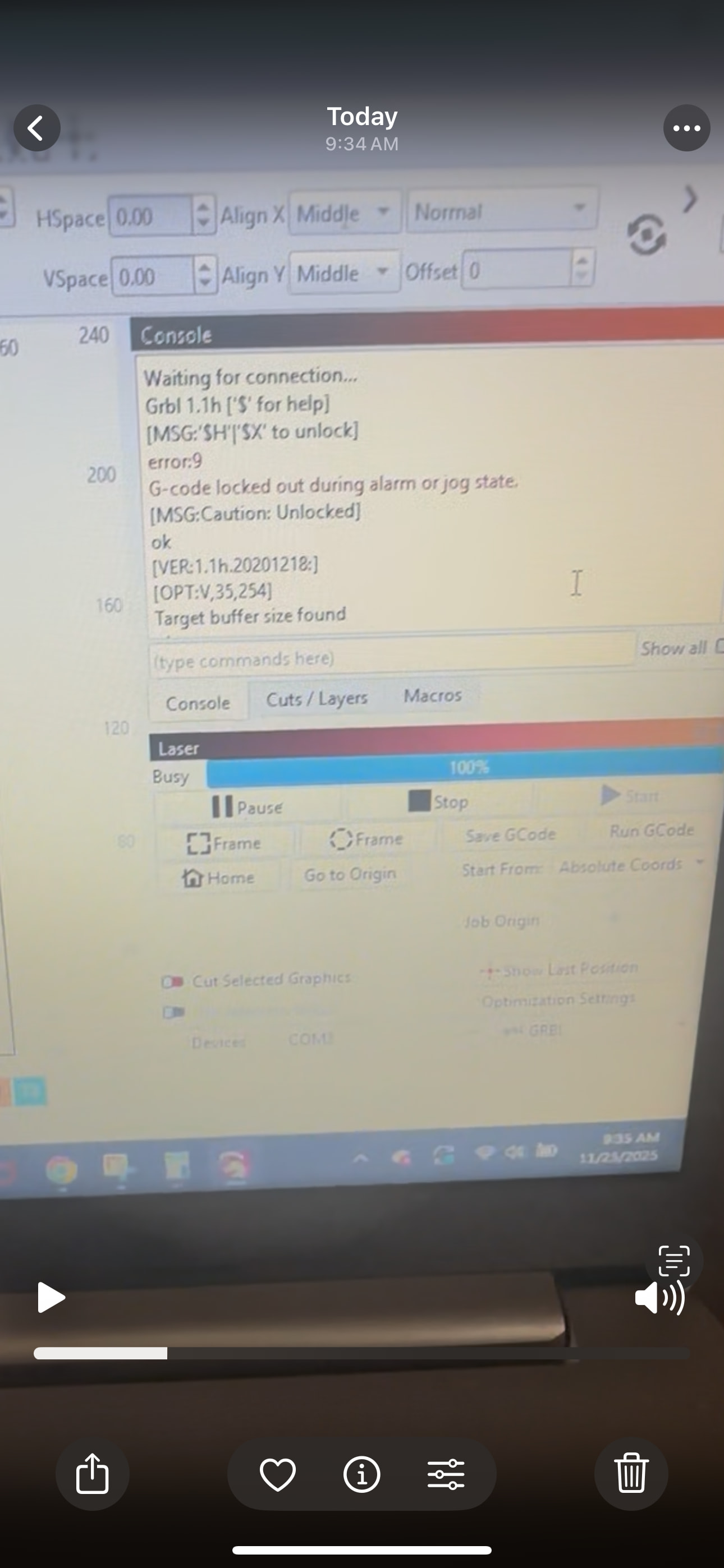

OK, I closed out lightburn and reopened. Homing went opposite corner from where it should of (it went to right rear corner) then, I homed again and it went to right front (also the wrong homed corner). I only did the RST code and $X to unlock before homing reattempt.
ALARM:8
Homing fail. Cycle failed to clear limit switch when pulling off. Try increasing pull-off setting or check wiring.
ok

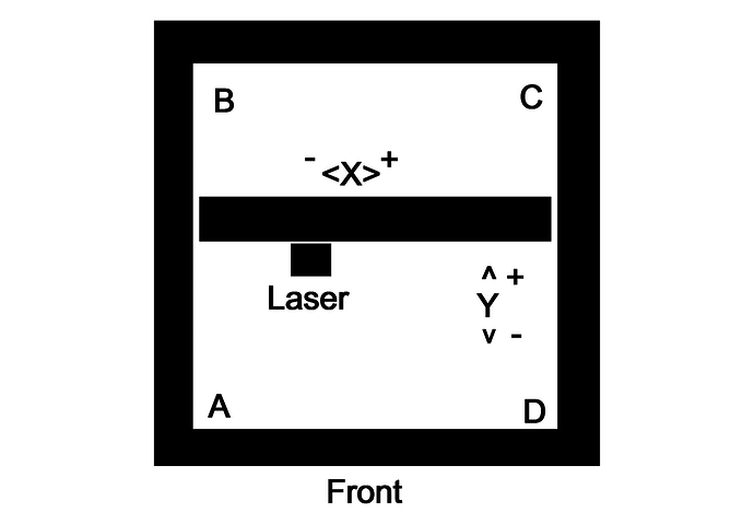

  1. HOME must be set up first. Place the laser module in the center of the workspace and power it up. Tell it to Home and tell me which corner it travels towards.

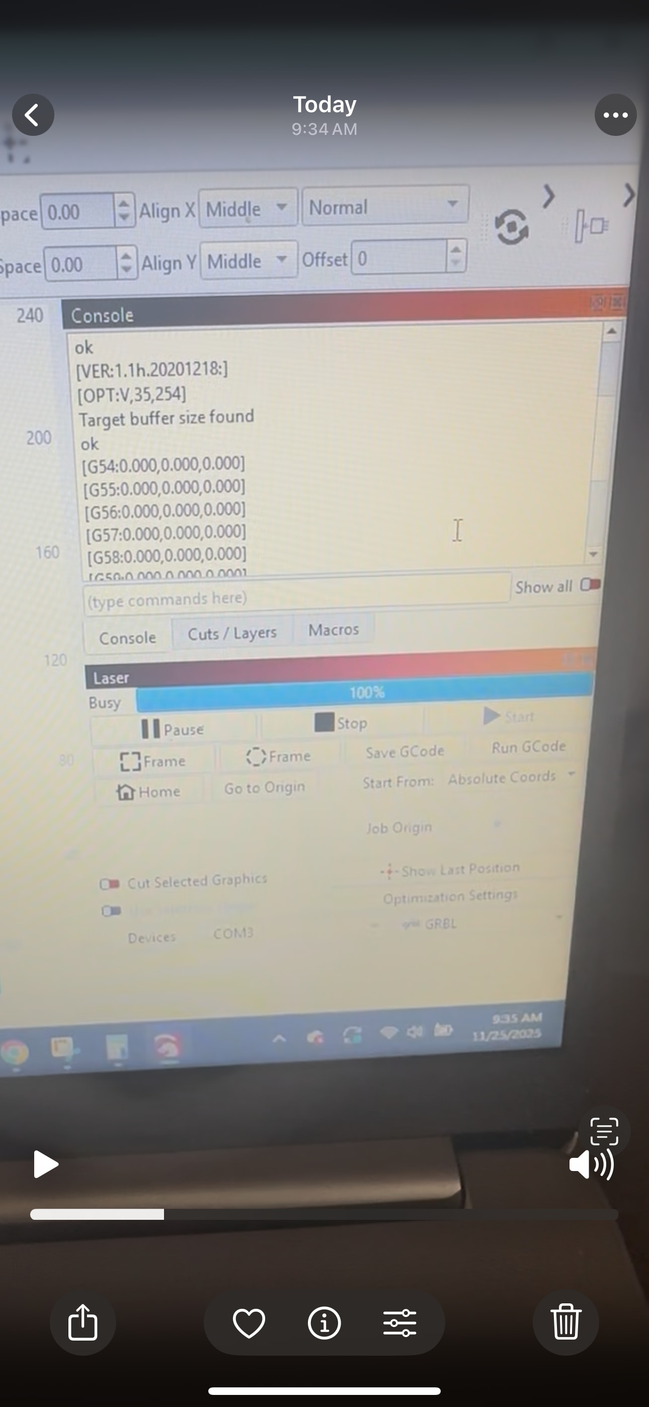

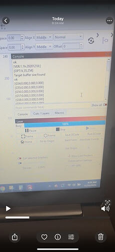

Ok. After powering it up in the middle of the workspace, I Homed it and it went to the left front.
That is where it should go, I am pretty sure. Did it Home okay without any errror messages?

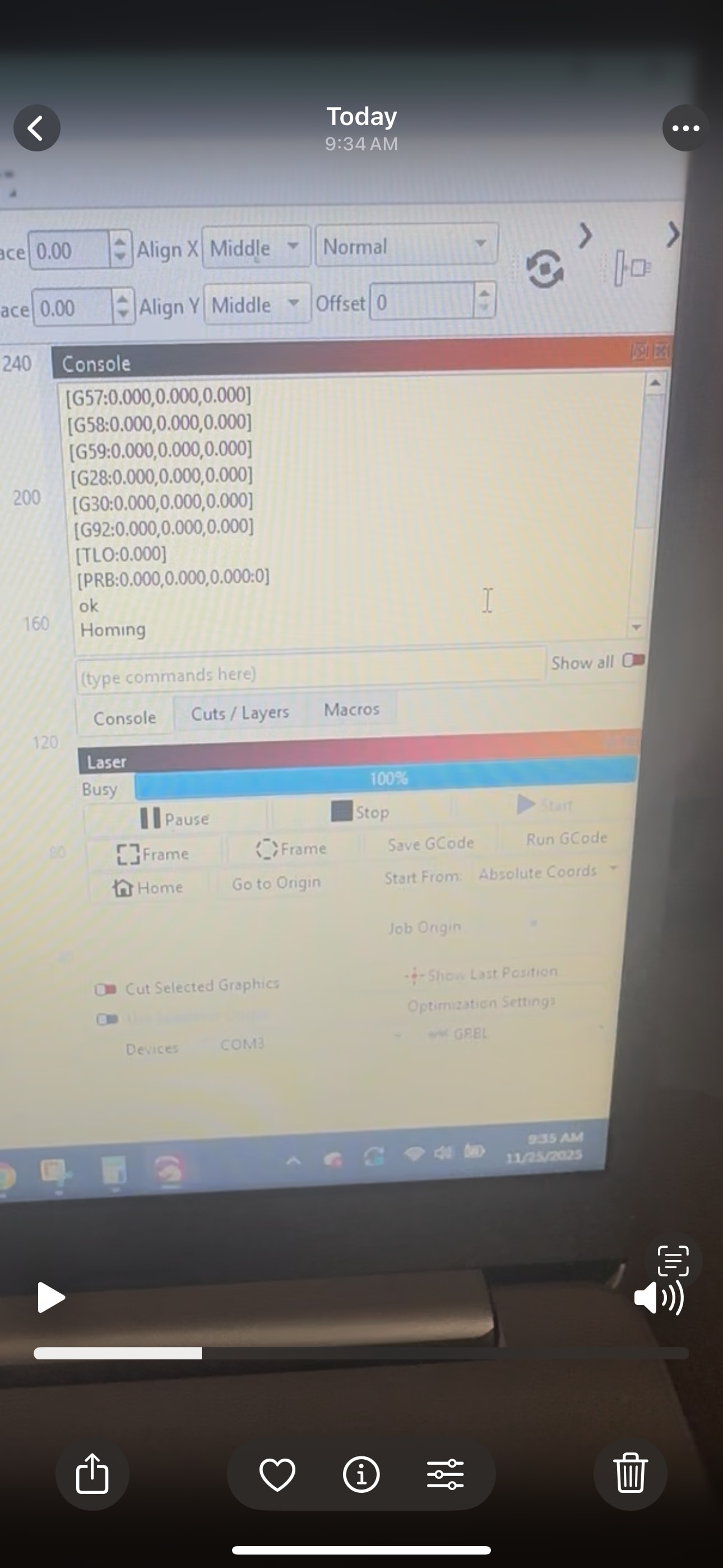

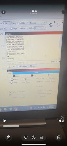

It homed without issue but these are the messages
Please use copy/paste from the Console window. Not everything in that window is showing, like the G54 settings. Also avoid camera shots of the screen because they are fuzzy and hard to read. Instead, use the Windows Snippy Tool (WinKey+SHFT+S) when capturing what is on your screen.
I cannot tell if it did or not. Withourt the entire Console window contents, I cannot tell.
In the Console window, right click and select Clear Console. Enter $$, which will list those parameters we talked about earlier. Now copy everything from the Console window and paste it in a Reply. Also confirm it did Home okay according to the information below.

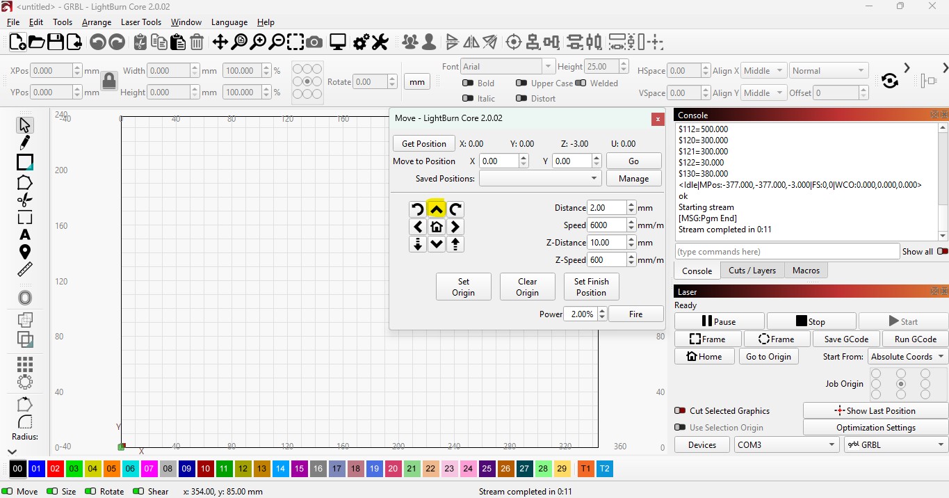

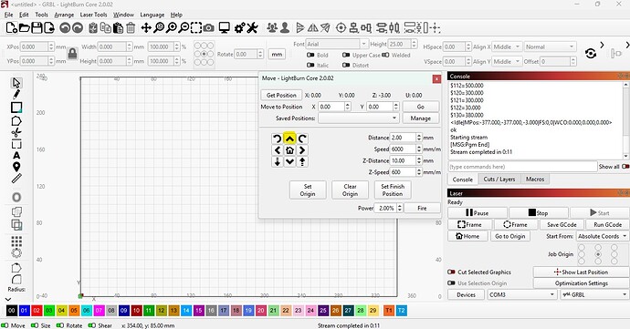

Then, I tried moving the laser back (see picture - arrow highlighted in yellow was pushed) and in one move move, at one push of that arrow the laser went all the way to the Right Rear Corner. Console message now reads:
$0=10
$1=255
$2=0
$3=0
$4=0
$5=0
$6=0
$10=1
$11=0.010
$12=0.002
$13=0
$20=0
$21=1
$22=1
$23=3
$24=25.000
$25=1000.000
$26=250
$27=3.000
$30=10000
$31=0
$32=0
$100=80.000
$101=80.000
$102=1600.000
$110=2000.000
$111=2000.000
$112=500.000
$120=300.000
$121=300.000
$122=30.000
$130=380.000
<Idle|MPos:-377.000,-377.000,-3.000|FS:0,0|WCO:0.000,0.000,0.000>
ok
Starting stream
[MSG:Pgm End]
Stream completed in 0:11
