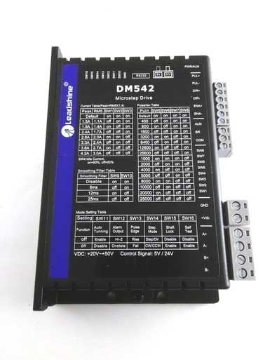

DM542 are easily available on amazon. I would grab a pair of those. I used those for my second cnc. Driving some bigger nema 23 at full 4a @ 48 volts. They are very smooth and run my steppers nice and cool.

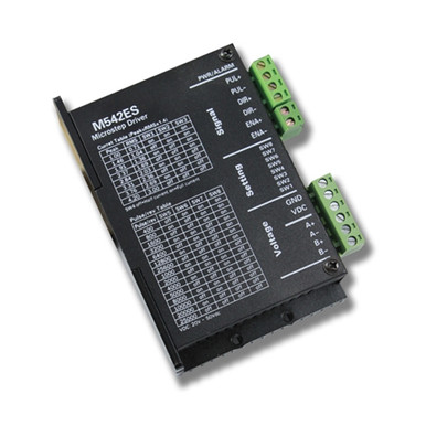

LightObject deals in laser hardware and has some DM542ES drivers in stock:
They should be a drop-in replacement for the DM545A you have now. The motor current set by SW1-SW3 will be slightly different, but that doesn’t matter.
Note that their seemingly identical DM542 (no suffix) is completely different:
