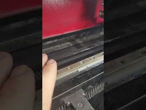

I sent you a video in a DM, yea the only way I see of tightening the belt it to pull on it, but I need another set of hands to hold the head still and tighten the bolts back down. I tried it by myself earlier and didn’t go well. When my son gets home I’ll get him to be my extra set. I’ve added pictures of both ends of my X gantry and the gantry itself. I dont see any way to tighten anything. On my Y axis belts there is a place to tighten, just not the X. I’m ordering new mirrors and belt, just got to ttake this one back off to measure. Are all mirrors the same or do I need measure those too?
The motor mount has slots for the four mounting screws with about two teeth worth of adjustment range:
  • Loosen those screws
  • Slide the motor toward the laser head to slacken the belt
  • Snug the belt at the clamps without overdoing it
  • Then shove the motor to tighten the belt
  • Hold the motor while tightening the screws
I’d be tempted to use my Designated Prydriver to lever the motor against the end of the linear bearing, but that may be getting entirely too primal. :person_shrugging:

I was thinking the same thing about trying to tighten it. Here is the link to video.
It’s hard to judge from here, but the Y looks fine and the X looks like tightening it by a tooth or two will get it done.
I’d go with loosening the motor, taking a tooth out at the clamp, then seeing how far the motor will slide.
