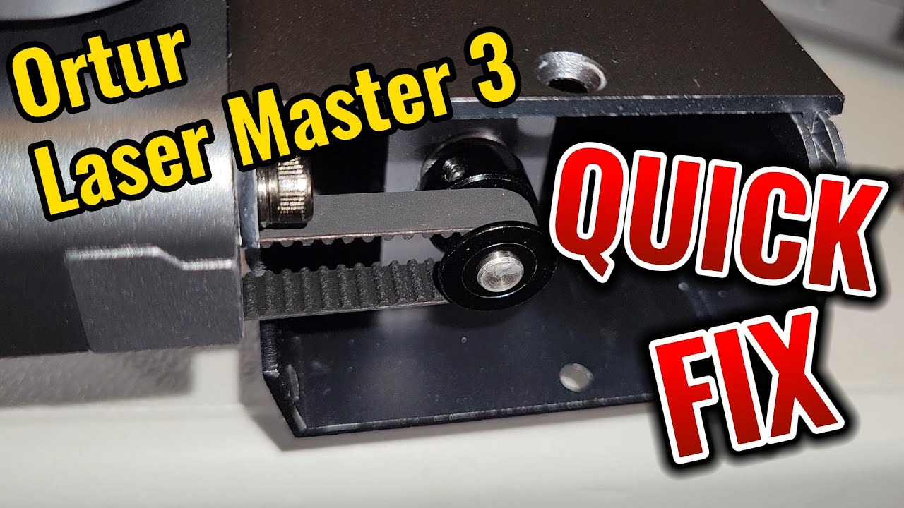

  • Recently installed the extension kit on my LM3
  • During installation, the original idler brackets broke
  • Ortur sent replacement idler brackets and screws
:warning: The Problem:
The replacement brackets are significantly different from the originals:
Old vs New Idler Brackets - Notice the size difference and missing tension markings
  • Larger and longer than the original brackets
  • Missing the tension marking indicators that were on the original brackets

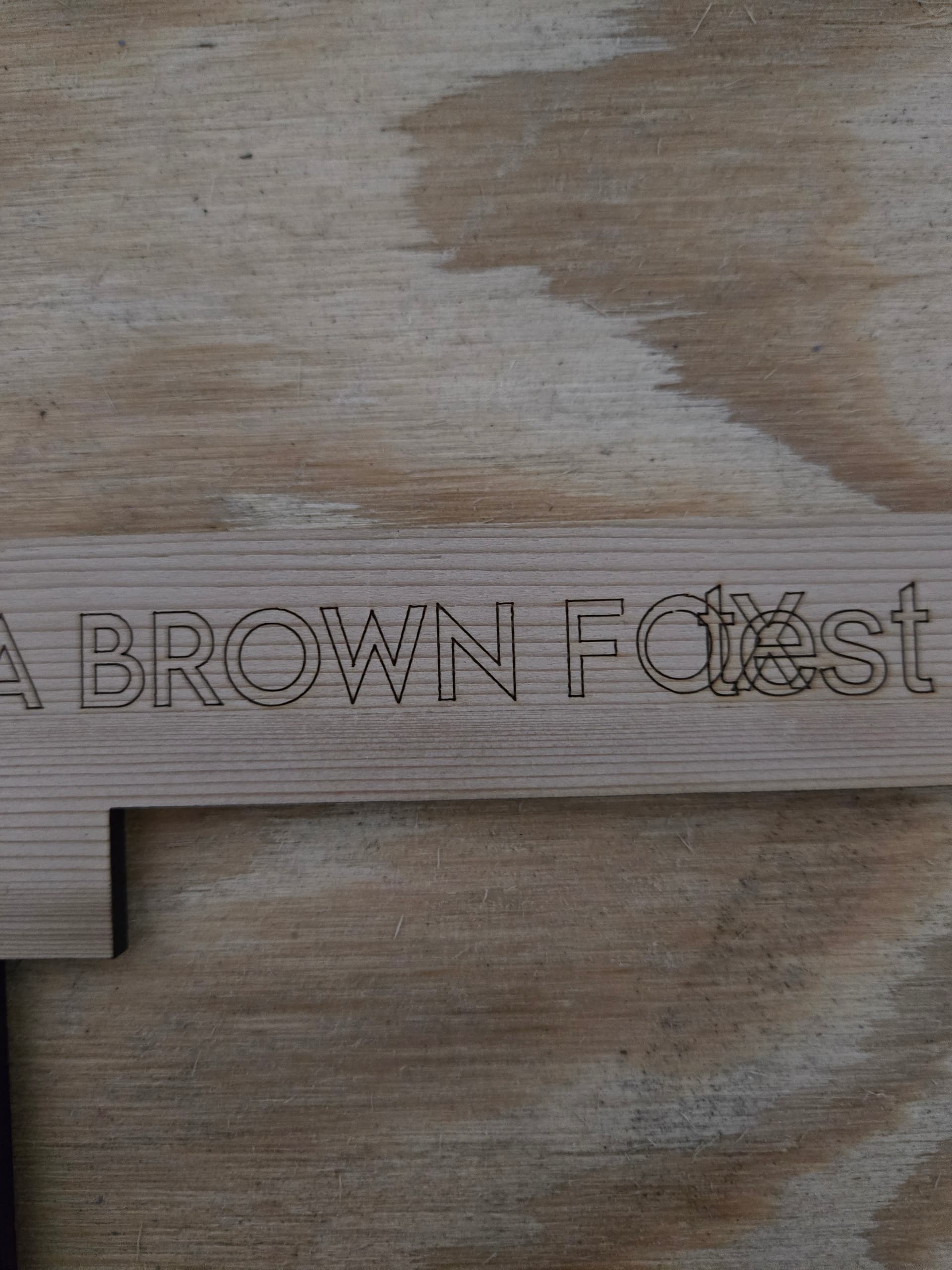

  • After installation, my X-axis no longer moves straight - it travels at a slight angle instead of true left-to-right movement

The engraving quality has degraded significantly:
Text engraving test - Notice the inconsistent letter quality and alignment issues
Additional text test showing “wonky” letter formation
Circle engraving test - Circles aren’t perfectly round, showing the X-axis alignment issue
Issues I’m seeing:
  • Text engravings come out inconsistent and “wonky”
  • Lines don’t align properly
  • Circles aren’t perfectly round
  • Overall engraving quality has degraded significantly

If the pulley is the same size, the size of the mounting should make no difference in the gantry tracking. It sounds like the belts are synchronized, in other words, the forst tooth of each belt is not the same distance from the frame.
Solution: Loosen the coupling to the shaft that goes across the gantry. Make sure the gantry is square, then tighten the coupling.
This is much too tight. It should just be snug with no slack. If you tilt the frame 45 degrees, does the gantry move under its own weight? This should also apply to the Xaxis.
Until you get the machine properly adjusted, use the test engravings to help you with the adjustments.

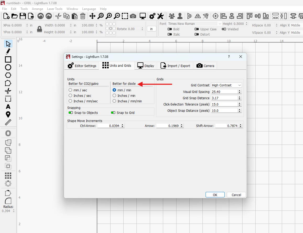

In your video, I noticed that your speed is set to millimeters per second. For a diode laser, it’s best to set the speed to millimeters per minute. You can adjust this in the device settings.
Unless you have a 70w diode, 200mm/s is too fast to engrave. That is 12,000mm/m at 30% power. My 20w laser burns good at 3000mm/m and 30% power.

And one more thing, switch to mm/m like @Woodcraft said.

Speed Settings :white_check_mark:
Woodcraft said:
“In your video, I noticed that your speed is set to millimeters per second. For a diode laser, it’s best to set the speed to millimeters per minute. You can adjust this in the device settings.”
Done! Thanks for that tip!

I have a laser guy I used to pay for all my laser jobs before I got this. I’ll throw it away, and when I ready I’ll drop $5k on a co2 laser. I’m done messing with this one. In the garbage it goes. I appreciate your help!
We really are not close to being done. We’ve made no progress. Lol I work long hours, and I’m done messing with it. I looked up technicians, they don’t exist anywhere I can find. And no amount of money will get anyone on the phone for tech support, I can’t send it anywhere, the company is in China and unreachable. It was a mistake to buy this thing, I’m throwing it away and going back to my laser guy to do the jobs for me. I’ll buy a better one later. I’ll save time and money paying my laser guy for the stuff I need done. Novody is going to give me any help with this thing. There’s no shops I can take it to to get fixed, no technicians will come fix it, it’s more hassle than what it’s worth. This thing literally cost $800. Who cares… I’ll just throw it out. I appreciate your help, but it’s cheap junk. I should have spent $5k on a co2 laser. Lesson learned.
Even a Zoom would not work well for this. You would need someone on site. I understand you do not have the time to (don’t want to) mess with it.
Don’t toss it. You should be able to get $400 for it.
