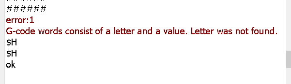

Launch Lightburn, let the machine HOME (or Home it), then open the Console window.
Next to the text box is Show all. Click on the button to make it green.
Now enter in the text box $H, then copy/paste the results from the window here.
Are your Home switches mechanical (with a lever) or sensor type?
oddly enough $H doesnt return anything useful (the maachine homed when i hit enter on $H).

Not supposed to, the Ok was the useful response. It means GRBL thinks the machine completed the homing cycle.
Now we have what we are looking for. In the Console window, enter $I, then $#, and then $G and paste the redults here.
