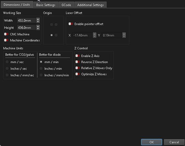

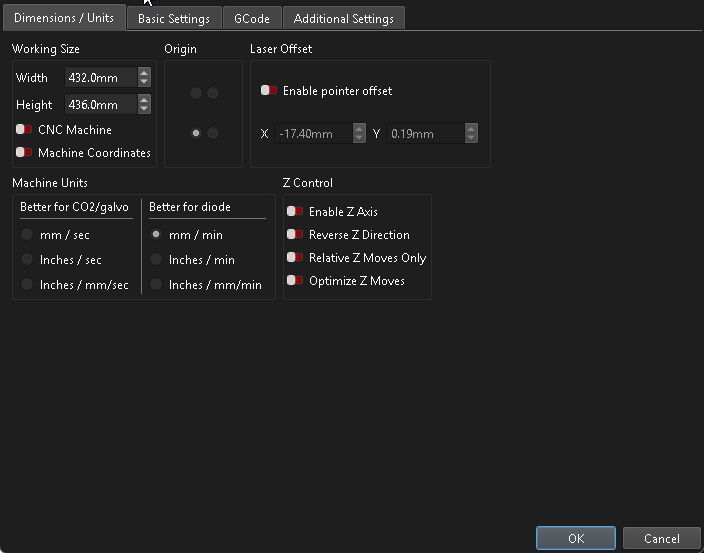

I found the cross hair alignment was off, it was (X) -16.00MM and (Y) 0.00mm, but I had to set it to (X) -17.40MM and (Y) +0.19mm.

And before you ask, yes I am using the file LightBurn configuration file provided by xTool, (xTool-D1-V2.lbdev.)

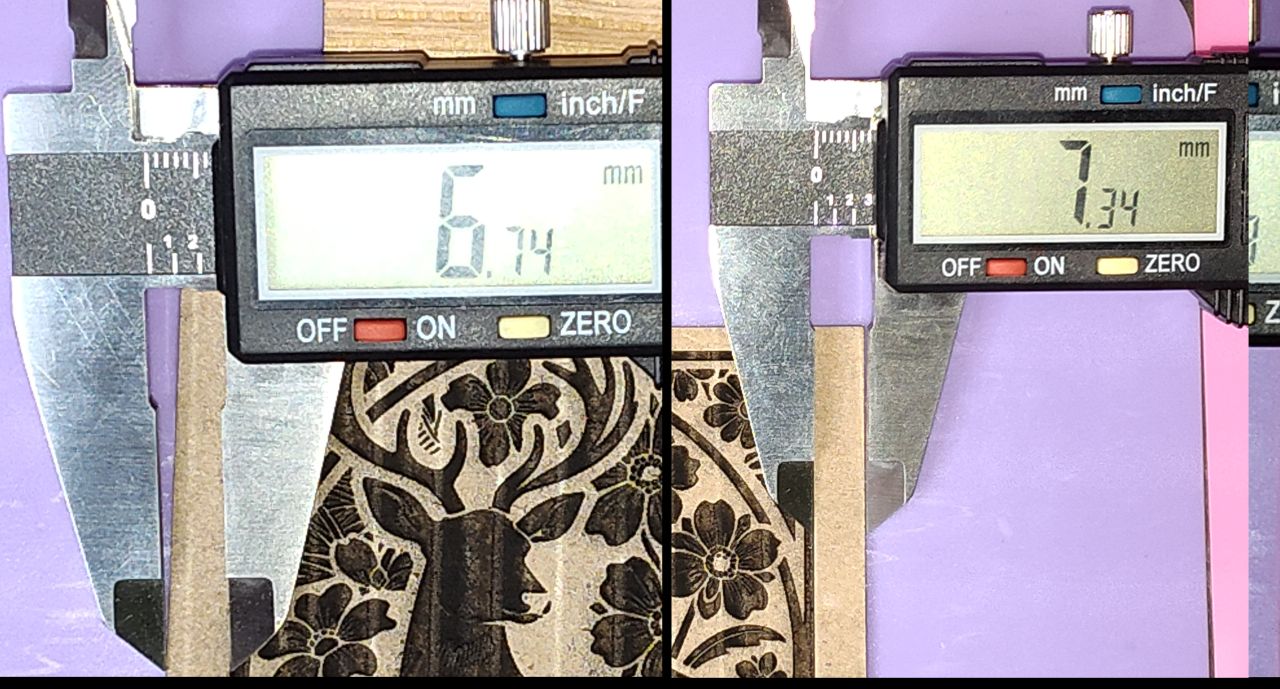

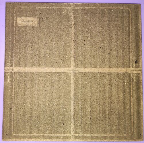

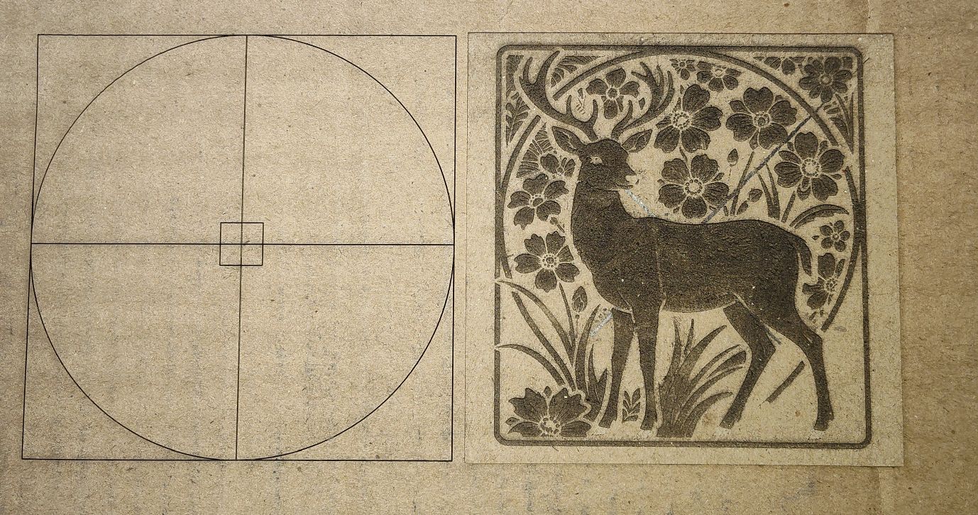

Here is a test pattern that I used to test the cross hair, and here is a 100mm x 100mm image engraved onto a 100mm x 100mm cut out piece of cardboard, the deer and border are perfectly in the center of the image, the image was inverted for engraving on the cardboard, but when engraving it always gets shifted, it a small amount but it’s noticeable when you have an image with a border
Without a scale for reference, I cannot see that 2mm shift. Your crosshair test is not very vigorous, but I see no mechanical backlash issue. So let us look elsewhere.

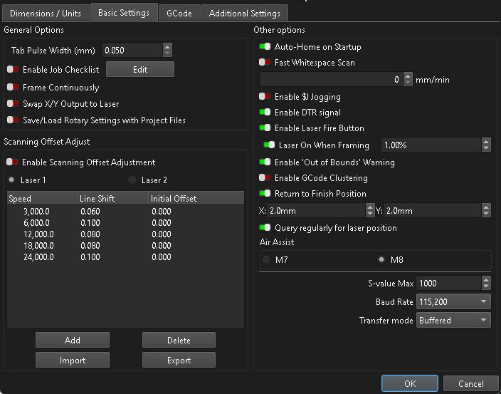

Is there a chance you have a non-zero crosshair offset or scan compensation?

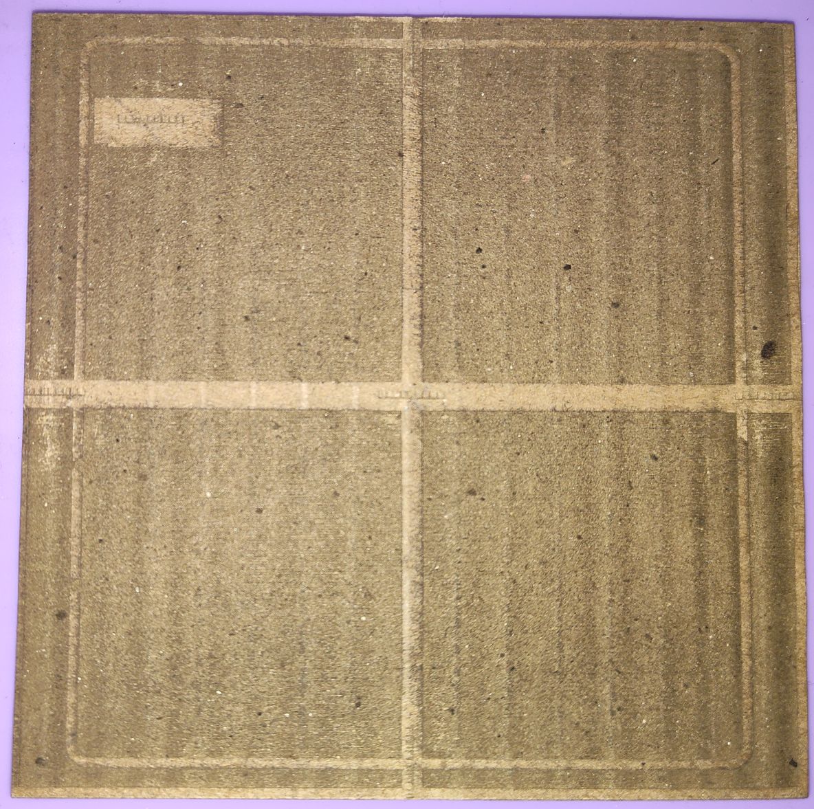

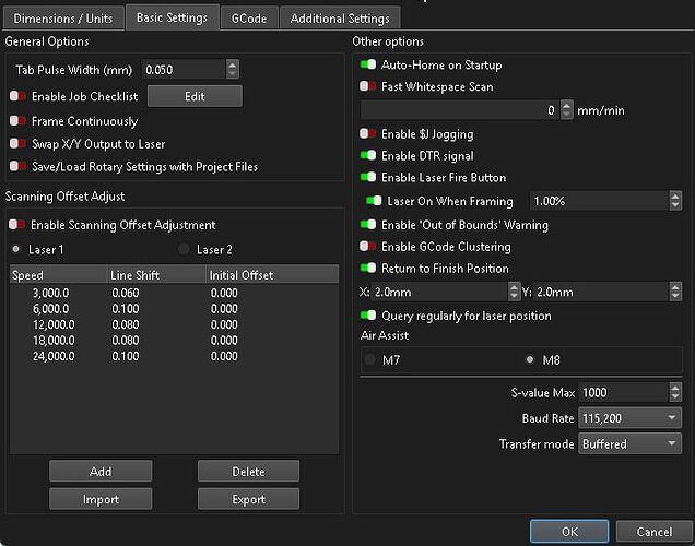

I use the “Scanning Offset Adjustment” settings that were in the file from xTool, for “Overscanning” I tried 2.5% and 5%, it’s at 5% now in Lightburn, the cross hair was off from the factory, but I have adjusted for that in Lightburn, however the image will still be shifted even when using the main laser to find the starting point, here is an image of an engrave I made on cardboard, the image was not inverted this time, I removed the deer, but left the outline that was around the deer, and added a white border that runs around the edge of the image, I also added some very fine measurement marks to the edges that unfortunately did not show up very well, and added a cross threw the center of the image, the engraving is missing most of the white border on the top and the left.
When you say “missing the border”, are you saying it is not engraving?
Honestly, I am not seeing a problen, except possibly where the top left area is somewhat more faint. I am viewing your images on my tablet where I can zoom about 10x.

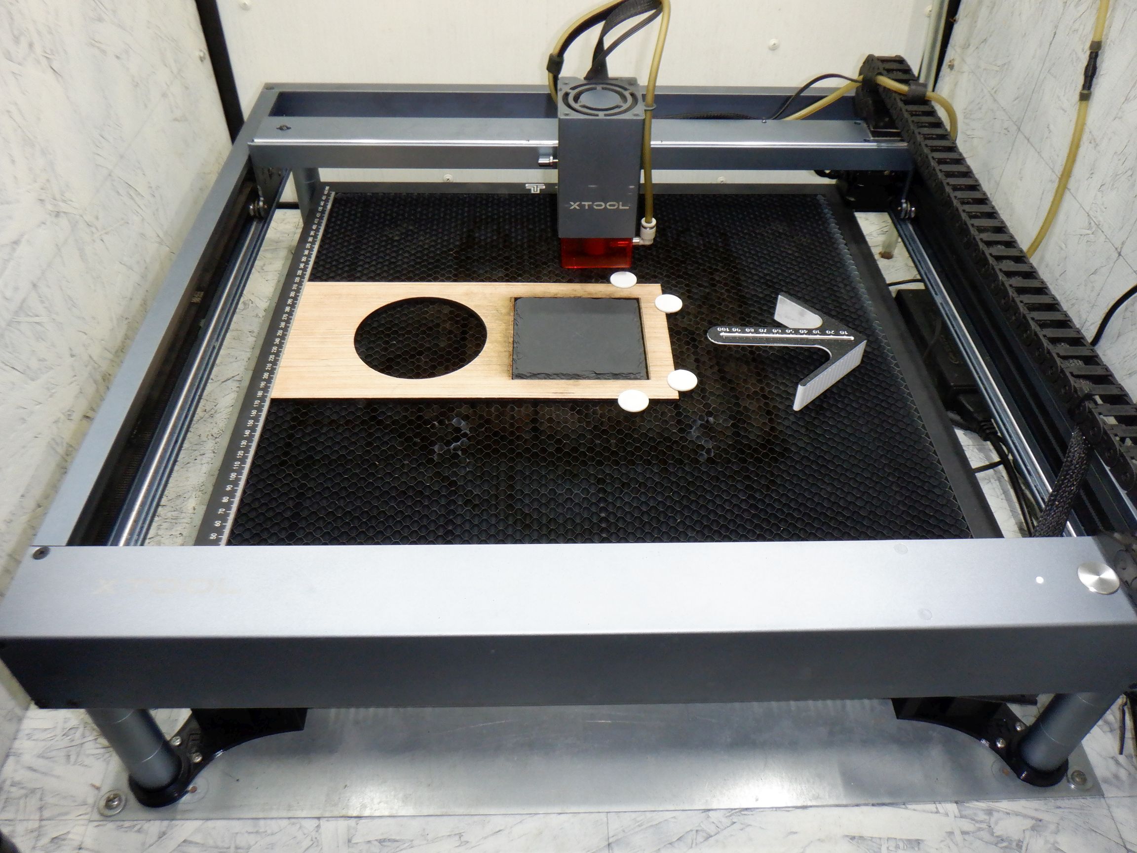

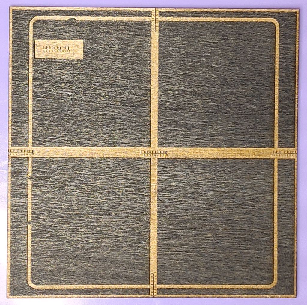

I was able to do a bit better, I started with a piece of 3mm plywood painted black, I cut a 100mm square into it, and without moving anything, I then burned a 100mm square test image in the same place has the 100mm square cut-out , I then checked the test image, it looked just fine and was centered correctly,
I removed the 100mm test square without moving the the laser, or the rest of the wood, I used tape to pick up the test image cut out, I used a center finder to mark the center of a pre-cut 100mm cardboard square, I then placed the 100mm cardboard square into the square hole left by the test cut-out and tried the regular image, and yea, it’s still a bit shifted over, but only by just small bit.

Half a millimeter could be the play in the cardboard, unless it was a press fit. I have removed and replaced square wood in my honeycomb, which has guide rails I attached, and still see a slight difference on the reburn. Unless you do not touch it, there is always the chance of not getting it exactly right when you put it back.

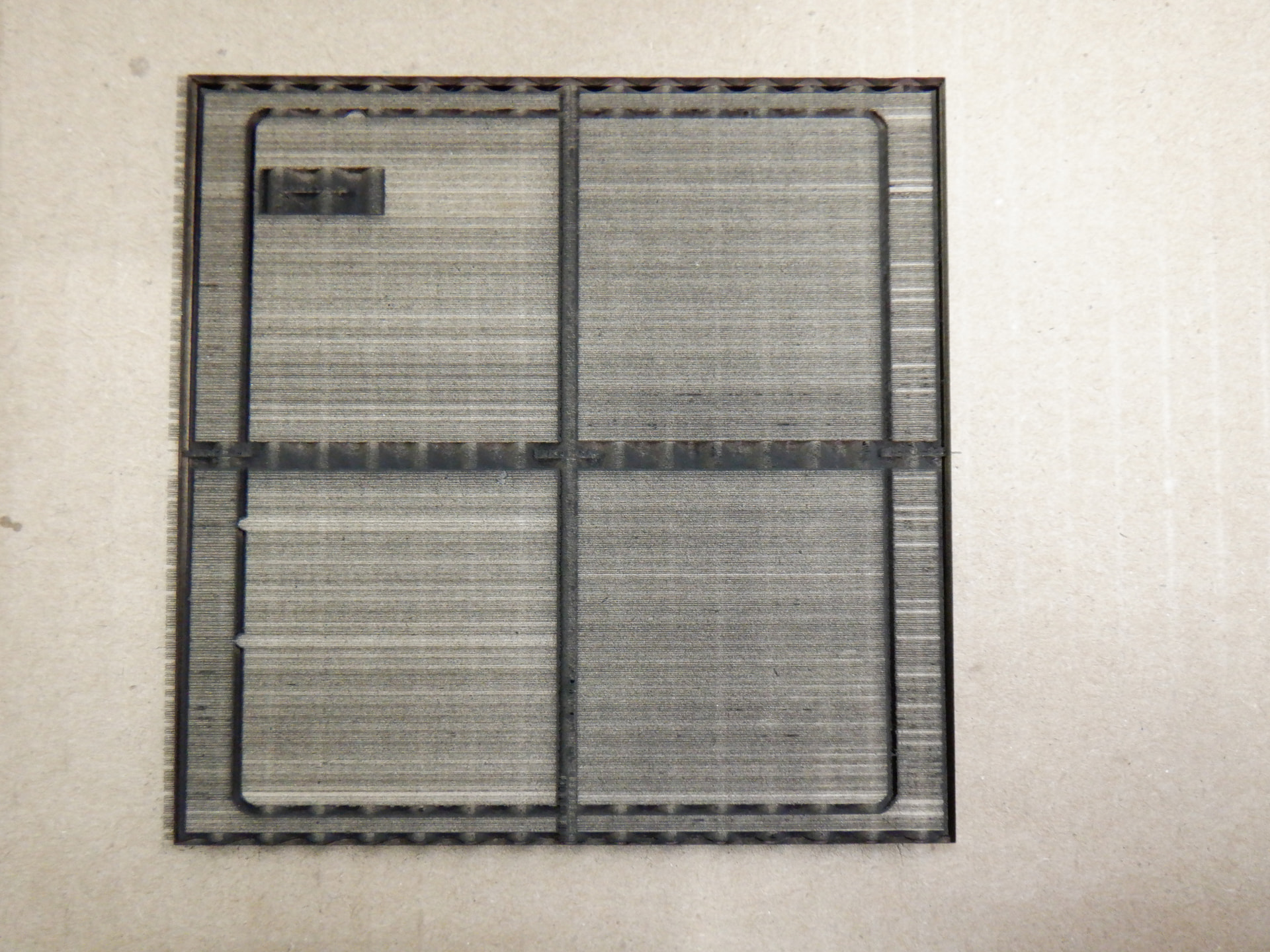

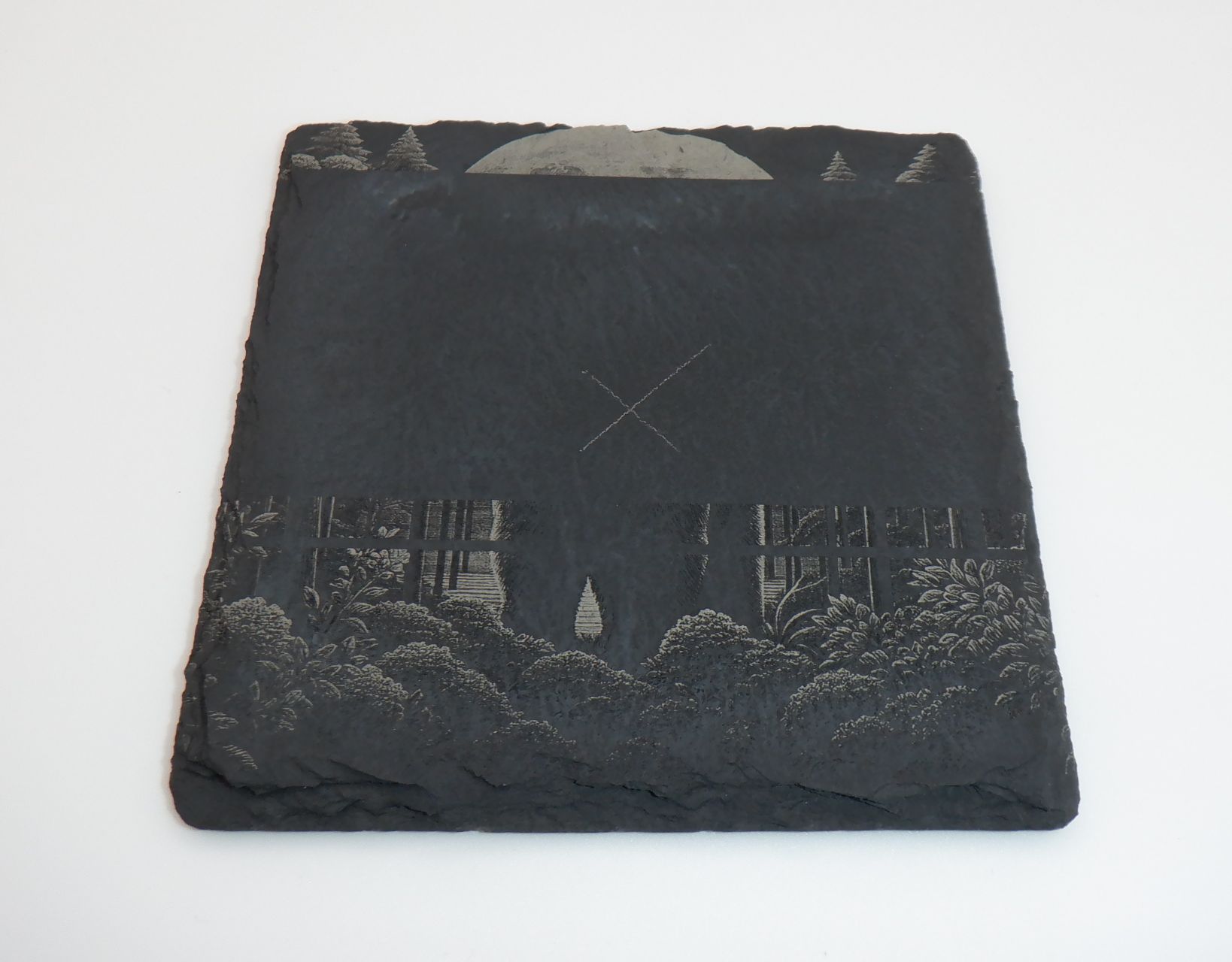

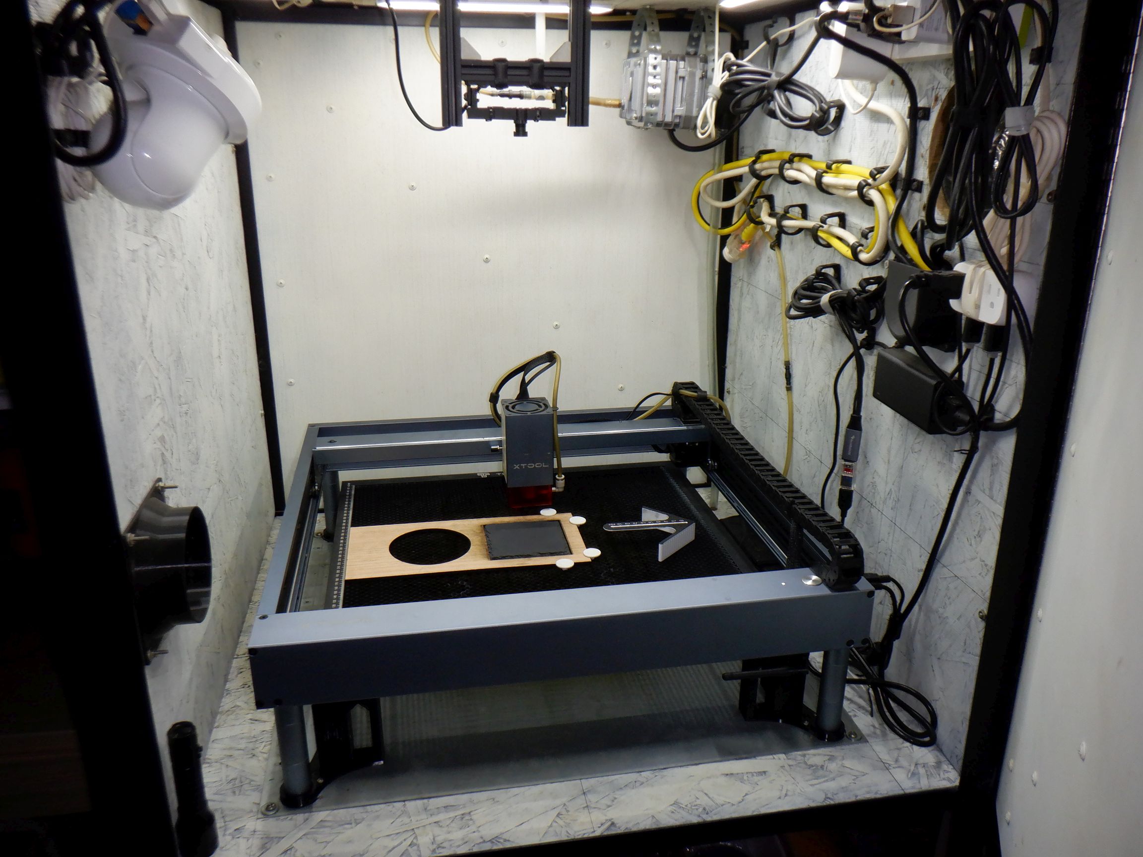

It was working “acceptably” even with a slight shift when engraving images, but now today it did this:
the pencil mark X is were the center if the tile is, not sure what happened, I have the xTool D1 in a home-made vented enclosure with a camera, and was watching it, it seemed like it was working just fine, was not acting different, was not making noise, and was in the center of the work bed, but when I went to see the finished work, this is what I found.
I have a 3D printed set of parts that keeps the honeycomb bed raised and centered, the 3D printed parts are screwed into the surface they set on, right now I use a simple jig to place slate coaster into, the jig it pushed to one side of the jig and then held down to the honeycomb bed with 3D printed pins, this seems to work well for me, but something has been “off”.
I take my images and resize them to 100mm in size, I also set them to 300DPI, and save them has PNG files, I then import them into LightBurn, and then set “Adjust Image” to the "Basic"preset, set the image to be “Negative”, and make sure the engrave is set to “Grayscale”, I also slightly over size the image to 103% because of the image shifting problem, and I avoid using images with borders, I have a 100mm square in the center of the work area, and I have a few images to the right and left of the work space that I drag onto the 100mm square before using the laser, I start from “User Origin” and have the “Job Origin” in the center of my work area, my laser is set to 3000mm/m and 25% power for slate, and 5% minimum power, I mark the slate coaster in it’s center using a center finder and pencil, place a slate coaster in the jig, I line up the laser cross hair with the mark I made on the coaster, and I tell LightBurn to start.
  1. The only thing I can think of is, do you have the honeycomb secured to to the 3Dd printed pieces? I could not see the back pieces, but I assume they match the front ones.
  2. That image with the “X” looks like the laser was just not on during that time. The top part does not fit the bottom part, so it was not a slippage (backlash) issue. Check the wiring and connectors.
I took the laser head off the gantry, with xTool powered up, moved it around a shook it a bit, and the cross hair never flickered or went out, I checked the wires on the back of the laser head, they were pushed in all the way, I put the laser head back on the gantry and moved it all around by hand, the cross hair never flickered or went out, well, it’s ether the controller acting strange, or there is a wire or connector that has a break in it, I have some extra wires, I guess I need to try swapping them out, has a last resort I have a “Devil1 Lobotomy Kit” that I never got around to installing years ago.
Yea the honeycomb bed just fits tight into the 3D printed parts with no wiggle room.

The problem with a barely broke wire is it is hard to pin down. Sometimes, a slight pull on the wire will open it up enough to be the obvious problem. Look for places where the wire has a sharp bend in it, or near the anchor points.
You can test by running a zig-zag pattern in both directions. Run at higher speed and with the laser power minimum or off.

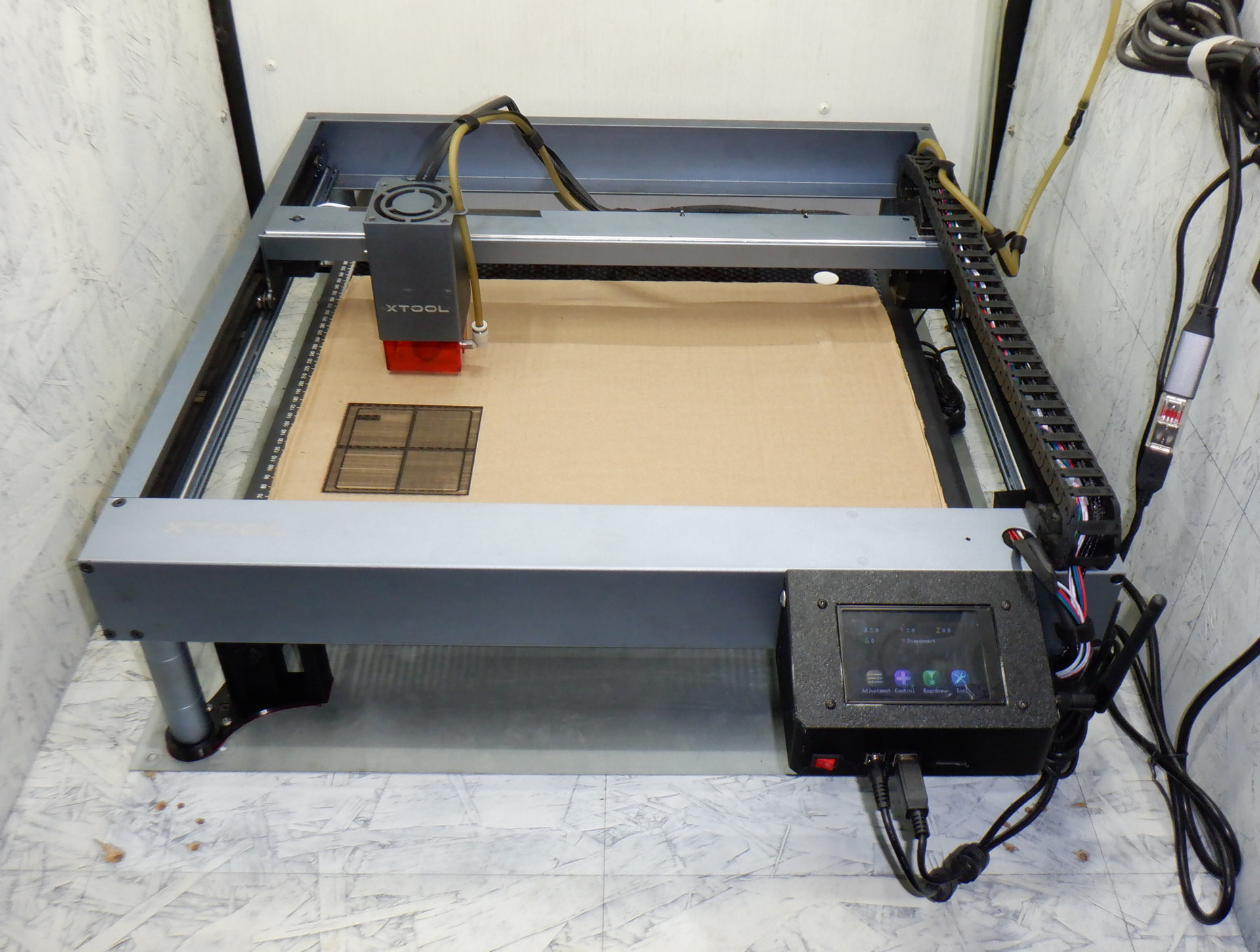

The Devil1 Lobotomy Kit was a controller replacement for the xTool D1 and D1 pro, it was sold by a seller on Etsy called “Geeks at Large”, the controler came with all the wires you would need, had a nice control screen, and my unit came with two limit switches, later versions came with a nicer case and 4 limit switches, the version I have uses a MK2 DLC32 v2.1 control board.
Indeed! I am sure it is 100% Lightburn GRBL compatible too. Too bad it is showing Out of Stock.
I spent all day installing the Devil1 Lobotomy Kit.
I then ran a test, but it did not turn out very well, however the cutting went well, I still seem to have some shifting.
I replaced all the wires, and electronics, the only thing left is the laser head and the frame.

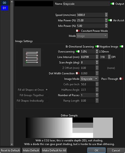

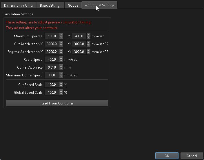

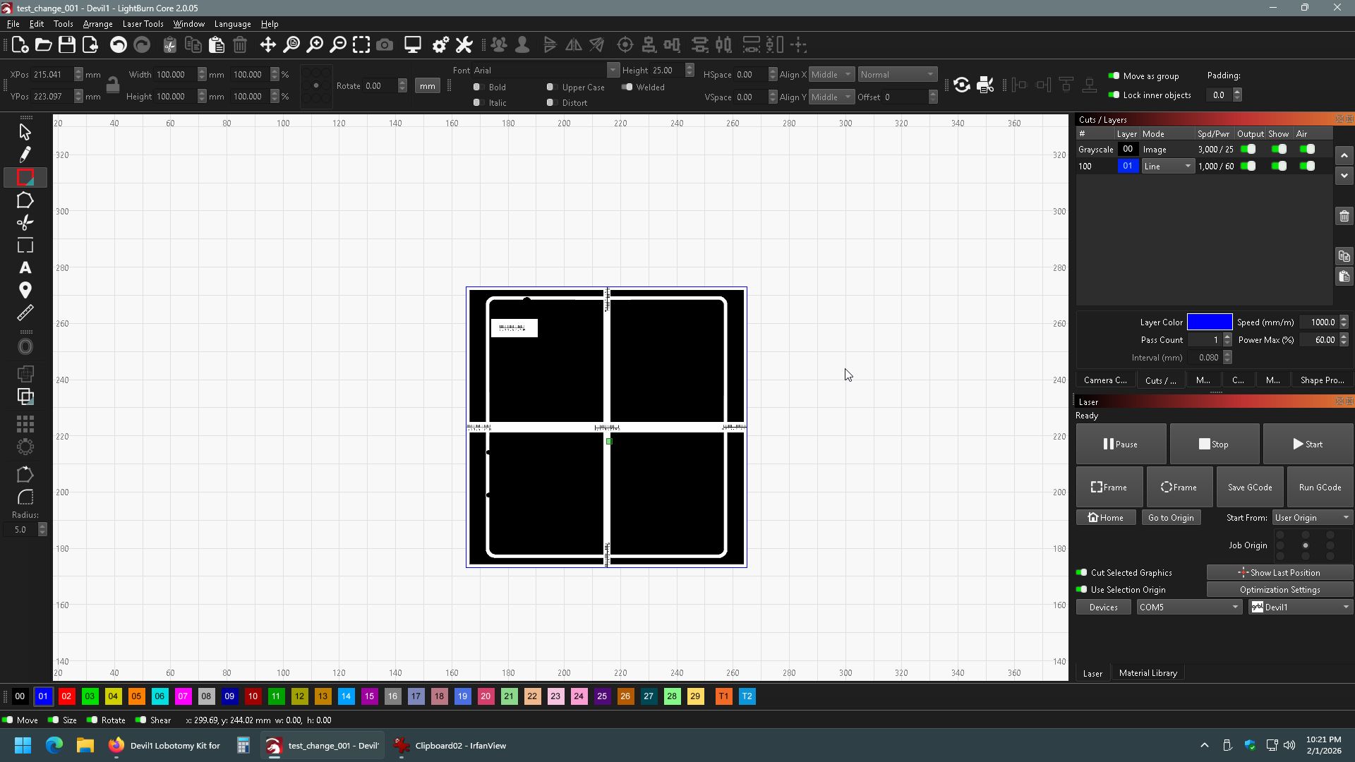

Here is my LightBurn screen.

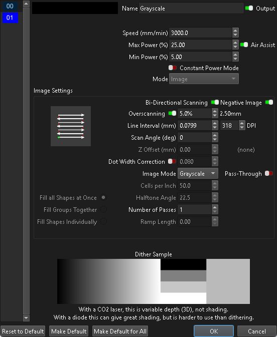

Here are the LightBurn Image engraving settings.

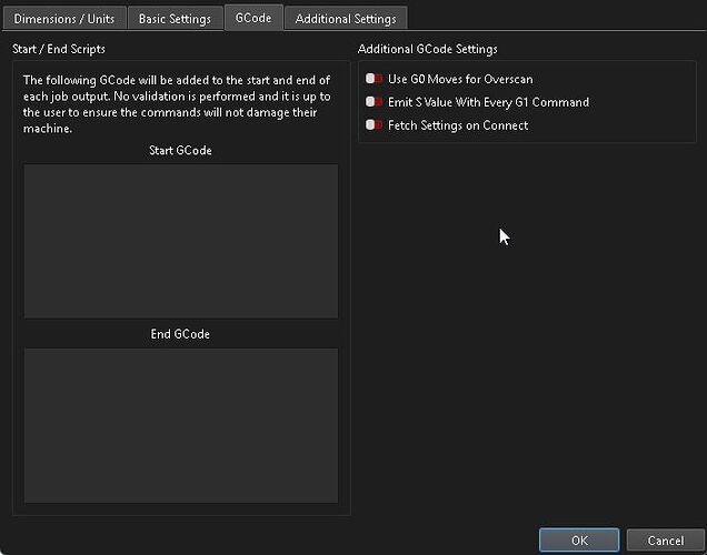

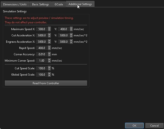

Here are the setting for the Devil1 Lobotomy Kit.
And here is the log.
