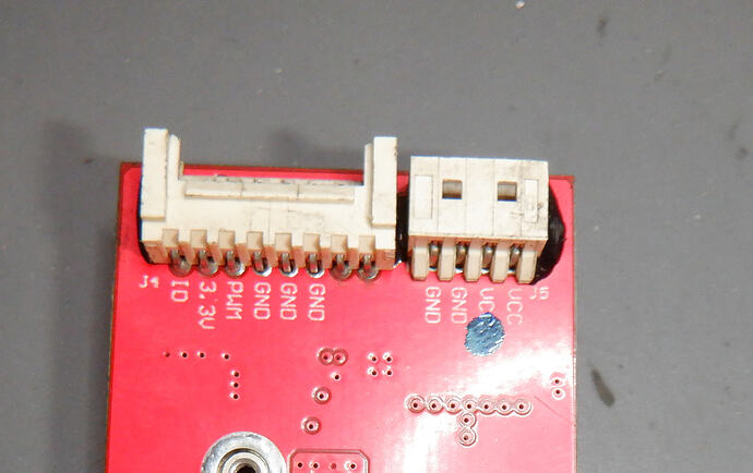

On a second note, I found a way to get the cross hair back, but it’s not for people that lack basic electrons skills, took off the laser head and looked it over with a volt meter, it looks like the xTool control board was just sending 3.3v power to a wire running to the laser head for the cross hair, and the Devil1 Lobotomy Kit I have is missing that wire and also missing a ground wire, so I added them, and then I used a cheap LM2596 DC to DC Buck Converter to convert 5v into 3.3v for the cross hair and it works.
It’d probably run fine on 5 V, but … yeah, don’t unnecessarily disturb the dragon.

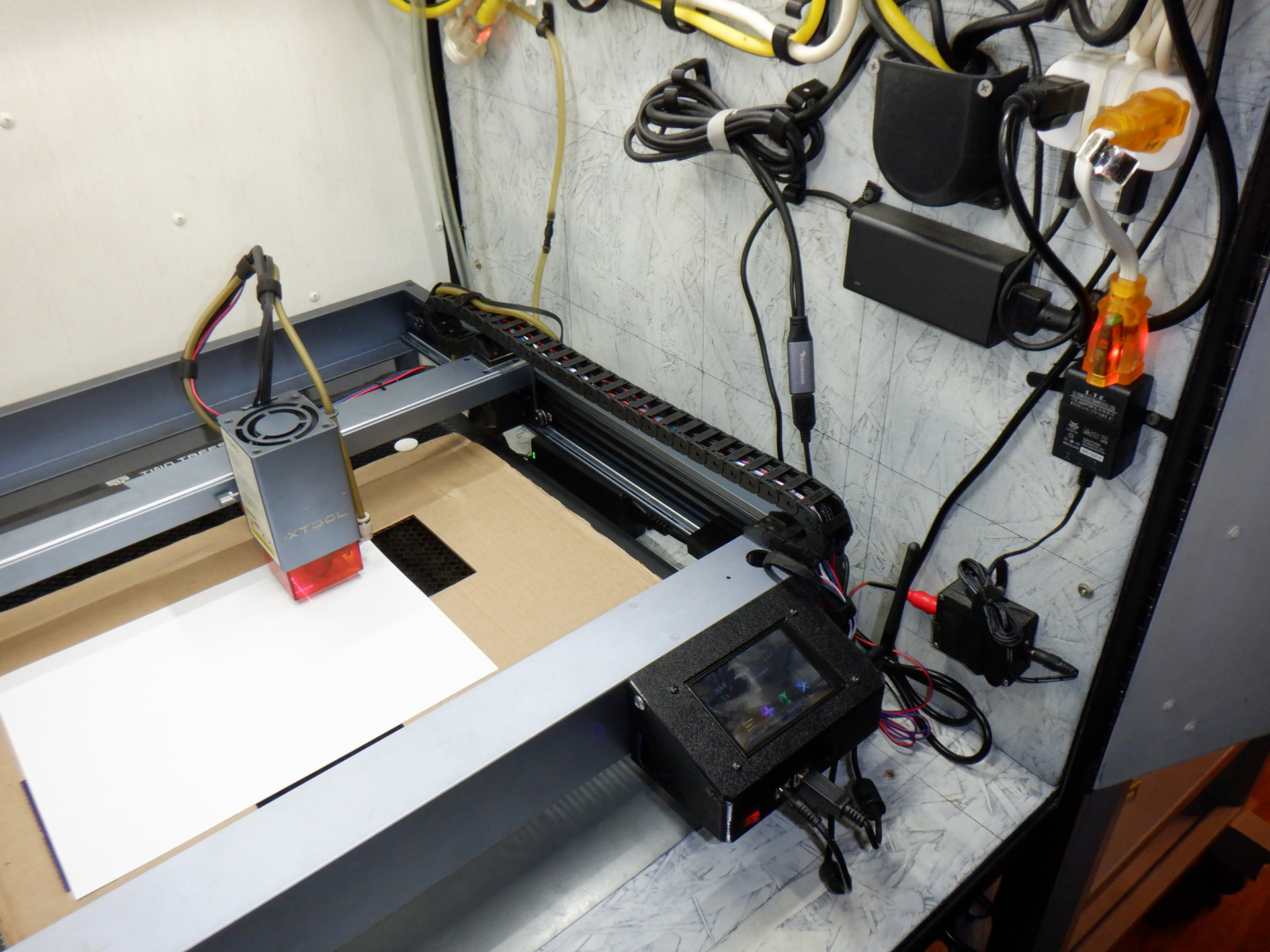

The enclosure looks great! :grin:
I made the enclosure when I first got the xTool D1, I did not want to mess my eyes up and I wanted to vent the smoke, I had also bought some safety glasses rated for the xTool’s 20W laser, that was one of the reasons I wanted the cross hair, I wanted to aim the laser with it off.

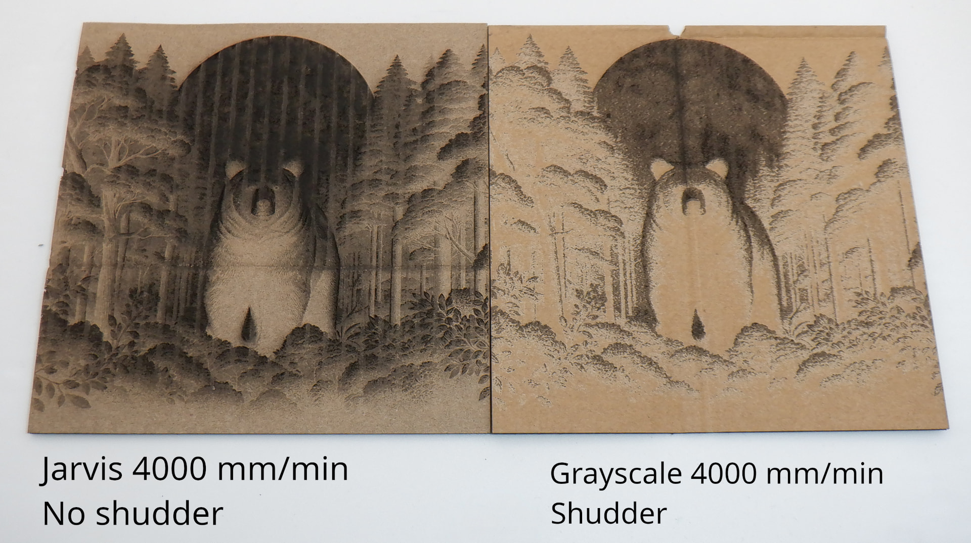

I gave this laser one last try, I basically ran a bunch of test engravings, one image that was a simple black and white image with very few small details was able to be engraved at 9800 mm/min, however a more detailed image caused the laser to shudder until I dropped the speed down to 4000 mm/min, that being said, this time I used “Jarvis” in place of “Grayscale”.
Before this all started, I was only using “Grayscale” and engraving at 3000 mm/min, so my thinking is that something changed on the computer, it was not the laser, and I am leaning to a driver issue, my thought is that a “Windows Update” changed a driver or a driver setting, and that slowed down the data throughput to the laser, now I have to fix it, because it will likely mess with the new laser in the same way.

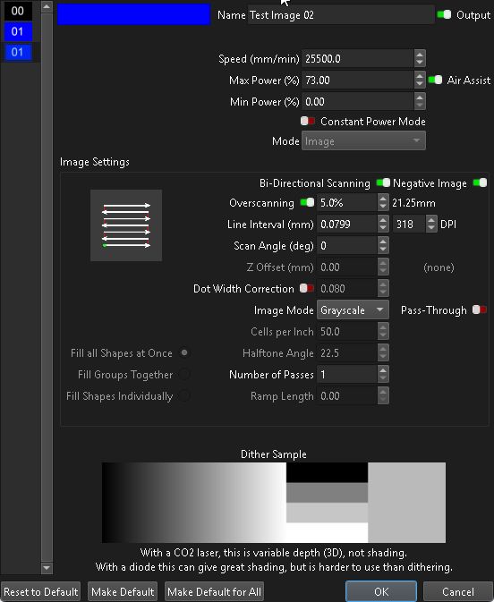

He is an image from one of my tests, both were engraved on cardboard from used shipping boxes, the engrave on both was done at 4000 mm/min, power was at 25%, overscan was at 5%, Line interval was 0.0799 and 318DPI, and both images were processed in the same way inside Lightburn, however the one on the left was using “Jarvis”, and the one on the right was using “Grayscale”, the one using “Grayscale” made the laser shudder, and it seemed like the laser had less power, the test image using “Jarvis” worked just fine and the laser went smooth like butter, yea, something is not right.
BTW today I removed the Windows installed CH340/CH341 USB to serial port driver and installed the driver from over at https://www.wch-ic.com/downloads/CH341SER_ZIP.html, they are the people that made the CH340/CH341 chips, I had hoped this would help, but it did not.
Ah!
A Grayscale image sends a torrent of data compared to dithered images. In round numbers, it’s one byte per pixel, rather than eight pixels per byte.
Running a Grayscale image with a small Line Interval can overrun the maximum speed of the USB connection, causing the controller to stall until the next chunk of data arrives.
If you must use Grayscale, a larger Line Interval will reduce the data and prevent stalling.

That combination tells you the maximum data rate the controller can handle.
Assuming G-Code Clustering is available for the XTool and is enabled, then the maximum data rate the controller can handle is about:
220 pixel/s = 1300 mm/min × 1 min/60 s × 10 pixel/mm
If clustering isn’t turned on, enabling it will produce a dramatic performance improvement by reducing the amount of data per pixel.

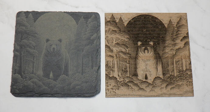

So next I tried using an old laptop that was running Windows 11, I installed LightBurn on it, and copied over all the same files and setting from from the desktop PC I was using LightBurn with, then tried the same 3000 mm/min and “Grayscale” settings from before all this started, and it still shuddered, next I tried connecting the laptop to the laser directly with a different cable, and yep, still shuddered, so it’s not the computer hardware, and not the USB cable.
I got the PCI Express USB 2.0 Card in today and installed it, I then ran a test with my retrofired xTool D1, here is what happened:
The cardboard was done at 3000 mm/min grayscale, just like I had been using before the laser started messing up, and the slate coaster was done at 2500 mm/min grayscale, I slowed it down just a bit, to try and prevent any problems, with both speeds the laser shuddered a bit, but no ware near what I was getting with the USB 3.0 ports, yea, I am starting to think Windows 11 is the problem.
Its hard to tell, but I do think the quality is a bit less than what I had before, but that might be because of all the changes in settings I was trying, not sure.

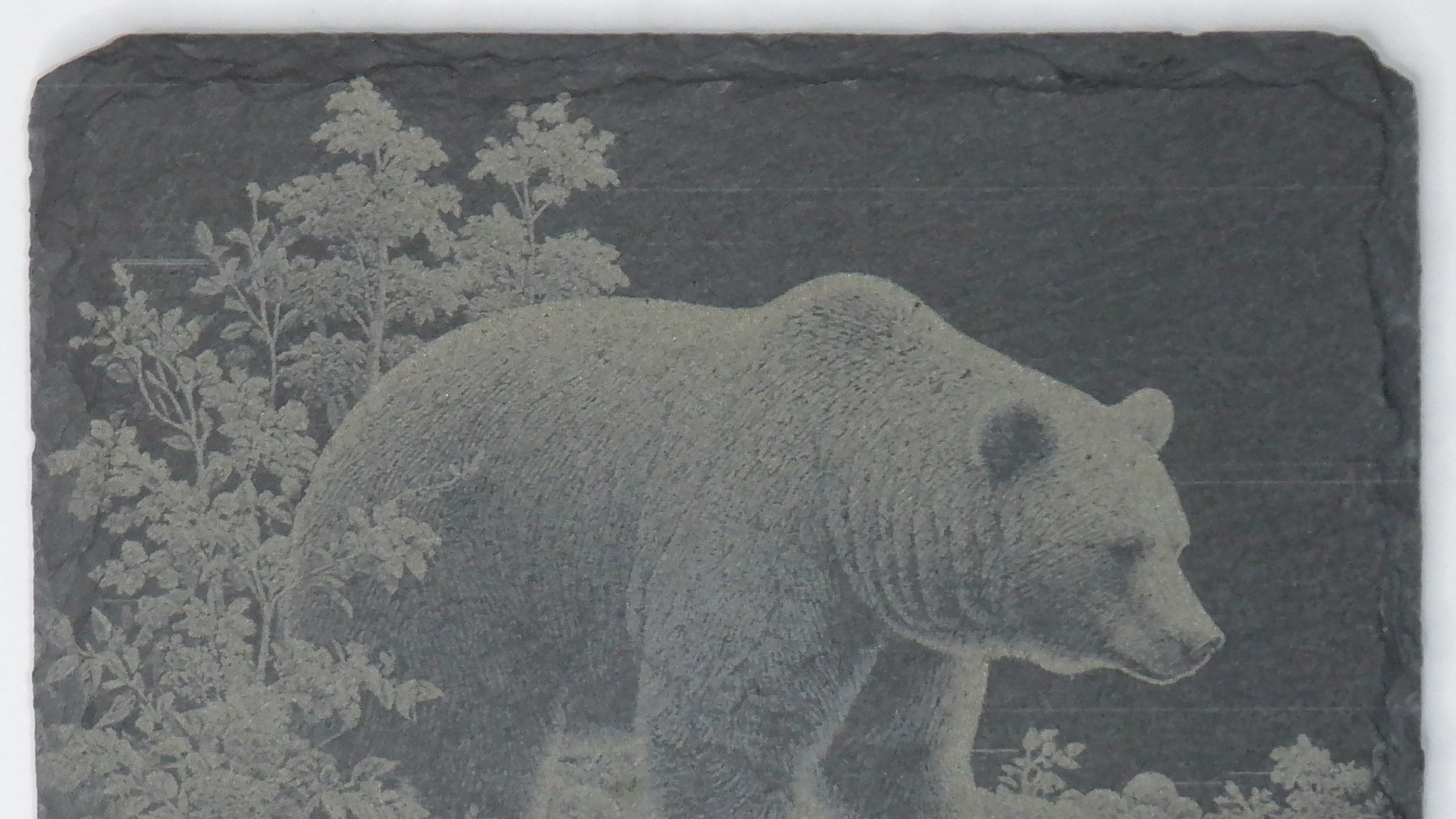

I tried to do a slate coaster set, and on my forth coaster I noticed lines going from left to right that were not part of the image engraved, here iswhat that looked like:
The lines are sometimes faint, but you can see them on the black background of the slate, if it’s not one problem, its another.
