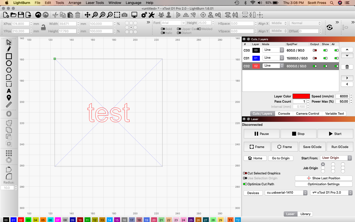

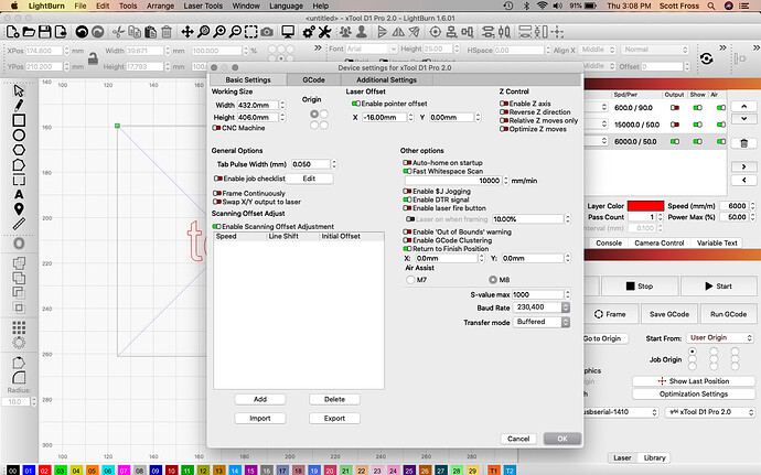

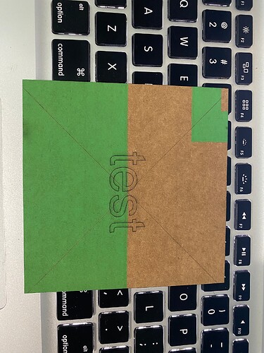

Hi everyone and thanks for taking the time. Im a newer laser user, only been doing it for a few months now. As the title suggests, my laser is off center. Everything was fine until a couple of weeks ago. I had some templates set up and everything was engraving/scoring spot on, but now everything is 3-4mm to the right. This only happens when i have artwork on a specific space, coaster, cutting board, etc. This does not happen when I engrave/score and cut out the project, everything is fine when I do that. I have been reading some forums and saw about laser offset settings have been the culprit in others’ issues similar to mine. I use the offset because I use the crosshair to frame everything. I tried turning off the offset and it still did the same thing. I ran a test on a piece a cardboard checking center and saw the as the job started, the laser actually moved the 3-4mm distance before it started scoring instead of start location it should have. I have included a pic and some screenshots. Any push in the right direction is greatly appreciated. Thank you!

I have a grid burned into a board that matches a tool layer in Lightburn. Before this started happening, I would just take a coaster, for instance, and lay it in the spot I burned for them on the board and then set my artwork in the tool layer and hit start. Always centered perfectly. Then all of a sudden, using the same method, everything constantly burns right of center. Even when i try to do a single using user origin, I will frame it perfectly with the crosshair and I get the same result. It seems like a setting I’ve messed up. I reset all the setting and I still get the same result. You can bank on it,.
You didn´t setup your laser importing the device settings file.
Create a new device by importing the .lbdev file and check again.
Thanks for the suggestion, I hadn’t don’t that. It, unfortunately, gave the exact same result, right of center. I have lightburn on 2 different machines, a macbook pro and a windows desktop. I get the exact same result with both computers.

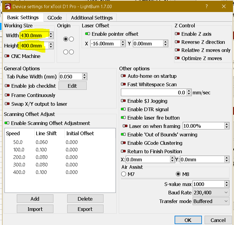

Check if your settings are like the below ones.
Bed size 430x400 and not 432x406.
Yes its 430mm x 400mm
I still have not found a solution unfortunately.

As a start you have to go to XCS and change $130=430 and $131=400
I believe you have to click a switch in XCS to be able to write to controller.
