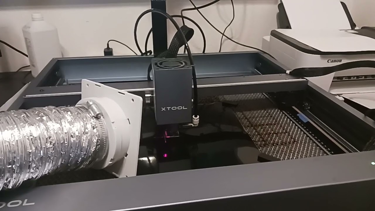

I place the head in the top left hand corner.
I turn the machine on.
I press “get position” in Lightburn (I have also tried pressing “set origin”) and the software shows 0,0.
I move the head around either using the software arrows or by manually grabbing the head and moving it to a new position.
When I press “Home” or “Return to Origin”, the head does go back, but it continues past the point where I set it and keeps trying for a few seconds to go further, and is banging against the top because of that.
Is there something I missed on setting the Home?

When I first bought my XToolPro 20 watt, and pressed “home” on light burn, it went back, hit the rear bar and there was a loud crashing of gears. Inspection showed that the sensor (the metal bracket) was in an incorrect position, so it could not be sensed. As a temporary fix, I undid the two tiny bolts, and moved it, so it is now just held with one bolt.
So, now it usually, but not always homes OK (but occasionally it beeps and reports a hard stop).
I am putting up with this.
So when I am cutting, I do a “home”, then a “frame” and then I make my cut. That is usually OK.
But annoyingly, at the end of the cut, when it homes itself, it almost always hits the end stop and beeps a fault.
So now once it has framed, I click the “Set finish position”. Now after a cut it does not try to go home, but just goes to exactly where it started the cut. This is completely accurate so if I find that the cut is not all the way through the wood, I can run the identical cut again.

Can you post a screenshot of your settings? Sounds like you might have set your machine origin wrong if the Y axis is inverted. Your origin should be upper left.
Ive done the below screen shot - played about a bit today, and it seems not to be inverting the image again (watching X Tool Lightburn for Dummies by Buster Beagle has helped a bit!), every time I Home the laser its bumping / grinding against the upper left frame.
Grinding while homing is usually either the limit switch is bad, the plug is loose, or the cable that runs up to the toolhead is in the way. I suggest rerouting the cables outside of the frame so they do not jam against it and keep it from homing properly.
