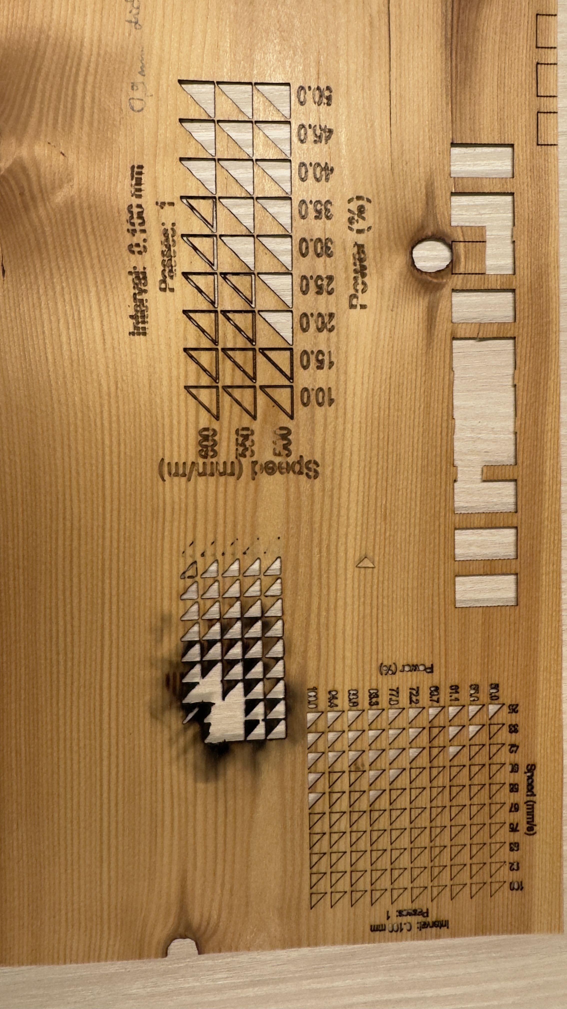

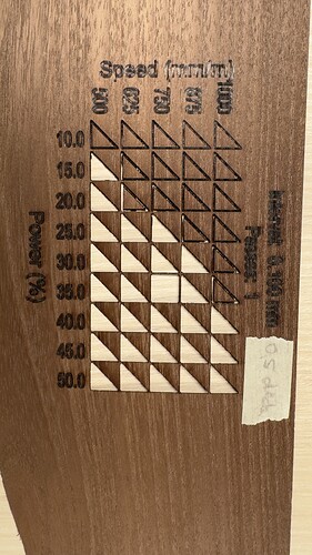

tried it, still cuts a triangle
That’s unfortunate but worth a shot.
I think what’s happening is that somehow the controller is combining these two lines into a single G1. So instead of 2 discrete movements there’s a single diagonal movement.

From everything I’ve seen this is not a comms problems. It’s a g-code interpretation problem.
I’ve paired down the earlier g-code example. Could someone test this to see that it triggers the triangle? Run from Laser window “Run gcode” or even better through XCS if that’s an option. It may be possible to further pair it down but not clear exactly what’s triggering the bug.
Note that the burn will start from position 30,30. It runs at 5% power.
