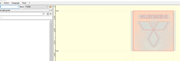

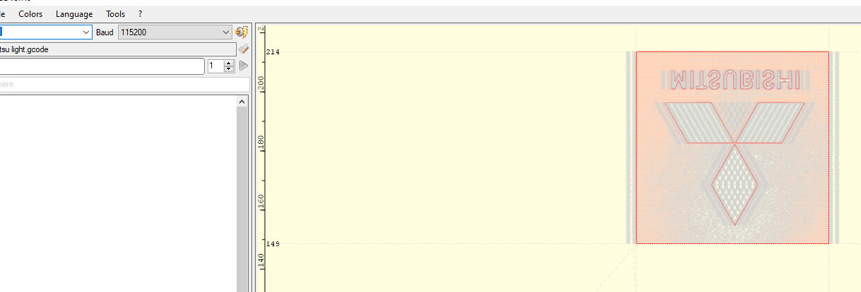

my suspecious is the xtool gcode interpreter is trimming a bit of the bottom of Gcode
The lightburn Xcode.
mitsu light.txt (1.1 MB)
the xtools Xcode.

when reimporting the gcode to lightburn or lasergrbl it seems perfectly correct and valid

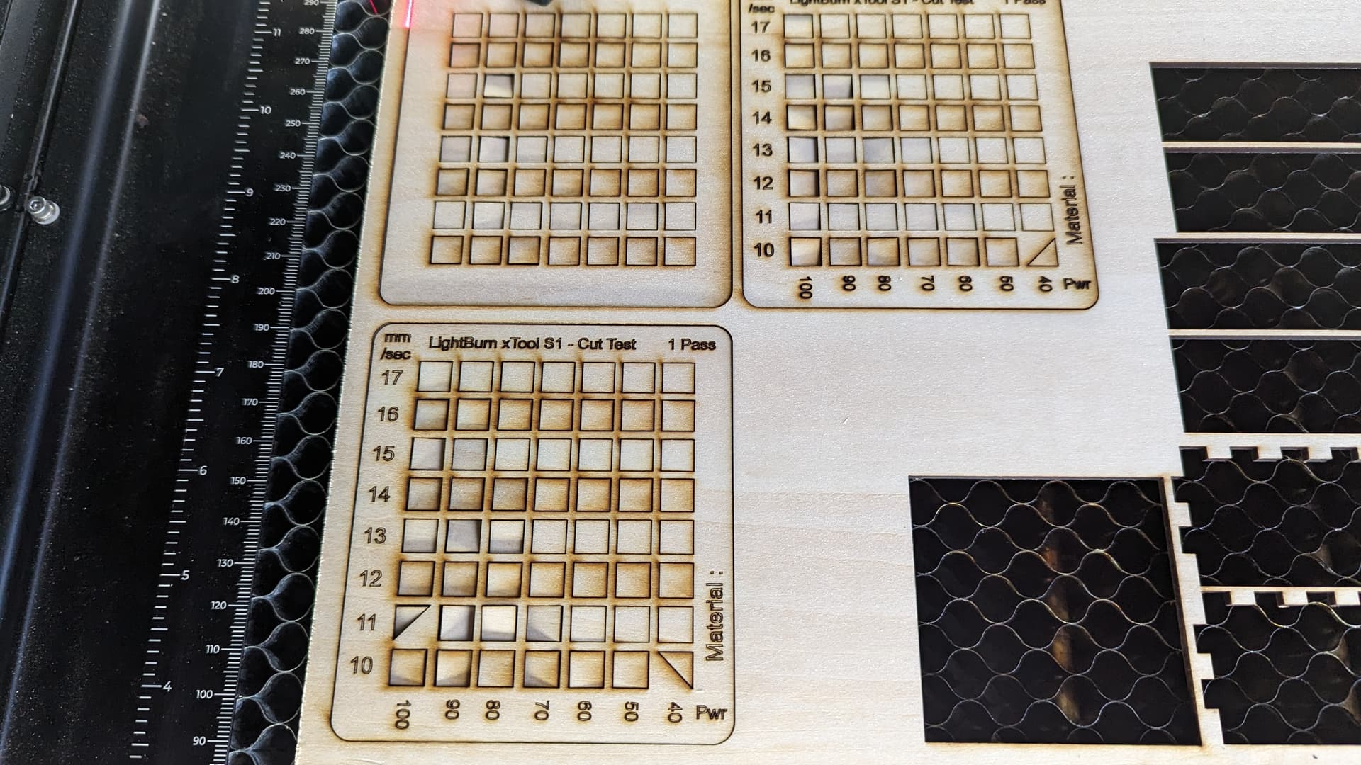

Hi, I don’t know if this will help at all but I’ve been experimenting with this problem.
I have created my own test cut. All layer modes are Line. Layer 00 is an engrave layer containing text. Layer 20 is the final perimeter cut. All other layers are the squares for the test.
Here’s the interesting thing: Wherever you position layer 00 (the text engrave), the triangle error ONLY occurs after it.
In the image attached, top left cut is without layer 00 output.
Top right cut is with layer 00 positioned after layer 15
Bottom left cut is with layer 00 positioned after layer 14
So it seems something within layer 00 triggers this error.
I hope this may be of use to you!
Attached image and gcode.
