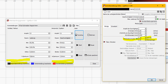

Hallo zusammen hatte auch das Problem und konnte es einfach lösen.
bei den Einstellungen:
Hello everyone, I also had this problem and was able to solve it easily.
in the settings:
Habe das ganze angepasst und es geht.
I have adjusted the whole thing and it works.

Interesting idea of using perforation mode with skip sections smaller than your kerf to basically introduce additional points. It’s not an ideal solution but may work as a workaround in a pinch.
