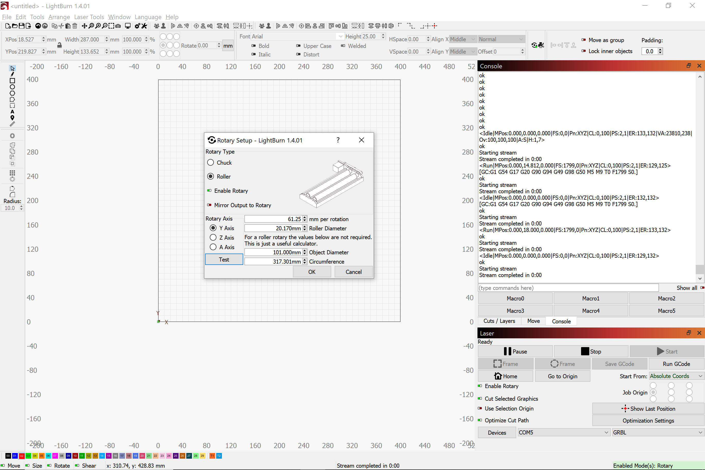

I went by the Setup Ortur YRR pdf document and when I got to Test for the YRR to spin the tumbler 360 degrees it didn’t do anything. Here is a screen shot of what it looks like. Please let me know your thoughts.
I got some movement a bit ago but don’t know exactly what I did. Then get this…
ok
Starting stream
ALARM:2
G-code motion target exceeds machine travel. Machine position safely retained. Alarm may be unlocked. (Right-click the ‘Devices’ button to reset the connection)
On or near line 2:
Stream completed in 0:00
[MSG:Reset to continue]
ok
Ortur Laser Master 2 Pro S2 Ready!
OLF:OLF 191.
OLH:OLM_ESP_PRO_V1.2.
OLM:GENERAL.
[MSG:Warning: Flame Sensor Disabled by User OverRide]
[MSG:Flame detector active,Ambient infrared value:77]
Grbl 1.1f [‘$’ for help]
[MSG:‘$H’|‘$X’ to unlock]
[MSG:Caution: Unlocked]
ok
Well I installed 1.4.01 Lightburn and decided to delete my rotary-settings.lbset file. Then recreate the same and I am now engraving on my rotary very nicely. I don’t know what was in the file but the new one words.
