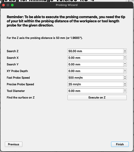

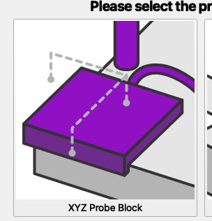

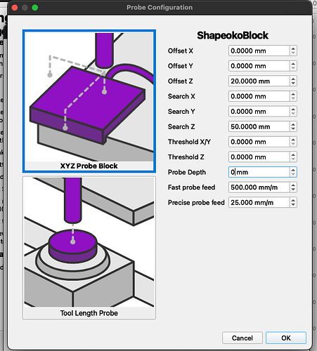

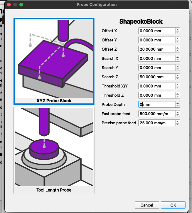

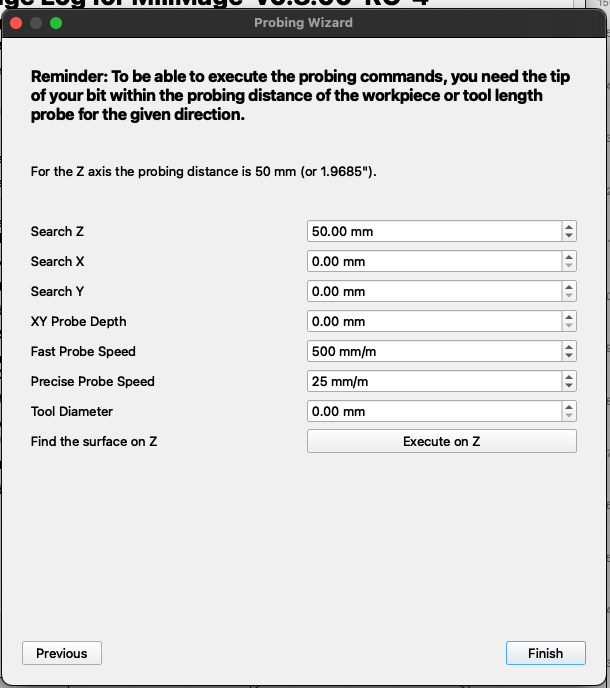

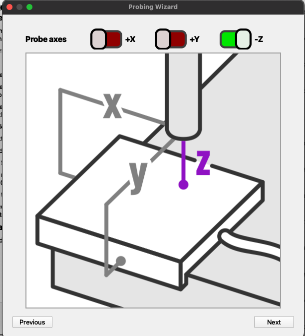

I’ve been using Lightburn with my laser for about 9 months so I’ve figured out just about everything with MillMage but the Z Axis probing. I recently picked up a FoxAlien Masuter3. I built a CNC Plasma cutter so I have limited Z axis knowledge. I’m running 0.8.00 RC-4 but I have issues with 2 things. When I jog and home, everything moves as expected. However when I try to probe for tool length, my Z axis moves up, hits the stop switch, and stops. I’ve tried lowering the Z axis to give it some more travel space before I started probing but the same result. When using Openbuilds or Easel probing works as expected. Z moves in the negative direction until it hits the probe block then parks where I would expect it to.
Also, I can’t find where to set the height of the probe block. I tried to post a pic of the Tool Length Probe Configuration but it just shows a link so if the pic doesn’t post, here are the values I can input. All I see is Position X (20 mm), Position Y (20 mm, Search Z (100 mm), Fast Probe Feed (600 mm/m), and Precise probe feed (30 mm/m). Same options are available regardless if I enter through Wizard or Setting. How do you set the height of your probe block?
