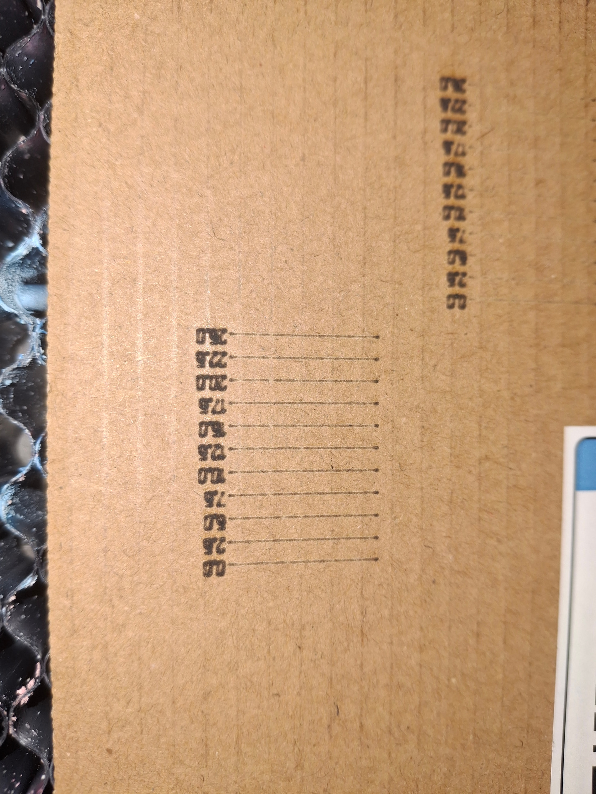

I was in at the end of engraving 7 plastic labels, each with small changes in speed / power / interval settings to find the best setting. The last label was disaster, the text was fuzzy & the cut line was 1mm thick. B

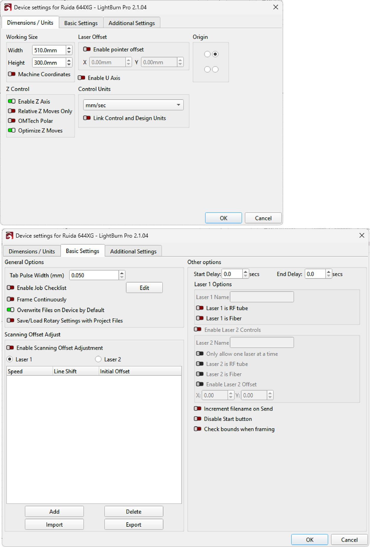

For LightBurn, I’d also go back to the Ruida 644xg device profile rather than 6640_Y-Cloud. The Gweike setup should have Enable Z and Optimize Z Moves enabled, with Relative Z Moves disabled:
https://forum.lightburnsoftware.com/t/how-to-use-gweike-cloud-with-lightburn-tips-tricks-faq/97874

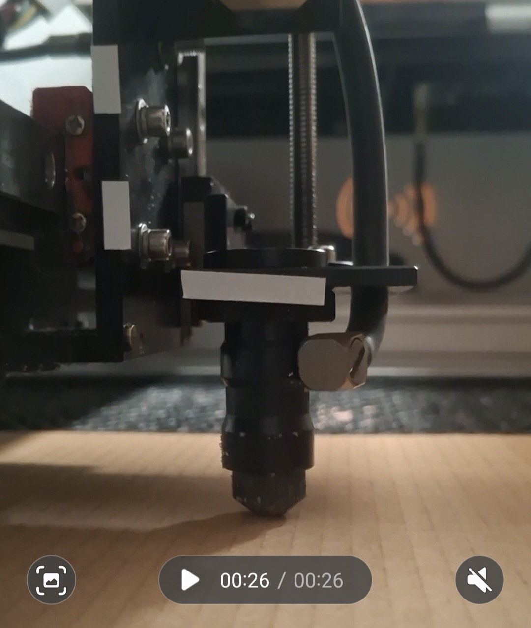

Ok, I disconnected USB, powered laser off & on.
On start up, the head crashed (photo) & I turned the laser off to stop the head dragging on the honeycomb.
I’m thinking it’s a hardware or firmware issue as the head will not find Z home. If the head is low on power on, it might crash, if it’s too high, the step motor sounds like it struggling to adjust on startup.

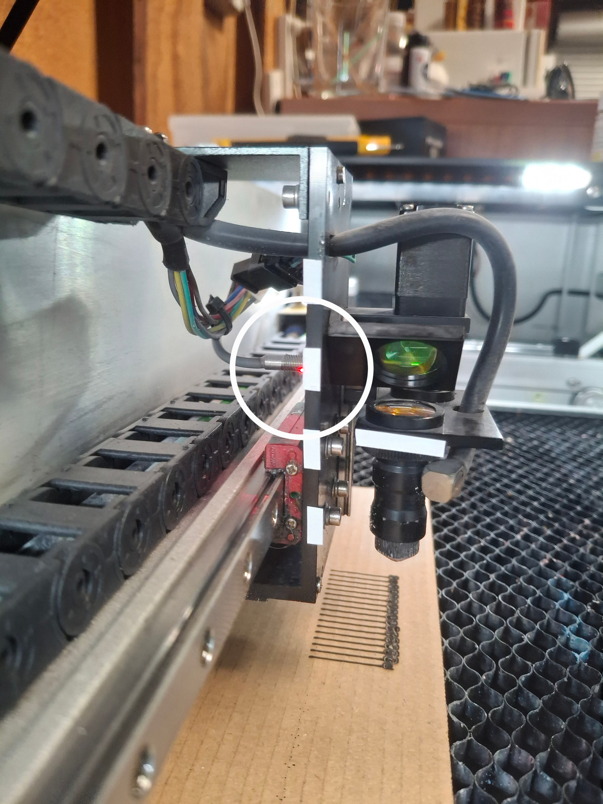

In Lightburn I did several Focus Tests (photo), they all look the same & the head looks like it’s staying at the same height, but on the last test the head moved up & the red LED came on (photo). I don’t know what the red LED means.
