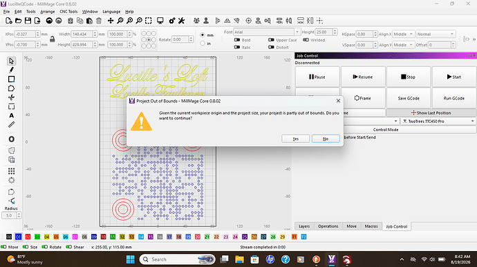

After setting the workpiece zero point to the center, framing the work is to the bottom left of the zero point, half on/off the workpiece. Using TwoTrees TTC450 pro
The zero point is normally at the front left corner of the material. Can you upload your .mage file so we can see what you are trying to do?
After tinkering with it, I now discovered that it’s the framing that’s off to the side but the project does execute properly if I disregard the popup warnings

Yes, running 0.8.02. Popup warnings about being out of bounds but the project runs perfectly
Yes, running 0.8.02. Popup warnings about being out of bounds but the project runs perfectly. I was using Dollar Tree bamboo boards to practice on when it happened, but when it executed properly, I swapped and resized the project to a larger, better board. THEN it framed and cut properly. Starting to think my machine is screwing with me for fun…

when i opened their file i got out of bounds warning also.. but object well in bounds ,but control mode looks ok this is one for the developers to look into @MikeyH you would know who best to tag in this one

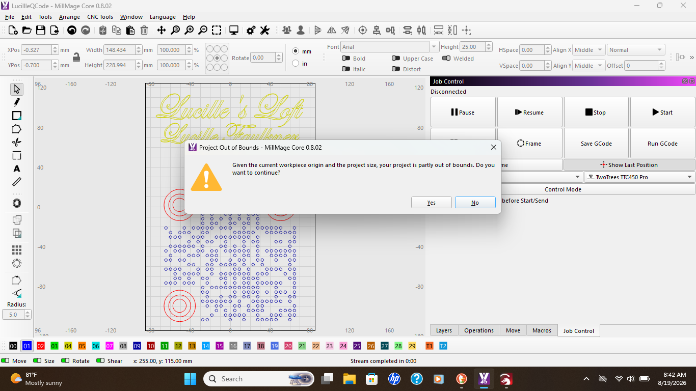

Can you screen capture (SHFT+WinKey+S) this for us? I am wondering if it is X/Y or just Z giving the message.
LucillleQCode.mage (360.6 KB)
When I moved the Origin (green square) to the front left using the Project Setup Edit window, the popup window went away. If you get an Alarm 2 in the Console window, review all youe coordinate related settings.
