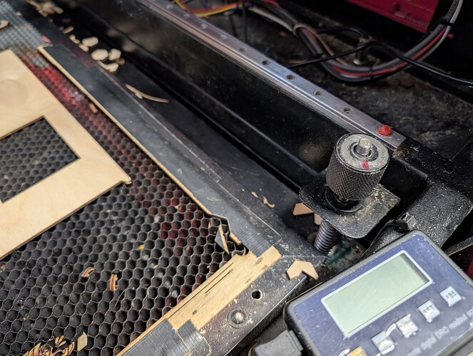

A different Z-axis motor ("final MOD")
The black and red laser didn’t come with a Z-axis motor. To upgrade, I would have likely needed a longer belt, pulleys, etc.
Instead, I just replaced the manual knob with a stepper and added a driver.
Also added a Z home switch. Playing with how to best use that as well.

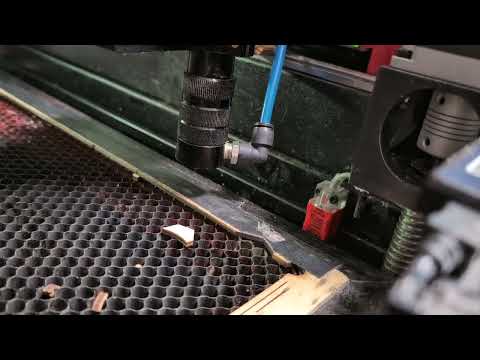

@Chuckphd this is how I did the Z homing.
I’m going to move the prox sensor a bit higher to support an engraving lens.

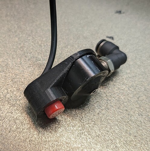

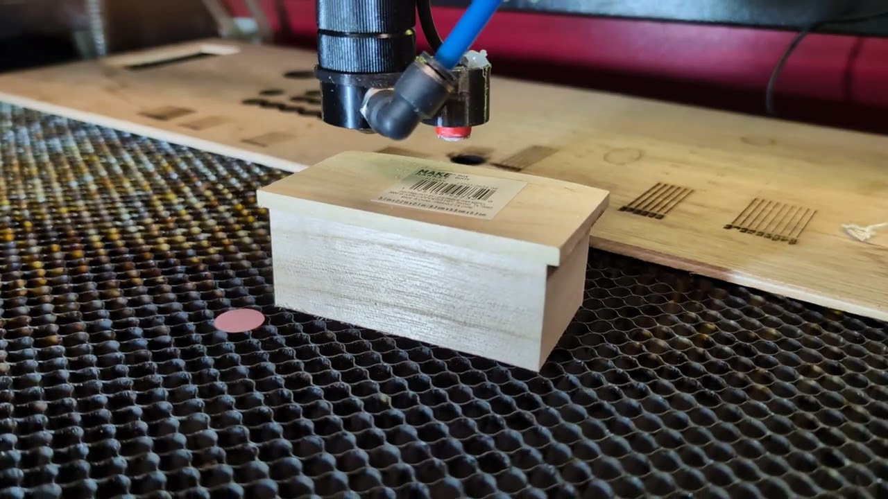

I made a slight change to implementation. Same design. I set the Z-axis home to mechanical origin.
I’m going to build a 38/50/63mm focus offset block to change where the Z homes to. Part of it, to be figured out, is some kind of mechanism to default/reset back to the longest focal length to avoid head crash. Some kind of “you have to hold it in the not-63mm position” spring loaded to return.
Definitely the way I’d go about it! Congrats.
“Variation 3” and part of what I noted to @Chuckphd .
Essentially a plunger switch right at the nozzle. Wired in parallel with the home/limit switch. Regardless of nozzle extension, focus offset, or material height, the limit will hit if the nozzle is too close to the surface.
I need to fine-tune the safety/offset distance (temporarily hot-glued a washer), but… Mission accomplished. Both nozzle and home/focus work.
