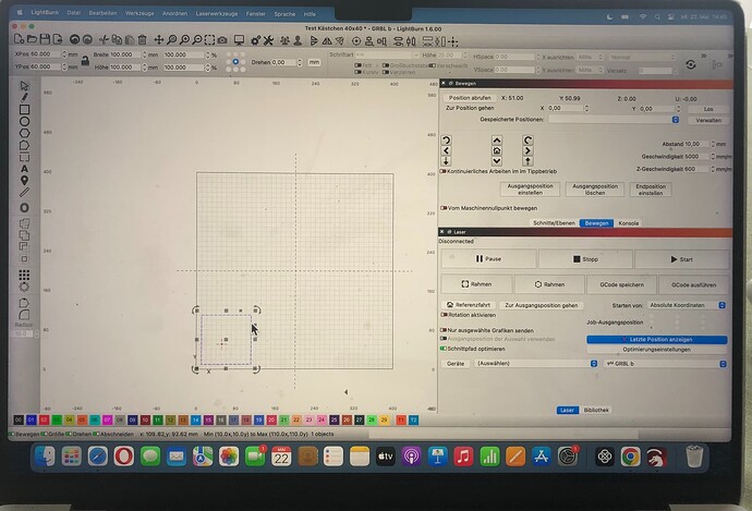

Hi, to even better illustrate, what I meant above is shown in below fotos: in lightburn I have a 100x100 mm box , after lazer it was 63x67 mm ( x Y )
Thank you for the photos, it would appear that you need to calibrate your axis! Here’s how:
Before calibrating your axis, double check that you haven’t accidentally altered your x/y/z steps. 80-100 is the expected range. What does your laser report for $100 $101 $102 if you type $$ in your console?

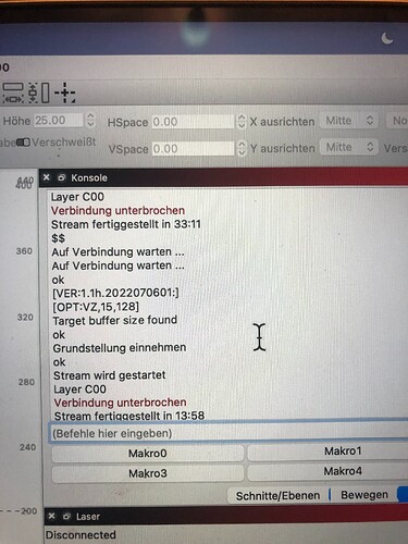

3) I have a further issue, hopefully the last, : the lazer stopped after approx 30 min, while just 1/3 of the job was done ( see photo ), the console said that the connection was interrupted, but I did not touch the lazer or labtop… what shall I do.

Hi, As complementary information to above I like to add that I restarted the job at 33:11 min at the "tv screen - prediction ) where I could tick the box under “start from here”.
  1. the job did not start at just the last point
  2. the job stopped after 13 min
see the photos.

  2. When you typed $$ into your console window, you typed it after the connection had been interrupted, so that is that you did not receive a response. You will have to make sure LightBurn is connected to your laser when sending commands through the console. Feel free to share the data from your $$ query.
  3. There are many reasons why a laser could become disconnected from the computer. First, make sure that your computer isn’t allowed to go into idle or sleep mode, that is the likely culprit.
  4. Thank you for providing a photo of your job after using the ‘start from here’ option. It appears that your laser may have lost its position, as you can see on the left shoulder, it isn’t lasering in the same rectangular space. Next time you decide to do this, you can also try reversing the scan angle like in this video: https://youtu.be/WmOGoHiYQu4?feature=shared&t=83

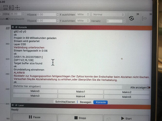

  2. Now there is something additional and strange: after job start the lazer is a bit vibrating, continues and vibrates again, after it stopped quickly.
    Console Info see photo

Please type $$ into your console, while the laser is connected, and paste what it copies to your clipboard in a reply back.
Vibrating is not good and points to a loose or broken cable. Can you tell where the vibrating is coming from? I would inspect the cables for whichever motor it may be.

  1. I types $$ ( see photo )
  2. I bought a cable 2.0 high quality and a usb hub ( see photos )
  3. I checked loose cables , none
    The whole frame with the motor is vibrating soon after start, just for seconds, vibration stopps and after it restarts again , after the lazer stopps and goes to startposition.
    The vibration is nes since I wrote it to you, never before…
