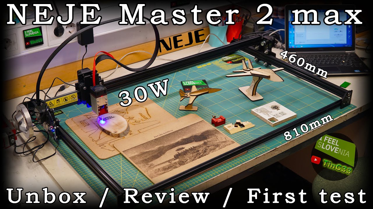

I’ve checked some video on YouTube finding out one of a guy from Slovenia, thinking that he was right I’ve changed the machine settings but I find out that some of that settings was wrong for me so I re change that settings and now the machine is not failing at positioning.

check this out, it’s quite clear!
Only PLEASE DON’T change any machine settings as he do!
