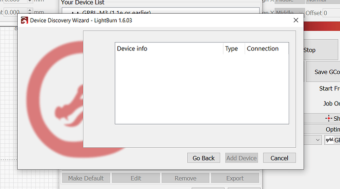

the grbl-m3 is the only option availible to this machine i guess, should I uodate drivers?
What do you mean by this? Are you saying no other device profile options show for you when you attempt to edit the device profile? If so, can you take a screenshot of what you’re seeing?
No. This is unrelated to the driver that is used to communicate to the controller. The configuration I’m referring to is on the LightBurn side and determines the device type associated with your laser.
Fox alien is not in there, should I just choose gble?
Please follow my instructions from my earlier post. Select your device named "GRBL-M3 (1.1e or earlier), then click Edit. Then change the device type used to GRBL.

Tried multiple test this morning, After updating the GRBL my Macros are gone, and my laser is not cutting. any idea what the baud rate is for a 20W laser?
Changing the device type should not have changed anything with the device itself. Did you create a new device or modify the one in place?
Baud rate is not related to the laser module. It’s a function of how the computer and controller communicate. If you are able to communicate with the device the baud rate is fine.
When you say not cutting, are you saying the laser is not firing at all? Or it’s not cutting all the way through when it used to?
I suspect the root cause is due to this value in your GRBL configuration:
This is a highly unusual value. Do you use your machine also for CNC function? In any case you have two ways to resolve this:
- Change the
S Value Maxsetting from 1000 to 60000 in Edit->Device Settings - Change the value of $30 to 1000 to match
S Value Max.
If the 60000 value is deliberate then I’d suggest following the first method. If not deliberate then I’d suggest changing $30 to 1000 as that’s a very typical value and will be more inline with others.
If you want to do the latter then enter in Console:
$30=1000
